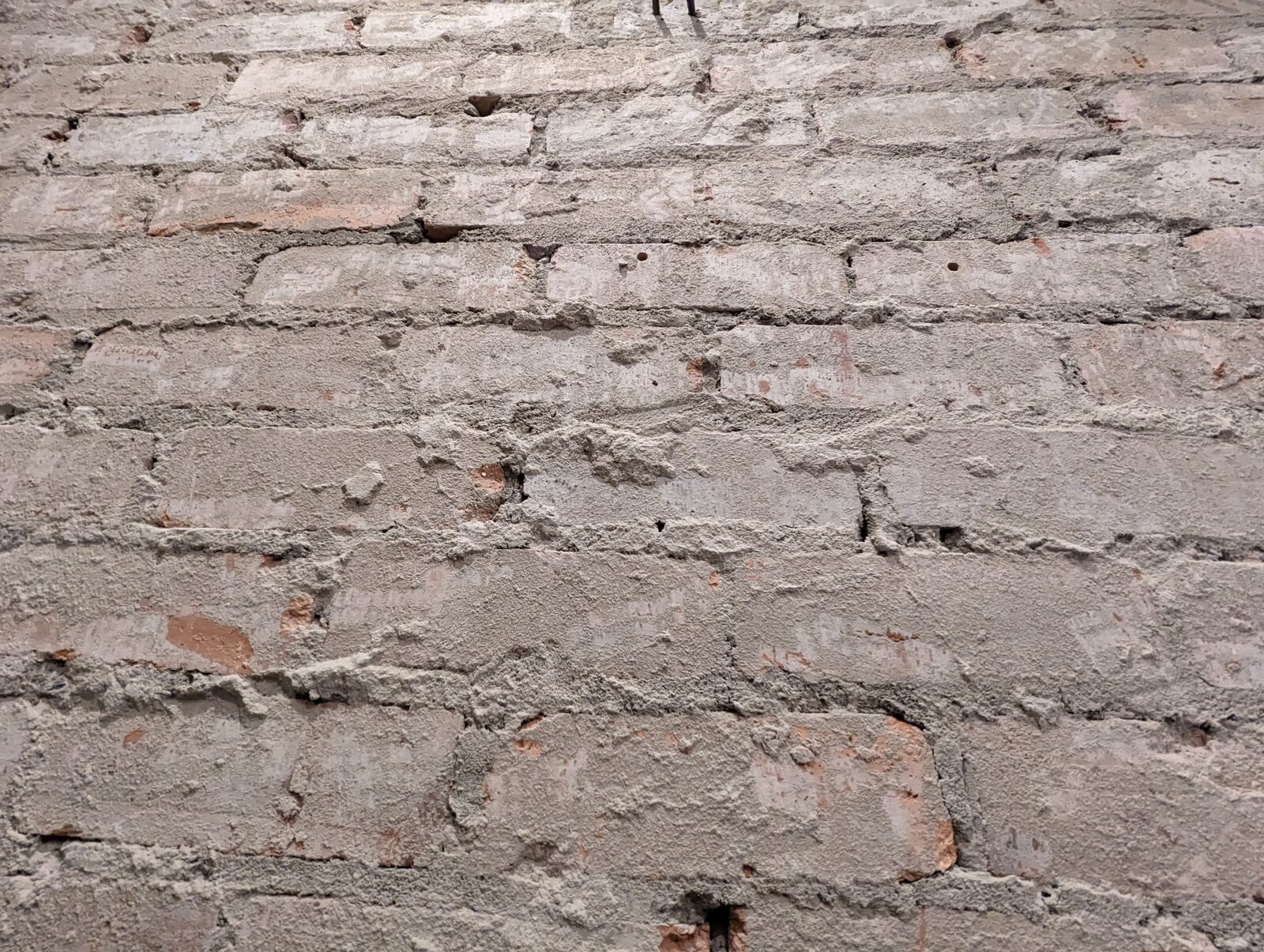

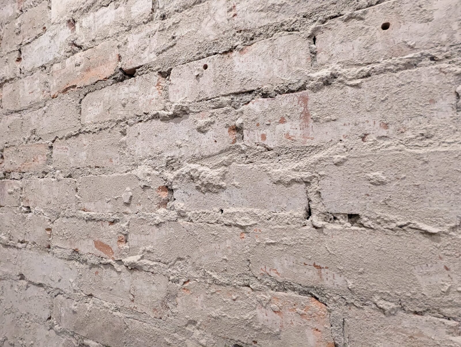

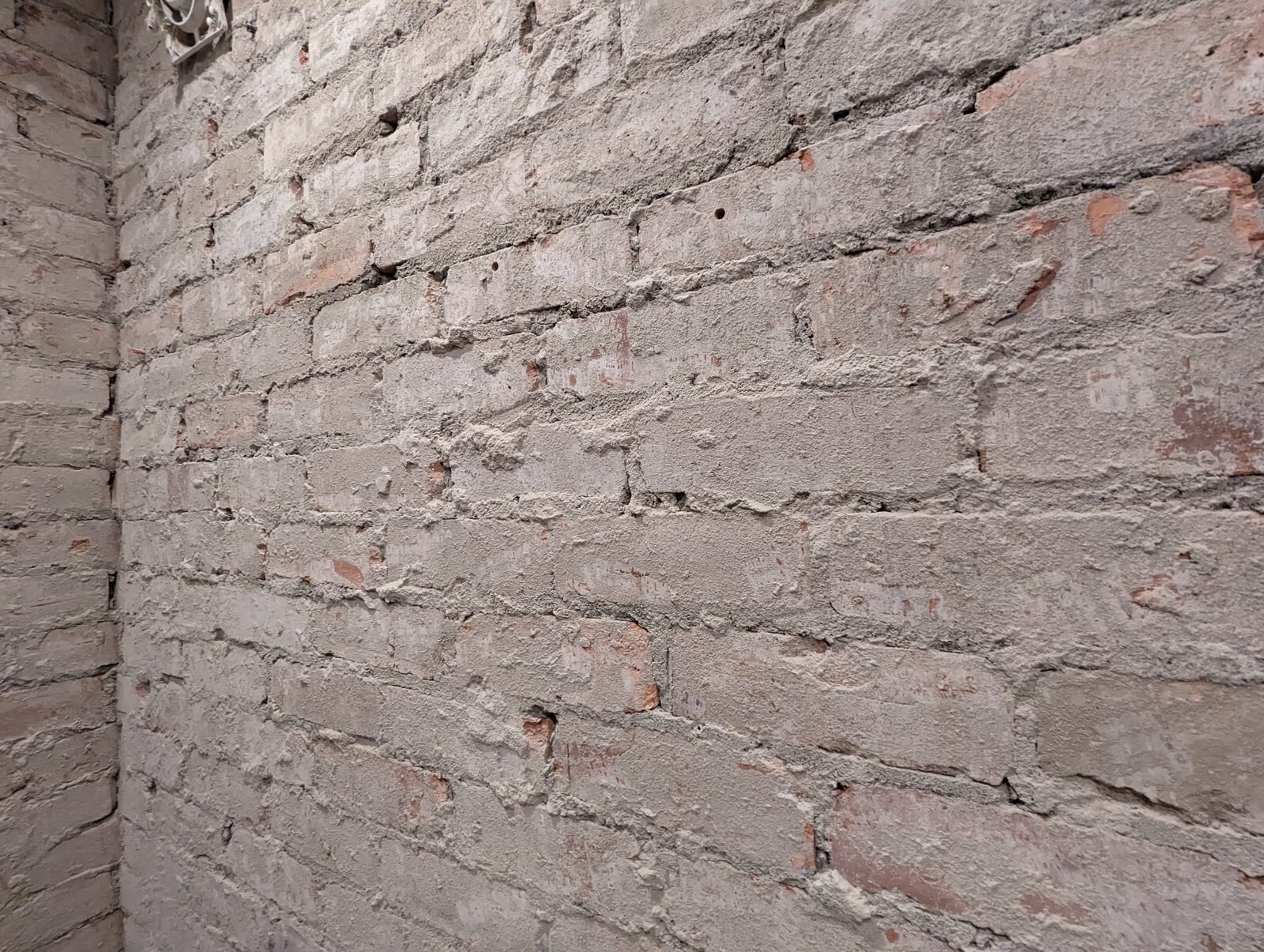

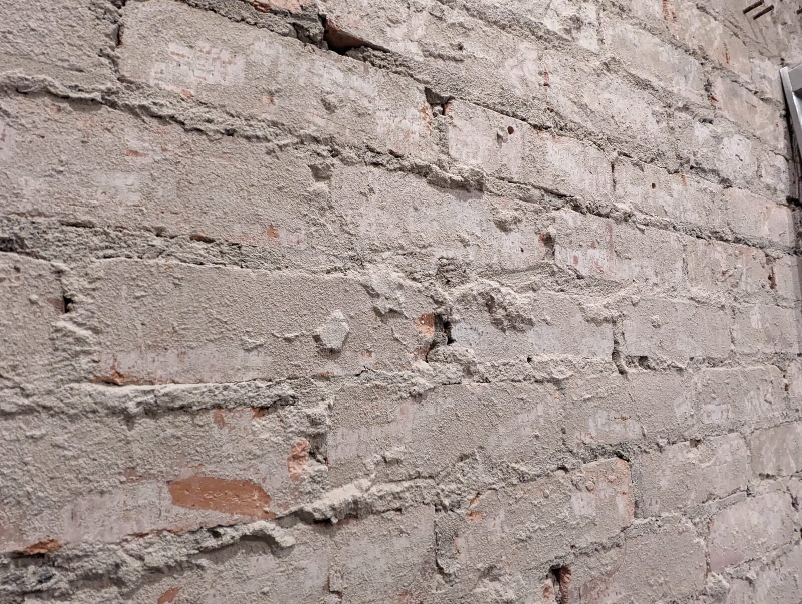

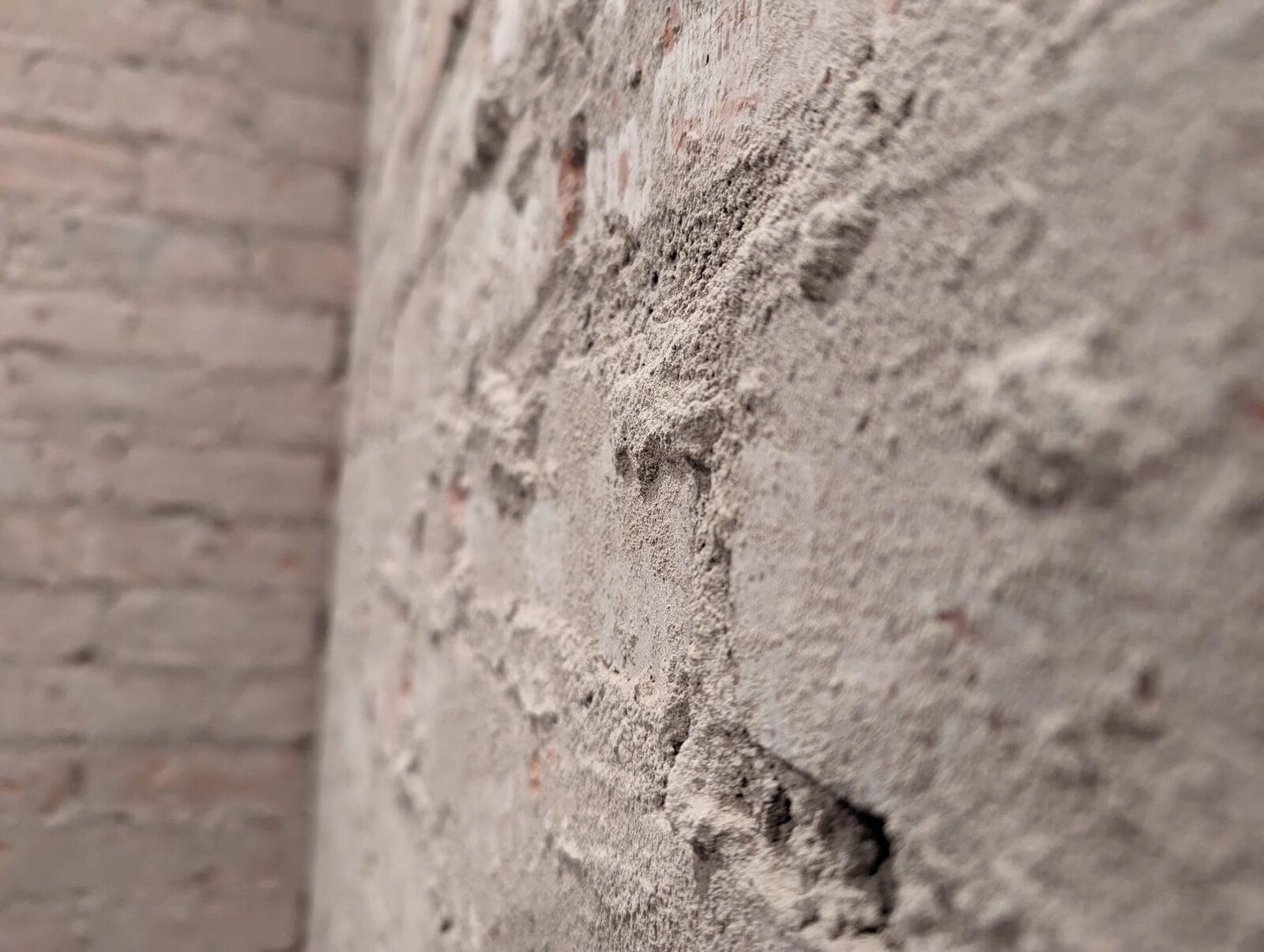

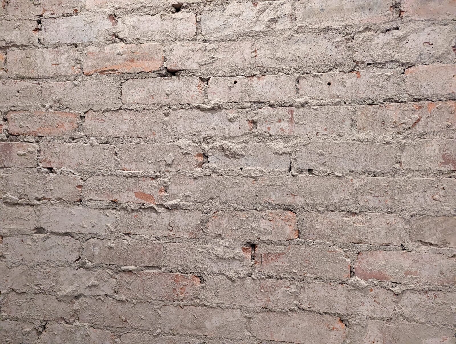

Further question; The wall that is back to brick will have 6mm cement boards attaching with adhesive and screws. Looking at these pictures, would you say the walls are ready, or do I need to spend more time chipping off the old render to make it flatter?
