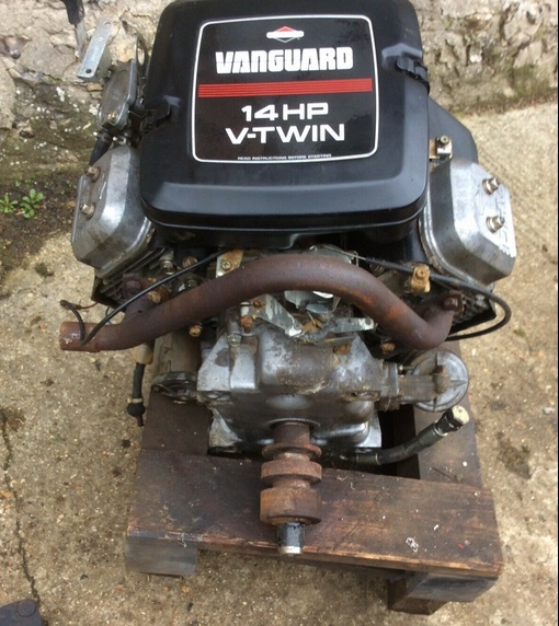

Thanks John,
I have seen this one on ebay that apparently works well. I am assuming that this particular engine is supposed to be bolted on the way up it is shown here in first photo. Also I notice that the spindle has some sort of collar on it , do you think that could be hard to get off as I need to put a pulley on? Do you know if it has a key on the spindle for a pulley/
Cheers
Sure, that pulley is keyed on to the engine crankshaft which is parallel.....no tapers here!
It will need a good soaking in WD40 or whatever and maybe a puller to remove it, but there are a couple of crankshaft lengths and diameters to consider if you want to use the original pulley - which is a good move.
Obviously there is no exhaust silencer visible which could be an issue, and these engines usually have their own fuel pump operated by crankcase pulse pressure...its visible just above the left cylinder and they are reliable.
Great engines, these with a full flow oil filter which promotes long life. They are magneto start but have coils and a voltage regulator to charge the battery.
John :)
