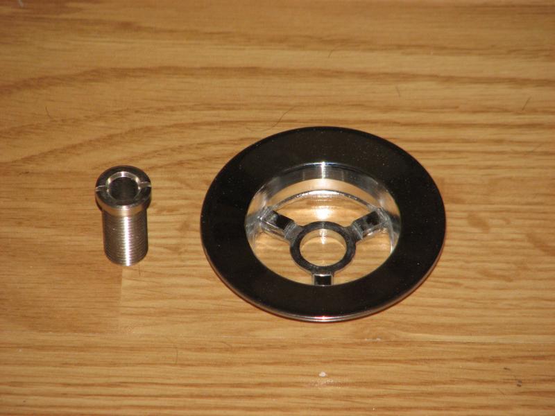

Hi,
Some bath wastes have a big nut that you turn and tighten underneath the bath, and some bath wastes have a big screw that you turn and tighten above the bath.
Mine is the big screw variety. Here is the screw.
Here is the screw next to the waste
In an ideal world I would be able to go into a tool shop and buy a 16mm (5/8 inch) slotted screw driver and do a proper job. However this isn't an ideal world because 16mm (5/8 inch) slotted screw drivers don't appear to exist.
The only idea I've had, is to use a one penny piece (2p's and 5p's are too fat).
So how do you fellas tighten these things up?
PS. I know I need to use a bead of silicone or plumbers mate between the bath and the waste. I just want to keep this topic related to techniques for tightening big screws with tools that don't appear to exist.
Thanks in advance.
I use a chisel. But usually just a decent sized flat head in just one of the slots as it won't reach all the way across will still get enough turning force to tighten it.
A 4 way utility/cabinet key like this?
http://www.ebay.co.uk/itm/400504869017
Just measured mine and it's approx 14mm across and the tabs/fins are 2mm thick. The shaft is 9mm diameter. They might fit.
Gaz :)

The prize for best out of the box thinking so far so goes to rsgaz :)
They sell them in Toolstation as well.
http://www.toolstation.com/shop/Hand+Tools/d10/Plumbers+Tools/sd210/Service+Cabinet+Key+/p18822
I will get one and report back if it's a goer or not.
I still find it hard to believe that components like this can be manufactured without any thought whatsoever of how the things are suppossed to be tightened up correctly here in the real world. :confused:
I read on another forum, that somebody resorted to using an old dinner eating knife which he cut the end off (with an angle grinder) where it was 16mm wide. :D

I took my bath waste screw into Toolstation today and tried one of those 4 way cabinet keys on it.
Sadly it was no good. The round bit is too big to fit inside the hole on the screw and the 2 flat bits were also too thick it fit into the groves on the screw. :(
So I will probably go down the penny washer and grips route. :unsure:
I've always just used a large slotted screwdriver. The big one I use for brass WC screws.
I don't think rsGaz's cabinet key will fit most gratings, just too big!!
