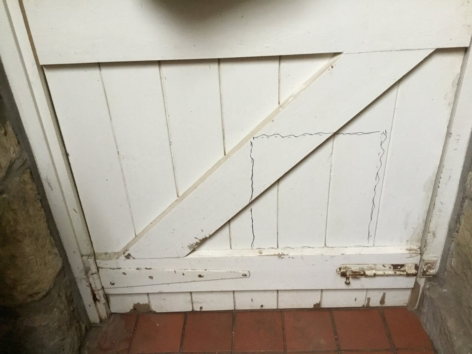

This would involve cutting through the lower brace entirely...so what could I do to reinforce the door? Just fit two vertical pieces of wood between the lower and central ledge on either side of the opening? Will that be enough to stop the door falling apart?

That's about all you can do.
Although if making a hole large enough for a dog, you might as well just leave the door open permanently and not bother with the dog flap.
I'd fit one or two sub-braces (shorter diagonals) around the flap, or failing that another middle ledge/rail with at least two widely spaced screws per batten.
Thanks. Looking at the dog-flap we've just bought to fit in another door, there'll not be much room for an extra middle rail between the existing and the top of the dog-flap, nor any space for two extra diagonals.
I'm aware that a single brace is meant to take the strain of the top of the door and transfer it to the bottom hinge: I'm just hoping that a door with a mid-rail and two diagonal braces will be strong enough to have the bottom brace severely compromised. But maybe not: otherwise why was it built like that...
But yes, extra screws wherever I can, to stop any possible slippage of the boards.
Can you fit another brace across the very bottom of the door. Can you post a picture showing where you want the flap to go.
In preparing to take the photo, I realised that if the flap wasn't placed in the centre of the door, as I'd originally envisaged, it might be possible to avoid cutting through the whole of the brace. I guess the nearer I take it to the edge of the door, then there would be room to reinforce the brace to some extent?

Many ways to do it, I think. I might even be inclined to replace the lower brace with a snug fitting sheet of ply over the width of the door. This would allow the dog flap to fit flat against the door, would support weakening/splintering of those (t&g?) battens, and do the job of the brace. The sheet would be short of the full width by a couple of inches both sides for clearance.
Or you could mebbe just remove the brace entirely and fit more screws in the rails.

The lower diagonal brace isn't a necessity unless the door gets banged a lot, but you won't be able to fit the dog flap half on and half off the brace. Bodgers 1st suggestion is a good one.

... you won't be able to fit the dog flap half on and half off the brace.
True, but I was thinking of building up the other edges of the door flap with wood of the same thickness as the brace, so it would be possible to have the flap half on and half off the brace. And also maybe widen the brace with an extra but of wood on the left hand side. (Tricky, perhaps, since the brace is nicely bevelled)
Another alternative is to fit a smaller dog flap than that marked out in the photo.

As long as you are competent to remove, and then move the brace and ledge, then you can cut the dog flap where you want. At the end of the day, it's just a wooden door, and can be painted to cover up any issues.
