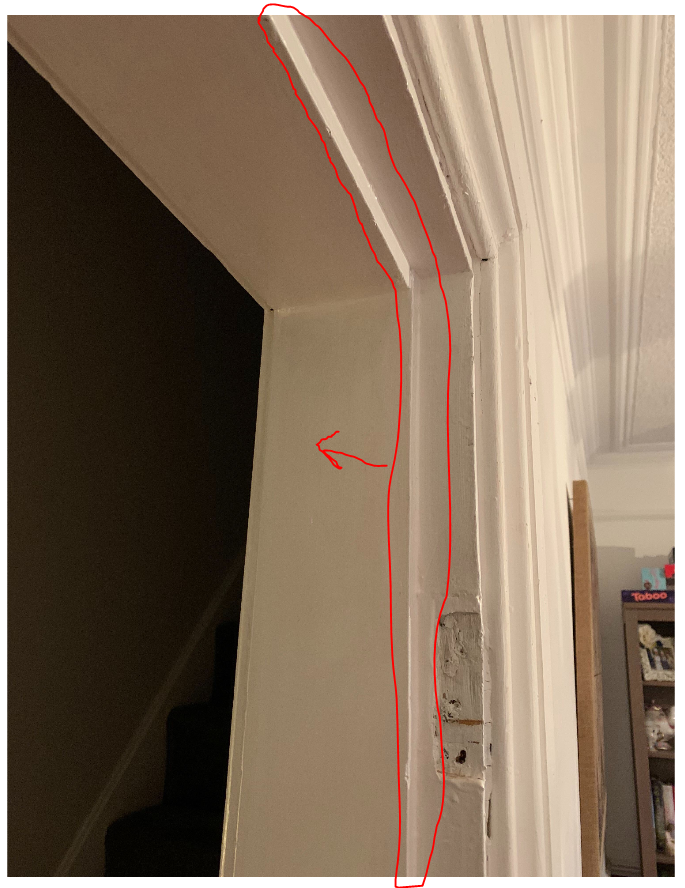

Are there any tools / techniques for fitting an FD30 fire door into an existing door frame without needing to replace the frame? I've considered using something like a dremel / wood chisel to cut this back to fit the extra width of the fire door.
Jtbrown, good evening.
It appears that your door is situated within a Georgian / Victorian property??
If so then that door stop will be a [so called] planted door stop, meaning that the door stop that you need to reduce inwidth has bee nailed on to the door frame?
Can I suggest you very, very carefully using a sharp wood chisel very, very gently prize off the door stop, you can then cut to the width you need.
Can I also suggest that you cut the paint between the door stop and the door frame using a new sharp Stanley knife.
I think that your idea of a Dremel could be very difficult to control and get a true straight line which you will find acceptable??
Ken.

Thanks Ken, I'll check that out. It is a Victorian property (built in 1903)
New frame will be a lot easier and comply with regulations.
Fitting a fire door in existing frame will never work unfortunately.

How thick are the original doors?
It's quite hard to groove a frame in situ. Easier to groove out the door edge after fitting it. lift-off hinges are a great boon.
We're talking highly skilled joinery here.
To adapt that frame and archives with 20 layers of paint on them, to a new fire door of "similar" size will take some skills and might be impossible.

Rise and fall hinges/lift off not permitted on fire doors. See 5th page, 'Additional requirements for hinges intended for use on fire doors.'
https://www.firesafe.org.uk/wp-content/uploads/docs/guide1935.pdf

John, obviously the rise and fall I first thought of are the ones that have a curved shoulder which raise the door as you open it.
The link I posted does give information about suitable hinges for fire doors, (class, grade, etc), but on the fifth page down there is a section titled Table 1 Classification Summary which has the following statement;
"It shall not be possible to remove the hinge pin or separate the hinge element of the door assembly without the use of special tools."
yes, I saw that, but what is the source for that statement?

Yeah that’s correct it’s to pass building regs for a loft conversion. Having to install fire doors throughout the house.
I’d like to avoid replacing all of the frames but it might be a more sensible option!
No, trust me it's a lot easier to fit new frames and new doors.
It's a once in a lifetime expense.
