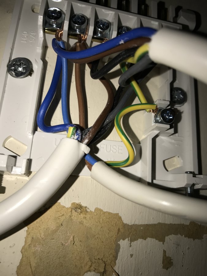

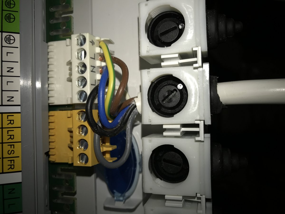

Right so the boiler is a Greenstar 30i ErP Condensing Combi Boiler.
Also it says in the manual that it's supply is 230V - 50Hz.
Let me know what other pictures you need.

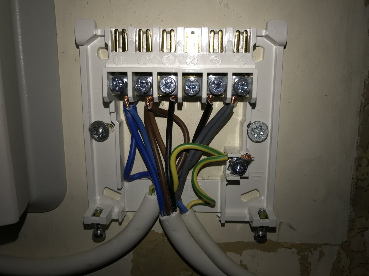

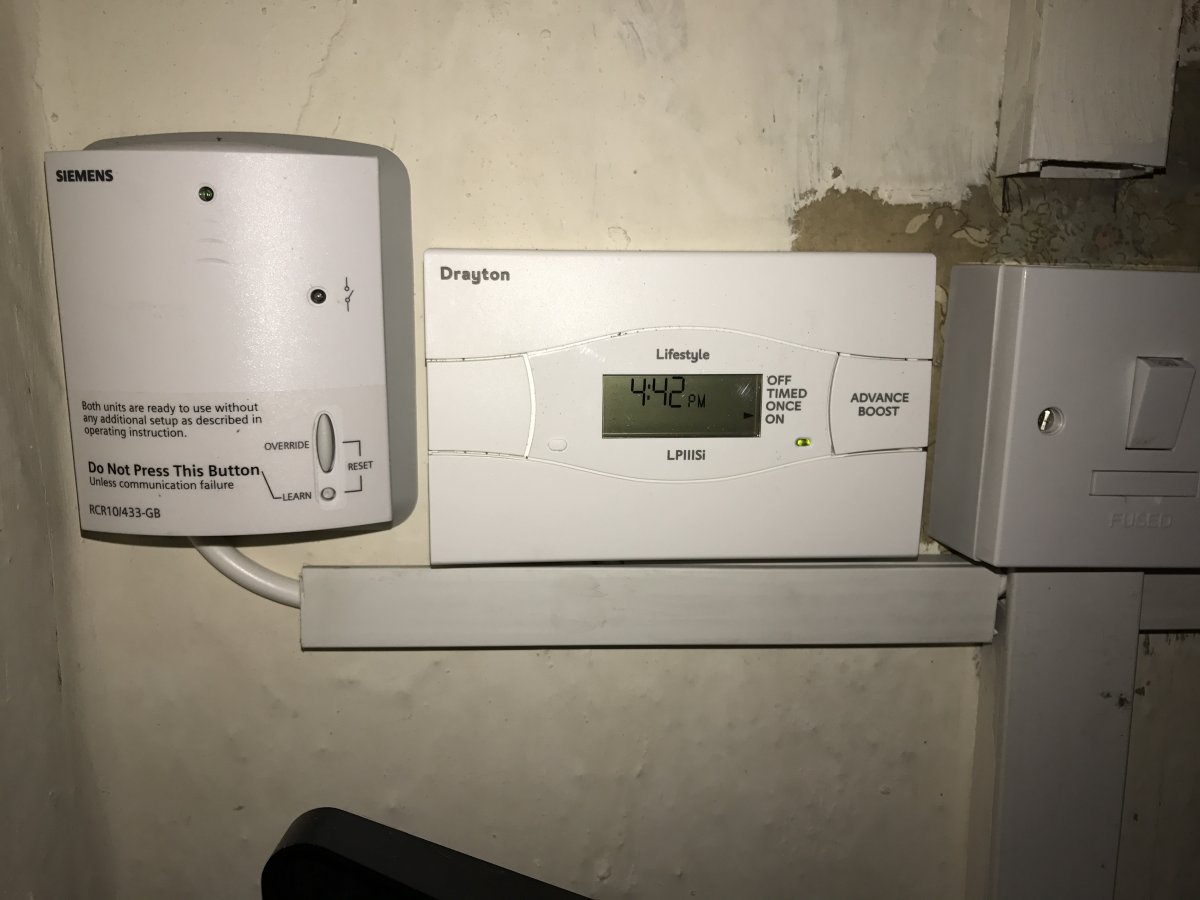

Just some additional information. Is the Siemens thermostat receiver wired up as follows:
Grey to programmer terminal 4
Black to programmer terminal 3
Brown to programmer Live
Blue to programmer Neutral
The black wire leaving terminal 1 of the programmer should go to the boiler. At the boiler is it connected to a terminal marked 'L 230v out' or 'LR'?
The black wire leaving terminal 3 of the programmer should go to the boiler. At the boiler is it connected to a terminal marked 'L 230v out' or 'LR'?
Ok so I mapped them all out below as best I can.
Seimens box:
N - blue
L - brown
1 -
2 -
3 - black
4 - grey
Drayton Timeswitch:
Boiler wire 1:
N - blue
L - brown
1 - black
2 -
3 -
4 - grey
Earth - green yellow
Boiler wire 2:
N - blue
L - brown
1 -
2 -
3 -
4 -
Inside boiler:
Black wire - L (230V Out)
White wire - L (230V Out to LR hot water symbol)
Grey wire - LR heating symbol
Yellow green wire - Earth
Brown wire - L 230V In
Blue wire - N 230V In

First of all remove the Siemens receiver wires from the programmer.
Then with the wires that are left:
The wires in N at the existing Programmer goes to N at the Hive
The wires in L at the existing Programmer goes to L at the Hive
The main supply to the boiler remains as it is:
'Grey wire - LR heating symbol' from the boiler goes to 'Heating on' terminal 4 at the Hive.
The "Black wire - L (230V Out)" from the boiler is not needed anymore as the Hive is linked to a 230V supply internally, so this can be removed. [Don't leave this floating because it is connected to 230V at the boiler end]
I'm not sure about the boilers "White wire - L (230V Out to LR hot water symbol)" I can't see it properly in your boiler wiring photo and I can't see where it comes from. I believe that this is a pre-heat function for the hot water, and if so, you could possibly use the Hive hot water program for this and connect it to 'Hot water on' from terminal 3 at the Hive. Alternatively, it may already be linked to a live somewhere, if so you can leave it as it is.
