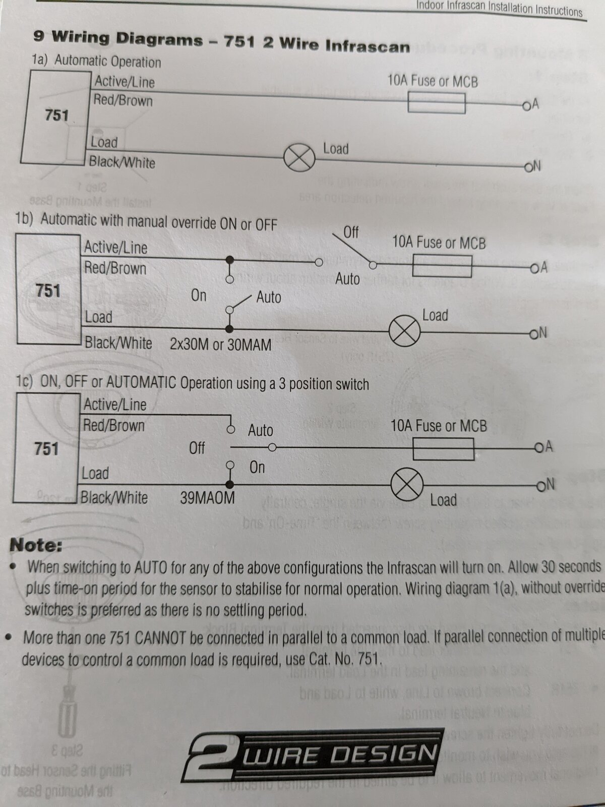

I have a Clipsal 751 series 2 wire PIR. The wiring diagram is below...
But I am unsure on whether I can wire it with the existing 2 red wire one-way setup?
Any suggestions. Thanks in advance.

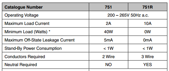

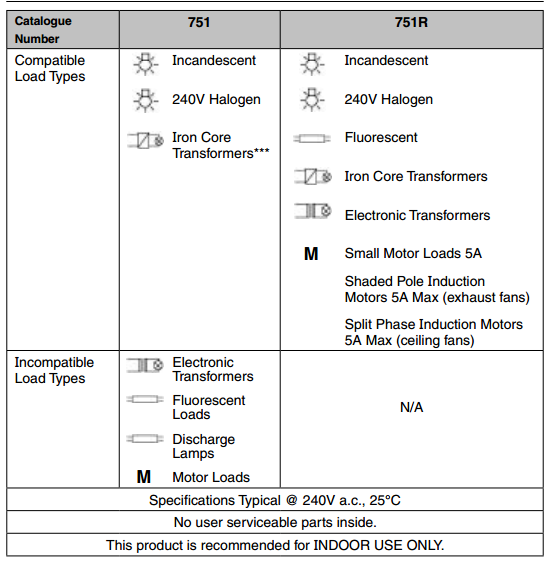

You can wire it with the existing wires - BUT
the instructions also state:
and:
It won't work with LED lights. Do you still have an incandescent light?
and:
Thanks @EFLImpudence So it is an LED light but doesn't use a transformer.
Cheap one I bought off Amazon. https://www.amazon.co.uk/gp/product/B07Y61SJ6Q/
If it will work does it matter on the top diagram which red goes in the Active/Line and which goes in the Load?
If the PIR is unsuitable any suggestions of makes/types of PIR that would work?

It won't work with an LED light.
The instructions don't say that, other than electronic transformers.
For what it's worth I know a building with loads of them including operating single 3.5W mains LED's in the toilets (the initial installations) with no problems. The areas with bigger loads or/and Fluo fitting needed the 3 wire version.
