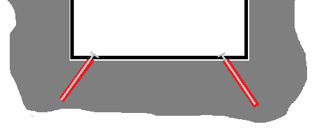

I use 5.5mm drill and make the holes at horrible angles then gently hammer the plugs in.
This gives a better grip in the thermalite dust, countersunk definitely works better when the screws are crooked like these.

Funnily enough, I was taught to drill such fixings at angles (dovetail was the term he used) to give a bit more strength to the fixing, so it couldn't be pulled straight out directly.
