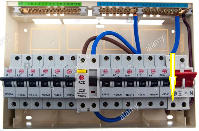

Indeed. It's very often done to feed a second RCD, isn't it - in other words, it probably happens in virtually all 'dual RCD' CUs (including the several in my house).
The devices in question there are not RCBOs, they are main switches.
No matter how much, or how many, people think "Oh well - they are all the same terminals, it must be OK", and no matter how correct those personal opinions are, these are type approved units - putting a busbar and a cable into one terminal must be approved by the maker, or it simply cannot be advised.
But "not necessarily can't", and no being able to see a reason why not are simply not an acceptable alternative to a definitive statement from the maker. They just are not.
I have to say that I am becoming increasingly tired of this modern world in which people are apparently not allowed to think, apply knowledge, experience, intelligence and common sense and make judgements for themselves. Even though (as with most things in life) those judgements may sometimes be wrong, I don't think that everyone should be regarded as idiots, but it seems that we are always expected to look to third parties to give us permission to do virtually anything.
In this particular case, as I have implied, knowledge that the practice we are discussing has been utilised by manufacturers in millions of 'dual RCD' and 'Split Load' CUs gives me confidence that, in addition to the fact that (like EFLI) cannot I think of a good reason for not doing it, it is apparent than many large and 'reputable' manufacturers have decided that it is an acceptable technique/practice.
...and as such have exactly the same terminals.
I do not think that; I think it is OK as there is NO reason for it not to be.
So, you agree it is correct.
OK
That's that settled.
It is settled only in the sense that neither you nor JW2 are prepared to recognise the problem.
Everything you have said can also be said about mixing and matching different makes of MCB in a CU, and yet this is always deprecated because of the type testing issue.
The photograph above shows a configuration approved by the maker. You are advocating doing something which is not approved.
Neither you nor JW2 are prepared to accept the fact that no matter how certain you are that it will be fine, no matter how correct you are, and no matter how tiresome you find an apparent prohibition on you thinking for yourselves, you may not tell people to connect cables to the busbar of a CU in a way which the maker does not support.
If there's nothing wrong, then there is no harm in asking, for they will surely say it will be OK.
If you are worried about asking because you are worried that if you do they will say it is not OK then that ought to tell you that you should not be suggesting it.
You are prioritising your "right" to do something which is not approved because you know it will be OK and therefore what you decide can be done may be done, no matter what the maker of the equipment thinks about it.
I'm not sure whether you have read this whole thread, but I have certainly not been "telling people" anything about this issue.
Most of my contribution to this thread related to the 'on topic' question in the OP about CU orientation. EFLI then showed a CU which would fit (horizontally) into the OP'#s available space, indicating that one could fit 8 RCBOs into it if one removed the main switch and had an external isolator. In response, I asked how one would connect the incoming L under such circumstances. In responding to my question, EFLI made one suggestion, which we have been subsequently been discussing/debating, and you made two other suggestions (and no-one has yet asked you whether they are 'supported by the maker', and whether utilising those methods would invoke 'type testing issues').
