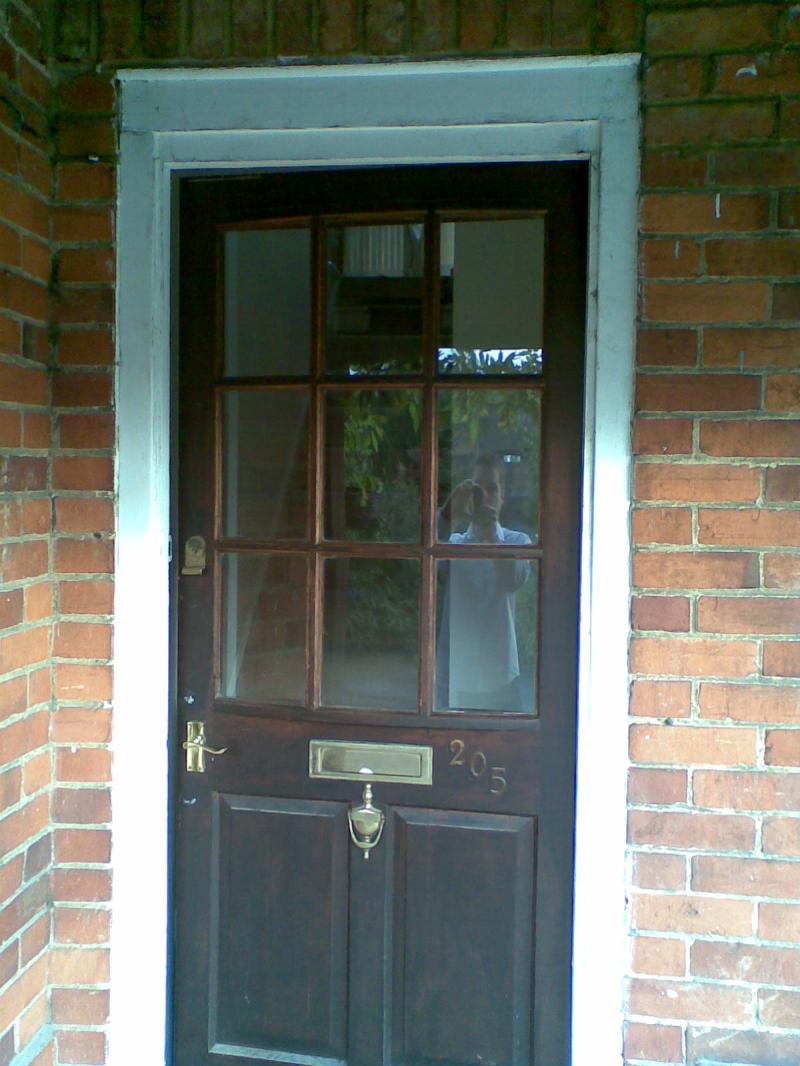

I want to replace my old front door with a more modern UPVC one. The current door is set into a fairly large aperture in the brickwork, and so the frame is very thick in places (see picture below)
The aperture in the brick work is 220x99 cm. For cost reasons I'd like to buy a door/frame from ebay rather than getting it custom made, and the frame sizes that are available all seem much smaller - around 8cm narrower and over 10cm shorter and 12cm in height.
How can I pad out the frame without ending up with something looking rubbish? At the moment the best I can think of is fitting a wooden surround and glossing it in white, then bolting the frame through this into the brick work.

Without wishing to be offensive, plastic doors are expensive, but far weaker and less secure than wooden ones, and IMO look horrible. They reduce the value of traditional older houses.
Plastic doors do not respond well to being changed in size after manufacture, but a competent joiner can easily trim and adjust timber.
Would you be willing to look at the cost and practicability of getting a new wooden frame and door fitted? It is likely to be easier and cheaper, as well as better.

If a wooden door won't close easily, I suspect it has drooped on its hinges. Far easier to fix than a new door.

It's a great looking door - almost Dickensian. It would be a shame to scrap it unless it's got terminal rot.
I think the reason it's tight is due to the amount of weather strip and seals that have been stuck to it over the years. The drafty gaps around it's edge are probably only 1 or 2mm so the seals don't have enough room to work properly.
Perhaps I should change tac, and try to chase some rebates into the existing frame, and then fit a decent seal around the whole edge - are such things available?
if the situation is as you describe, start by taking all the seals off
see if it now closes properly
see if it has drooped at the joints or if the hinge screws are loose
see if it and the frame are both square, or both out the same way
see if the locks fit correctly
whatever defects you discover, people on here can help with
after you have got the door and frame tight, you can if necessary adjust the locks and look at new weatherstrip after you have stripped and repainted it
some detail photos will be nice as you work.
