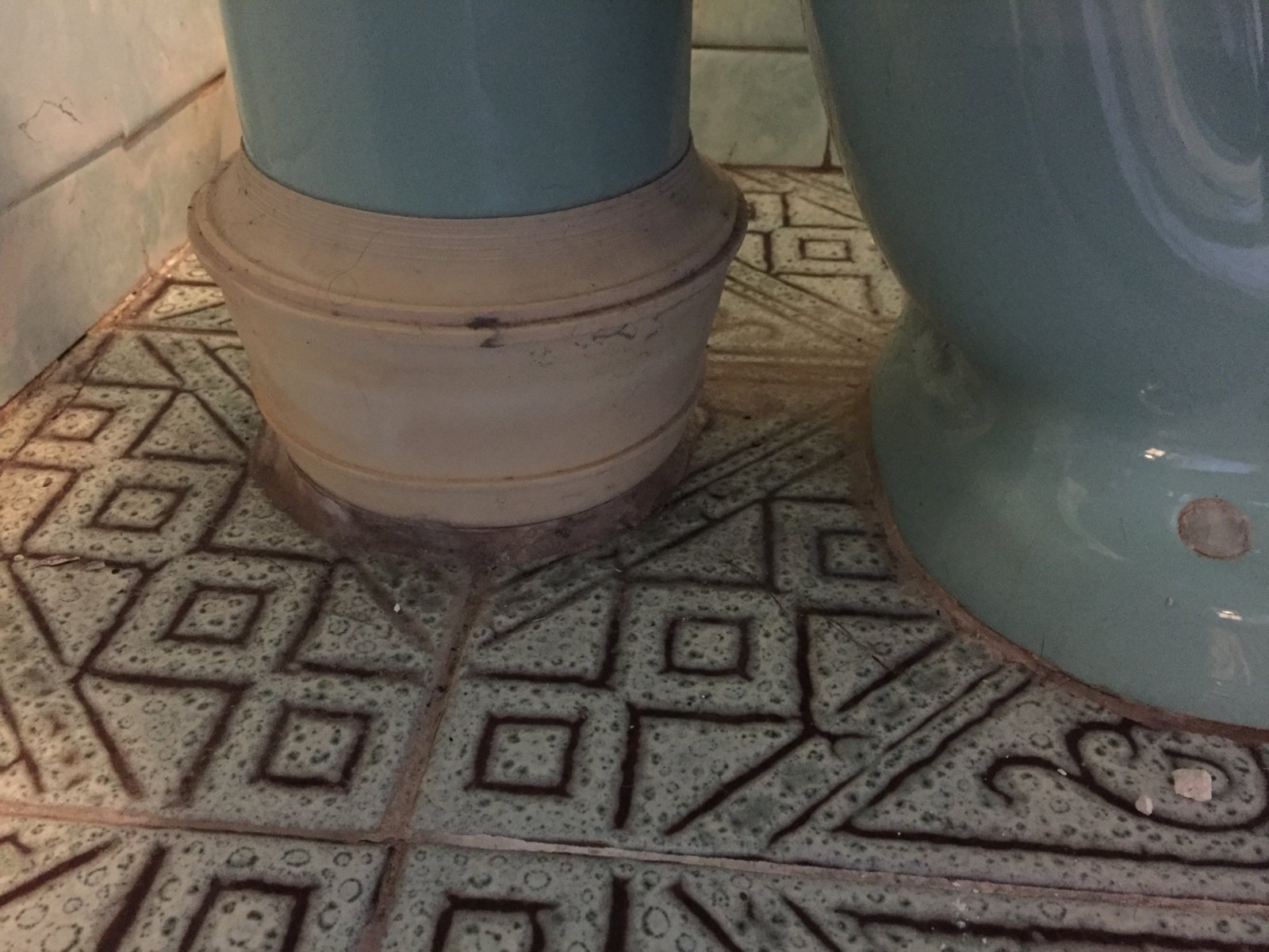

I want to fit a bottom-outlet toilet to replace an existing item. I've already sourced a suitable toilet (a Twyford Alcona)) which from the dimensions looks like it should swap straight in with no fuss. (Hmm!)
The existing toilet is still in use, and I don't want to remove it until I'm in a position to fit the new one immediately. That means having all the necessary fittings in place on the day (which is particularly an issue at the moment, what with local suppliers being closed... but my problem is until I remove the old toilet I won't be sure what fitting I need to connect the toilet to the hole in the ground! (and I'm betting that after removing it, there will be no chance of temporarily refitting it).
The existing installation is an old house with a solid floor, I'm almost certain that the buried outlet pipe will be an old ceramic one. I'm attaching a photo of the existing pan. The white fitting is hard, very old rubber (which I doubt very much will come away in one piece). Can anyone advise what fitting I'm likely to need to connect up the new one?
Thanks for any advice
That's an old multikwik straight pan connector by the looks of it
th
Any straight pan connector will fit though. I'd maybe get an McAlpine adjustable length straight connector which would allow you to adjust the length if needed.
th
Ah thanks Rob, IDing the existing connector is very reassuring!
As far as I can see from looking online, the new toilet's outlet looks to be almost at ground level. Is the idea of that McAlpine connector that the finned, male part will just disappear into the ground, inside the soil pipe, as far you want?

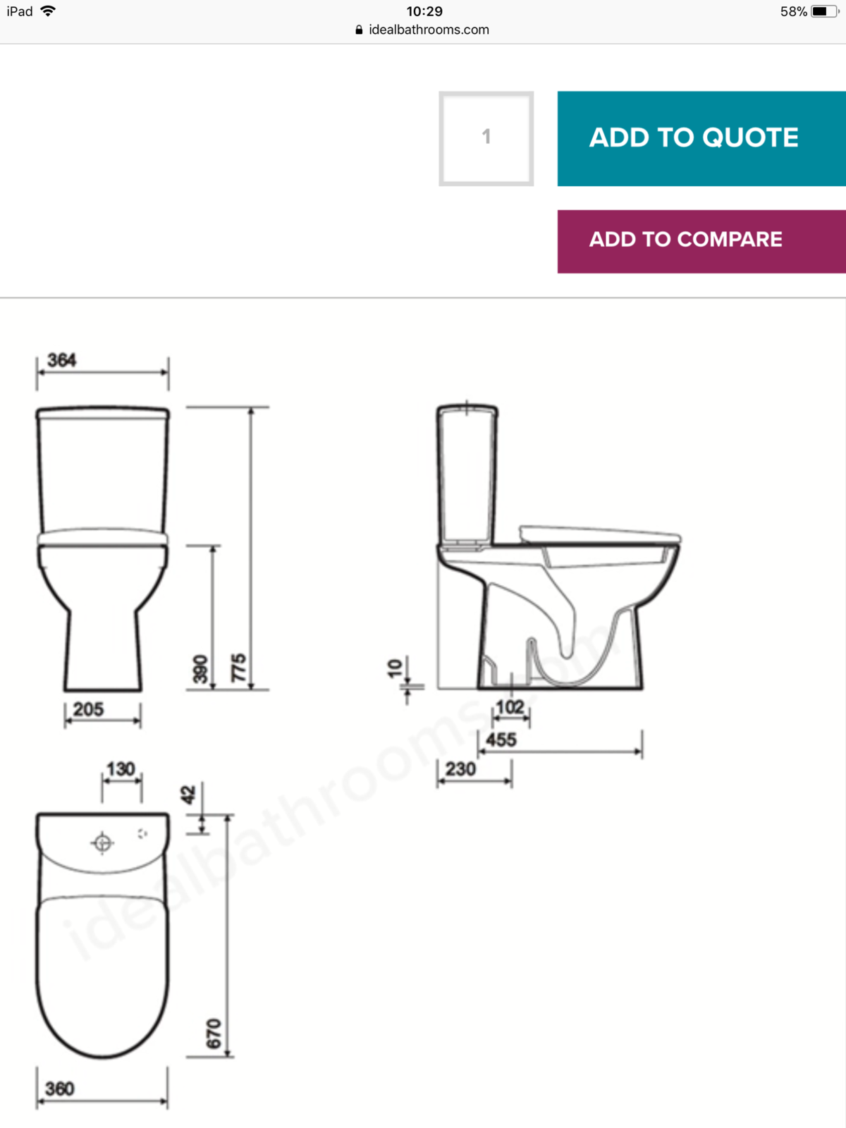

5262D845-C208-4790-955B-844619F93647.png I looked into these when replacing a Bo pan and from the diagram wasnt sure if there was enough room for the collar of the pan conector and its a lot of trouble sending back if bought on line. I ended up getting a p outlet and space saver connector
If you have enough space in the room it may be simpler.
An E100 BO fitted into my very small room.
