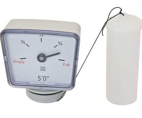

I bought this cheap gauge to help a friend out (I have a Watchman myself, but my generosity doesn't stretch that far), but can't figure out the best way to fit it.
It has a threaded neck, but no kind of nut or anything to tighten from inside the tank. The instructions simply say it fits a 1½BSP hole, but the hole would surely have to be tapped with a corresponding thread?
Am I missing something obvious?
Anybody fitted one of these?
Thanks :mrgreen:
That gauge is really intended for a steel tank that would have a suitable threaded socket already welded on.
You will struggle if it's a plastic tank.

You could buy a fitting with 1½BSPF one end, the other determined by how you could fit it to the tank. eg if it's a flat top tank, you could use a flange. Make a hole to take the float, and bolt the flange on.

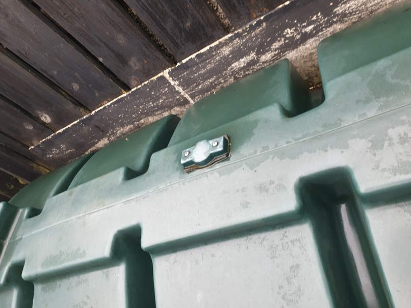

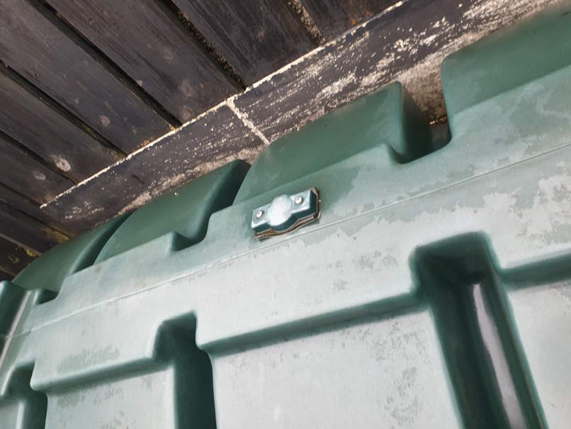

What's this thing? I don't suppose there's a 1½" hole under it perchance...
Access is awkward (there's a fence in the way) and I didn't have a screwdriver, so couldn't investigate...
No, that's for an Apollo ultrasonic gauge https://www.bes.co.uk/apollo-ultrasonic-oil-level-monitoring-unit-17899/
You can't fit the one you've bought to that tank. As you've already deduced, it requires a 1½" threaded hole and plastic tanks just don't have those. You could potentially drill such a hole if you could find a 1½" backnut but I wouldn't fancy your chances on making it watertight.
