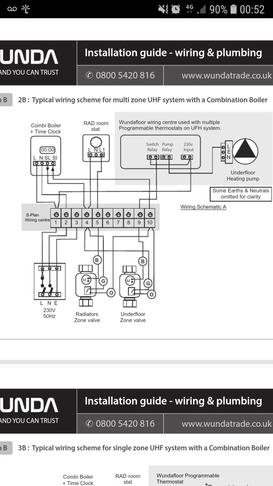

I have the same Alpha boiler for the moment i have a wireless thermostat (easy stat reciver, page 24 in boiler manual)but i was told by Alpha manufactured that i cannot fit a zone valve with this thermostat. So i decided to fit a Hive thermostat. I understood perfectly from your previous comment where to connect the Hive thermostat into the boiler
I have this diagram for the underfloor heating. From where am I going to take the SL and SI from the boiler.
Can you please tell me?
Thank you
When zone valves are fitted. The thermostat operates the zone valves and it's the zone valves that operate the boiler. Each zone valve has a microswitch inside connected to a grey wire [Marked (G) on the drawing] and an orange wire [Marked (O) on the drawing] they go to SL and SI, exactly as shown in the diagram you posted.
Thank you very much for the replay.
I don't know wich slots ar SL and SI in the boiler
If i connect the Hive reciver in no 1 and 2. Where do i connect the grey and orange?
Thank you
If yours is as shown, then it's terminals 1 & 2 that the grey and orange wires go to.
Grey to 2 and orange to 1, remove the link first.
And I've told you already. The Hive does not connect to the boiler at all when there are zone valves fitted.
The Hive thermostat operates the zone valves and it's the zone valves that operate the boiler.
Thank you very very much. all makes sense now.
I appreciate your quick response and your help thank you
