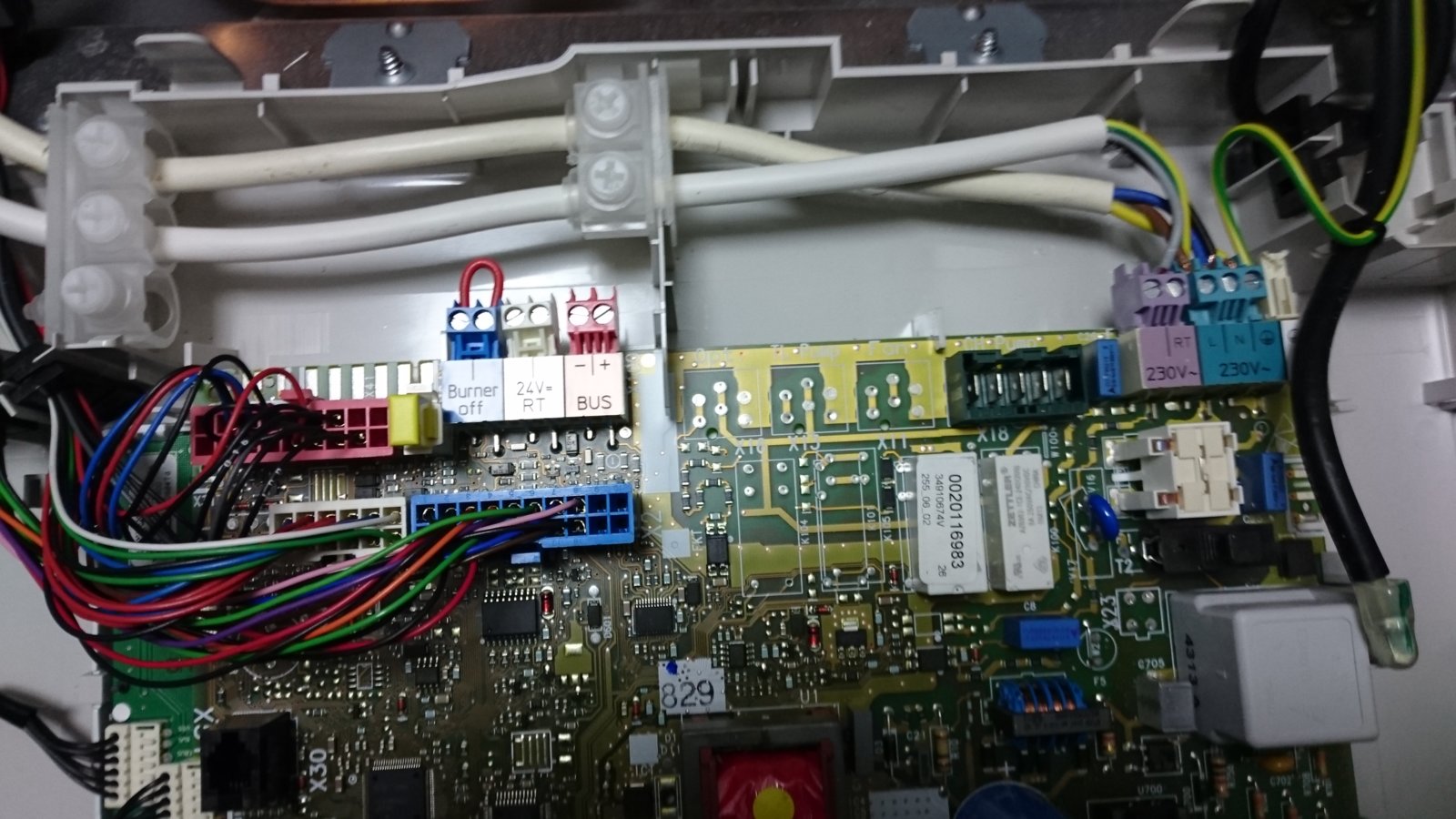

I am trying to replace the vrt350f unit with the hive as it is extremely unreliable.

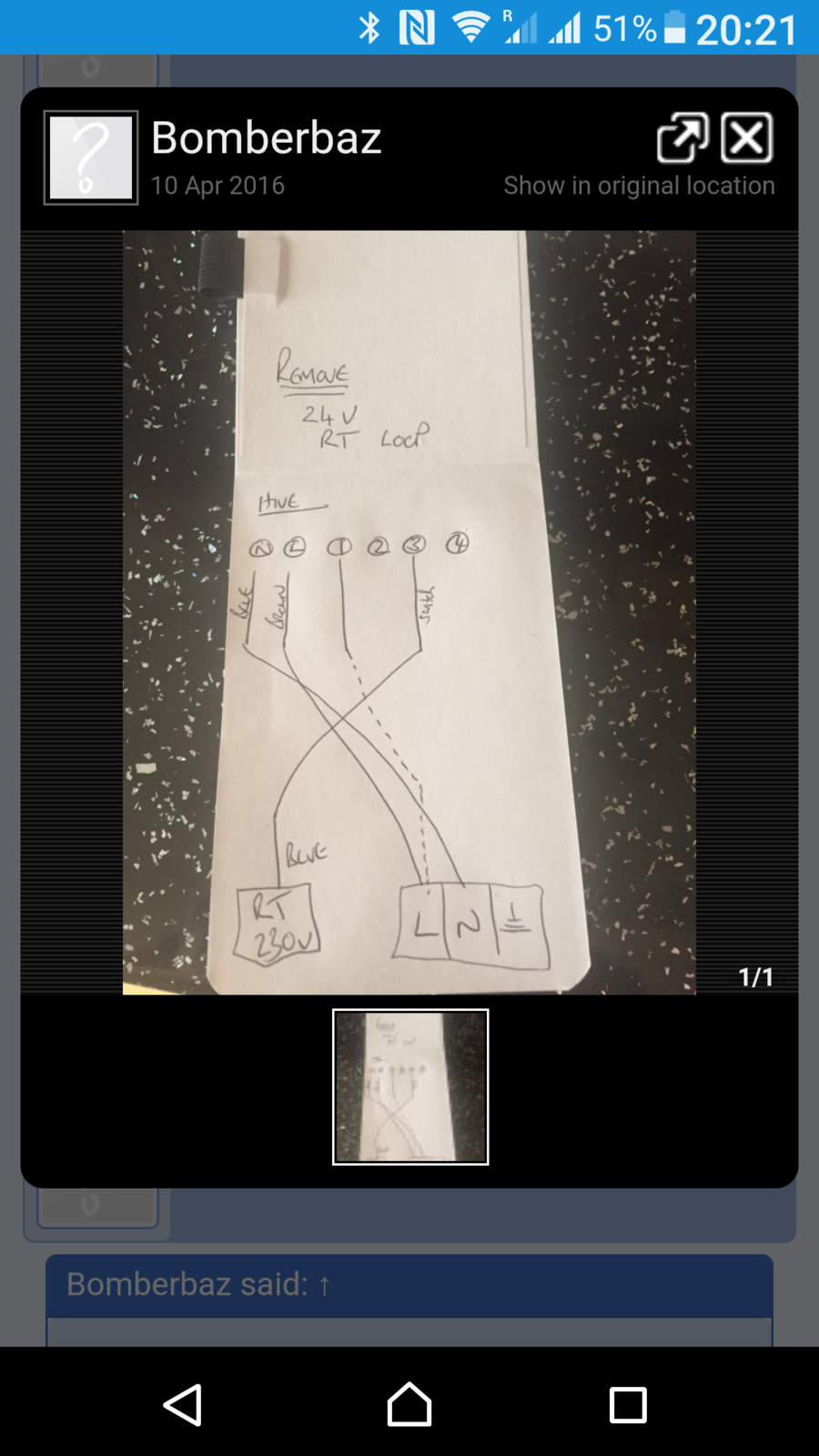

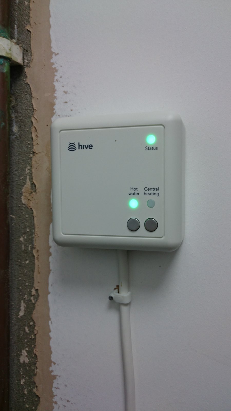

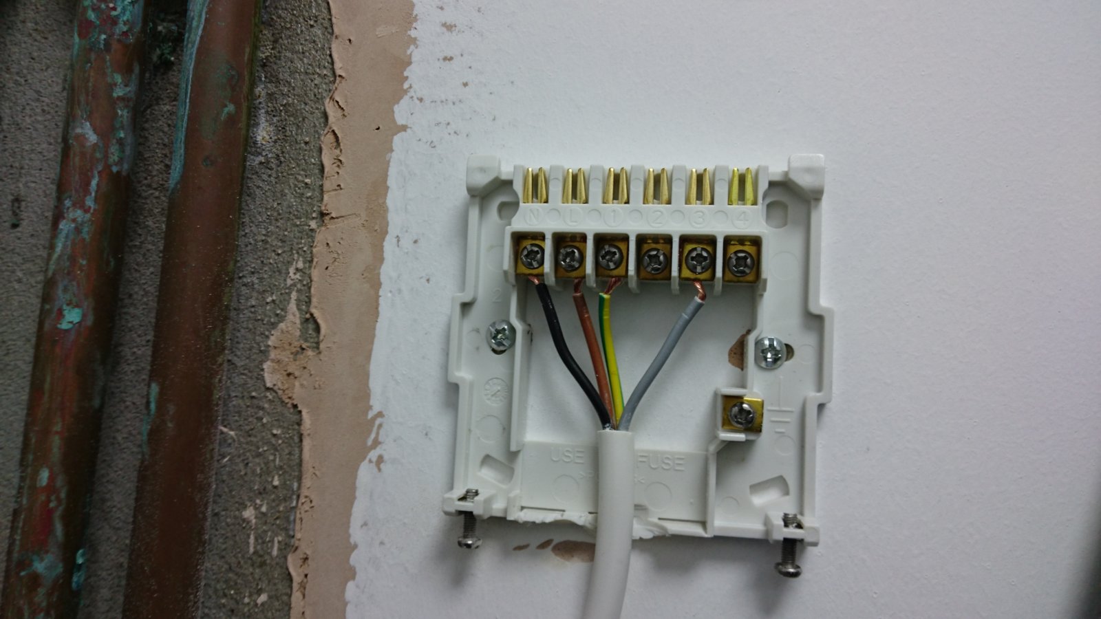

I could really do with some help as I'm going round in circles trying to get the hive to work with this boiler, I'll include photos of all I have done, plus following someone else's wiring guide which (could be my downfall) After fitting all the wiring get the hub working etc. you are supposed to press the central heating button to check everything is wired correctly, nothing happens, the boiler doesn't fire up. When you press the hot water button it starts heating the radiators. Hot water on demand works fine. I do not have a clue why this is not working. Can someone please check my photos and tell me where I am going wrong.

Just looking at the photo of the receiver with hot water light on, you have a twin channel version of the Hive, but wired it up as a single channel version. If your boiler is a Combi version, you have the wrong Hive.

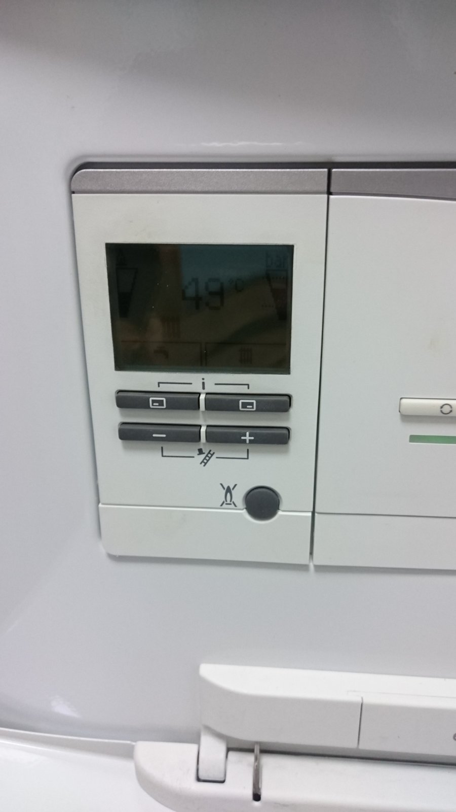

Hi Stem thanks, I'll redo the wiring :) I've followed the hand-drawn diagram if that's any help? So am I right in thinking I have to set the inbuilt controller to be permanently on for both hot water and heating? I've not come across that in any other threads, is this a known issue that isn't explained in the Hive instructions?

If this is a Combi boiler just move the grey wire from 3 to 4 and the yellow/green (earth) wire to Earth at both ends and it will control your heating. The hot water side of the hive won't do anything.
Glad to hear you got it working. I didn't suggest that because I assumed you wanted to do proper job. But if you are OK with it like that all well and good.
