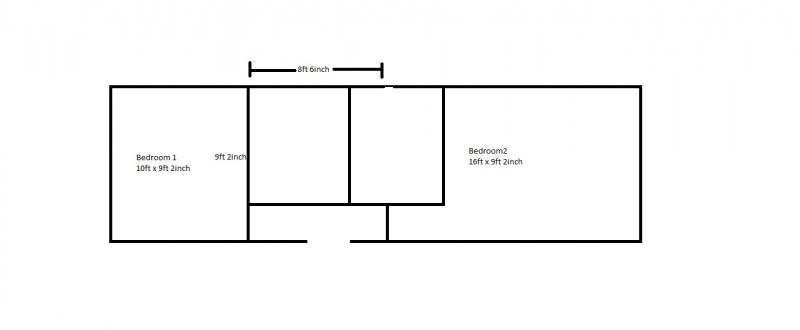

Hi all
House has got an old extension over garage, in which 2 bedrooms were created and large landing.
Im thinking of utilising the space to create ensuite to each room, and acess to each room as well. Total space is about 8.5ft x 9ft
Is this possible? Anyone got any ideas?

Just to add: I'm currently looking at different architects hence why this has not already been drawn up properly. Just seeing what is viable, I'm hoping somehow they can fit in. New roof will be going in around the same time, and hoping to add a velux window for each one as well for light and ventilation.
I would be grateful if people have done similar and could post the footprint and maybe some pics of it.
I would like a toilet, basin and 900mm shower in each (square or quadrant)
I've just finished an ensuite off our master bedroom and I found that 1.6m x 1.6m of internal space left plenty of room for a sink, 900 quadrant shower and a loo. It has a 27" door opening inwards, the loo is directly in front of you when you walk in, the shower is diagonally opposite and the sink is to your left. Heating is via electric underfloor heating and there is a small electric towel rail too.
The room is plenty big enough and doesn't feel tight for space at all. There is no window but mechanical extraction and a frosted glass door to the bedroom.
Looking at the measurements, 1.6m would mean the hallway to the doors for the bedroom would be about 900mm wide.
How wide is your sink?

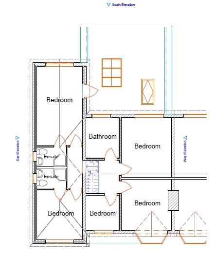

Thought I'd update this following initial drawings from architect
The corridor to enter rooms will be 950mm wide. Each ensuite will be 1875 x 1237mm, and will mean no loss of space from bedrooms
