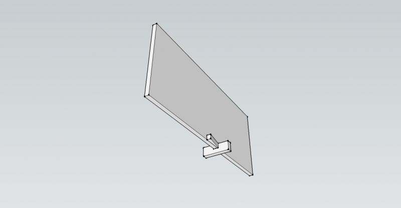

For next time notch a piece of 100 x 50 sawn timber to sit the door in and wedge it in place. Works a treat.
A block each end is best, and the drawing is viewed from the bottom so you can see the 100 x 50 under the door.
And there was me thinking only I did that :p
