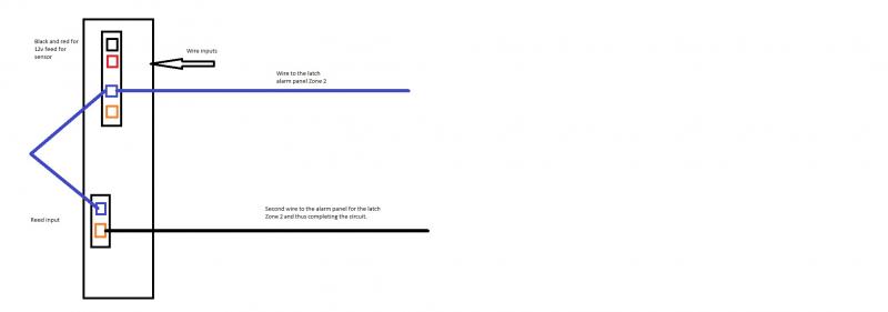

Piccie of internals....
Would I be right in thinking that the magnetic door contact's wiring would go to the Alarm connectors and then the 12v to where it is marked and finally a 12v+ to the LED (which I could take from the 12v + I am feeding the unit..?)...? The tamper I am not bothered with.

My old magnetic door contact has been wired (by me) with std 6 core alarm cable and it is fitted to a Optima XM6 Alarm Box. My back door is wired to Zone 2. The manual for the alarm I have uploaded to my Dropbox account...

Realising that my old magnetic contact did not require a 12v supply I would like to ask for a little guidance please before I decide to try and fit this myself. Could I take the supply (works between 12v and 16v) from the 13v output terminals shown in the Optima manual...?

Yes, you can use your existing alarm pair for the shocker, and supply it with 12 Volts from a spare pair. If it appears dead after setting up, give it a tap with the handle of a screwdriver to bring it to life. Lower door panes are prone to attack so you are smack on in sorting this out. Zone two is called an 'intermediate zone'. (old fashioned term) and will go into alarm immediately if the entry exit route detectors have not been triggered first. You seem to be doing everything correctly from my point of view. Other opinions may differ.
If this is part of your normal exit/entry route you should ensure that the shocker is not subject to de-bounce, this will be in your instruction leaflet.

I have fitted the unit and it seems fine with the sensor tripping the latch when a bang is given to the door panel. But will turn the LED on the sensor red if it is only a small tap and thus the alarm will not be tripped.
Fitting the magnetic contact in close proximity to the unit though seems to have no effect. This is the only part that seems to be not working and I'm not sure why...?
I have now wired the magnetic aspect of the sensor in sequence with the vibration part...
if either of the gates are open it will trigger the alarm.
So it seems to work :)
