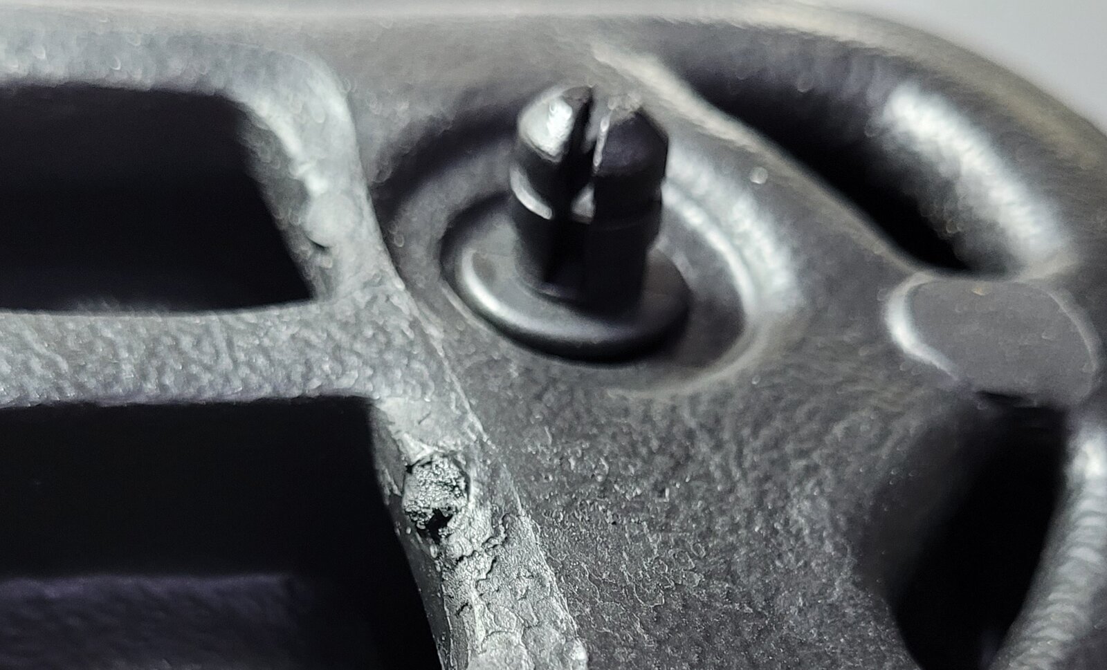

My question is …. i often come across items which have a round probe fitting on the item you are push fitting into surfaces mounted sockets.
Just saw some today .. on back of pads that are pushed into place.
The plastic ‘probe’ is slightly larger diameter but split lengthways … so pushes in and ‘locks”
Aybody know what these are called ?
I can photo if description mot clear.
Often used to hold trim panels in place on boats or caravans
From the description the only thing I can think of are those push connectors that they use for car interior panel fixing.

Do you mean this kind of thing

Here is a typical example .... a headrest pad .... the 'male' portion on the pad, plugs into female sockets on the panel.

Those items are a bit too light weight ....
Problem with magnets is rust (esp of steel it sticks to)
Plastic (nylon) inserts pretty bomb proof.

If you go for the nylon car fittings, you need to find a way of gluing in the female part without the glue occupying the space required by the male connector.

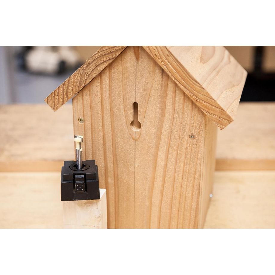

It the sides of the box are sufficiently thick, you could use a keyhole cutter in a plunge router to create two keyhole sized slots, and then have two stainless steel screws projecting out of the shed wall.
The following shows one used on the back of a bird house.
OK .... that has merit ..... I have a router, will give this some thought. I had been thinking of some wide velcro
