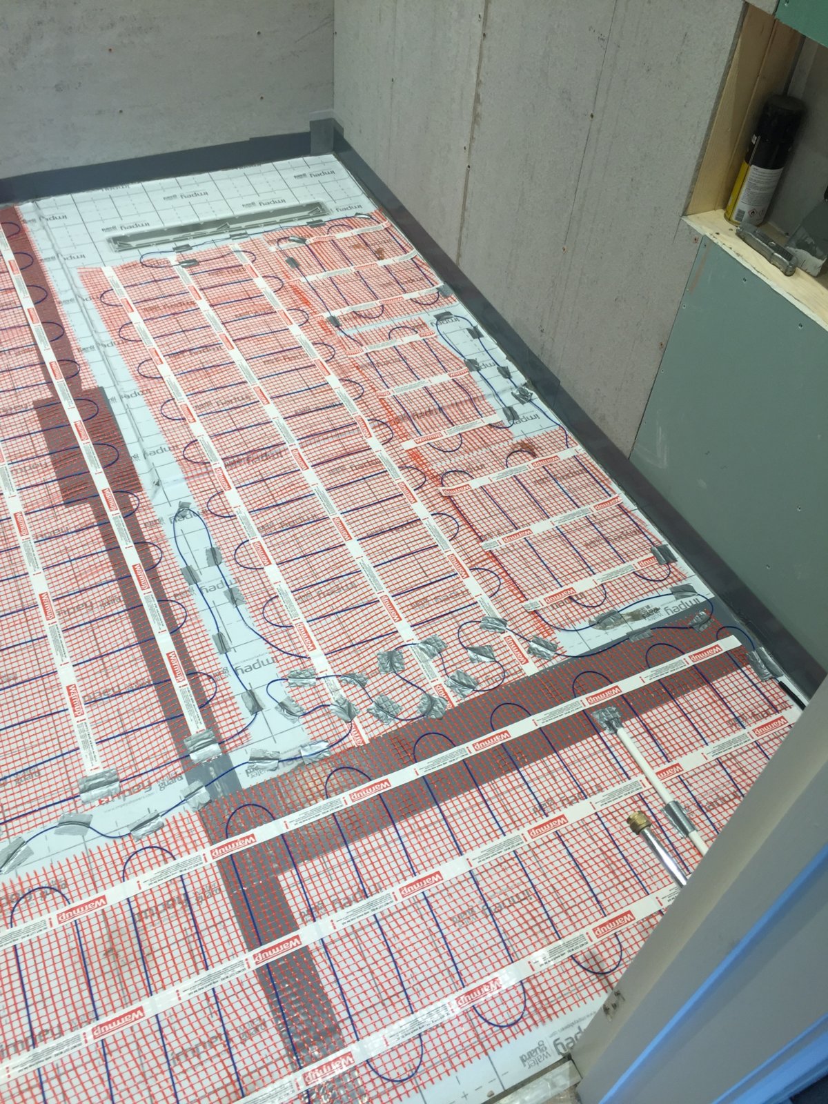

Here's a close up of the floor
Sounds like I'll proceed with tanking the walls, just need to be certain about the floor and what product to use for sticking it down with
My post was intended to warn about "Tanking" and the proper systems to use.
As @Madrab has confirmed you use a product such as Impey that have a very sticky backed , cloth type membrane, with an even sticker tape for corners and interfaces between walls and floors.
Its not tanking in a tin which you just paint on....
