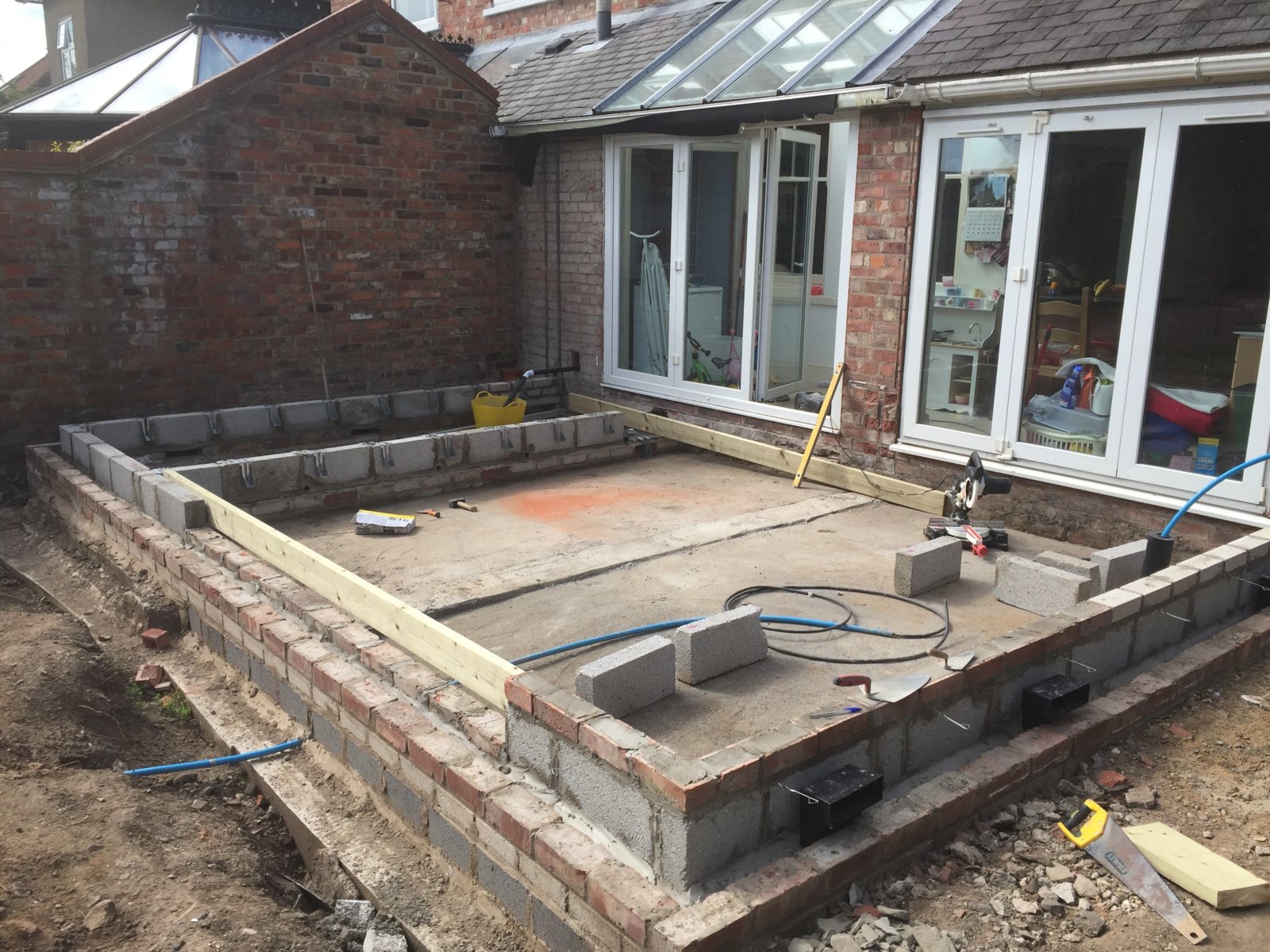

At what level do you start the cavity wall insulation ?
You can see i have placed a joist in its finished position temporarily for today. This will be the floor level. The breeze block course with the cavity air vents is the bottom of the cavity and i have formed a ridge of mortar in this channel so any water will hopefully push outwards.
So would i set my full fill insulation down into the bottom of the cavity, or do i start it a little higher up, at the top of the first line of breeze blocks, which will be floor level ?
Also does it matter if the cavity is a little narrower than the 100mm insulation. The facing bricks are wider and so the cavity is going to be 90mm wide i think.

should be down to the same level as the insulation in the floor structure

Why have you gone for a suspended timber floor? It would have been easiler, cheaper and better to do a concrete slab. You sill can get rid of you hangers add 250mm of eps then do a screed.
With full fill insulation I always make the cavity a few mm over the 100mm.
I have done a suspended floor and it is all in now (not the actual timber, but the hangers). For me it was much cheaper and easier to do a suspended floor.
I had a choice of filling back in about 8T of material or carry 15 pieces of wood up the drive. I am doing all the work so a no brainer for me. Plus the materials in suspended are much cheaper overall. My labour is free.

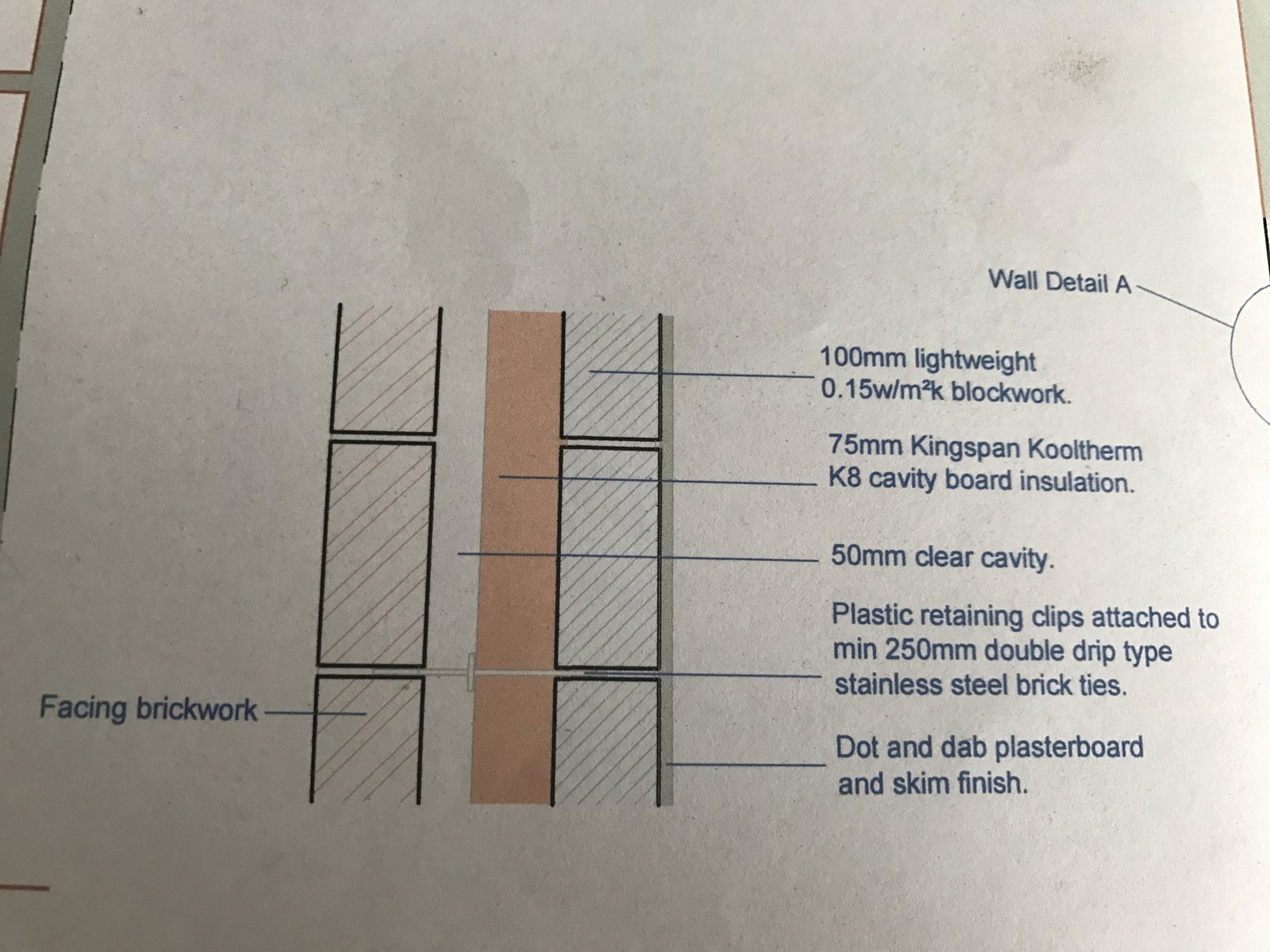

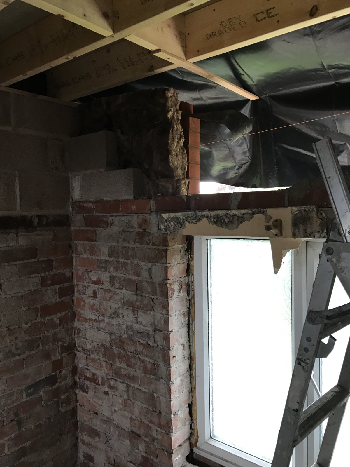

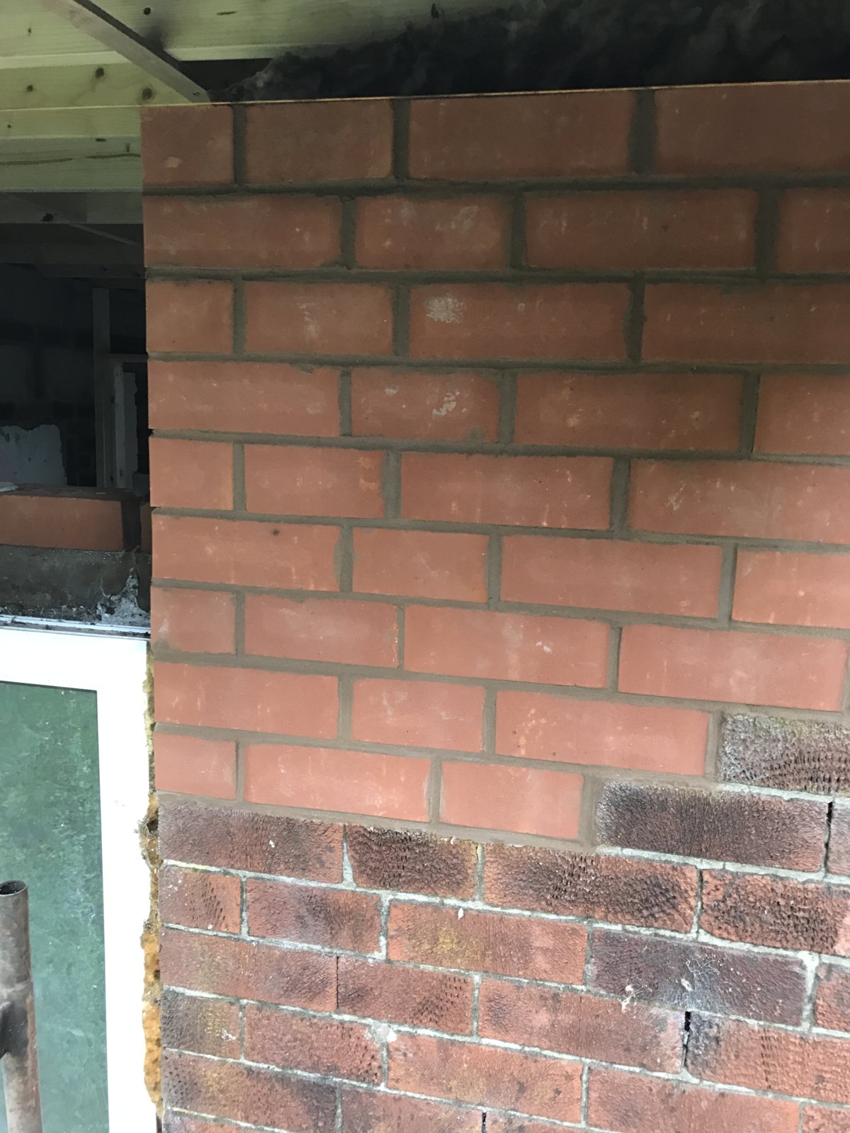

The guy who drew the plans seems to think we have a 125mm cavity. We are just raising an extension by a few feet so 75ish mm is all we have.

100mm quilt will fit in a 90mm cavity no problem. You can always oversail the block leaf 10mm or so if need be.
The cavity will get wider as the wall is built up anyway. This is a natural occurance.

Build the brickwork up first on full fill. You may as well use 85mm insulation in a 90mm cavity as crushing it makes it less efficient.
Cavities tend to get bigger as masonry tends to go outwards out of plumb as the wall goes up rather than inwards, but in theory it should stay plumb.
Oversailing at the bottom may be your best option. Often done at joist height to reset the cavity size.
