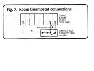

The only thing about the worcester instructions is the third neutral connection from the thermostat - here's a snip from the manual
Can I ignore this if i'm using the CM927 and connect the L + N supply, then A and B terminals to the two end terminals ?
cheers
sam
Yes, ignore the neutral connection shown in the diagram. It was required for the old mechanical thermostats.

and fit n/o and com which is which on the x4 block
is com last termanal thanks
From Fig.7 the terminal nearest the edge of the board will be the Switched Live (to NO) and the one next to it Live (to Com) -
but the way you are wiring the thermostat it doesn't really matter which is which as the thermostat just connects them.
