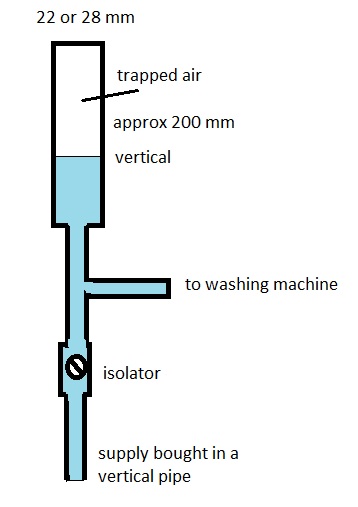

You could also try an 'old school' water arrester - a length of vertical 28mm pipe with closed end (the trapped air acts as a shock absorber). Water hammer can exert alot of sudden force, the 'kick' can easily be several 10's of BAR if the stopping of the flow is rapid enough.

I was reminded about this post I made a few years ago. The device is still working ( but not on my machine )
For a washing machine a home made arrestor will normally suffice
hammer-stop-jpg.87048
After time the trapped air will have dissolved into the water. Then close the isolator, loosen the connection to the washing machine hose to drain the water out of the 22 mm section. That replaces the trapped air cushion.
