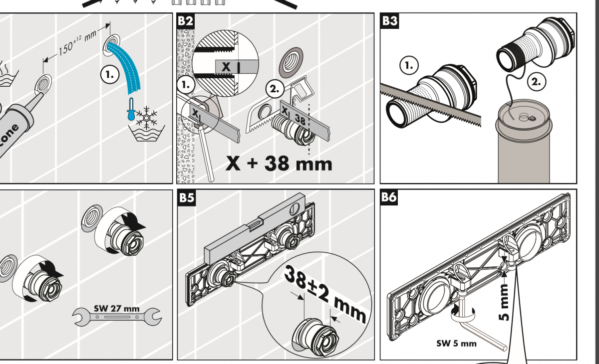

Sorry keep saying plasterboard, but its actually Orbry insulated tilebacker board 10mm. So, if I get an easy fix/fast fix bracket that mounts onto the tile, won't that make the shower stick out from the wall? I kind of like the kind of shelf-type showers you get in hotels (put your shampoo on top!) and the friend who gets them (removed by customers who want a replacement) says they have a hansgrohe raindance select shower. Here's a guide I got from their websiteCapture.PNG and they seem to use a thread that's embedded behind/level with the tile and as the tiles are yet to be installed, will it be better to remove some board and fit something so the thread is level with the tile and enough space to screw the shower to?
