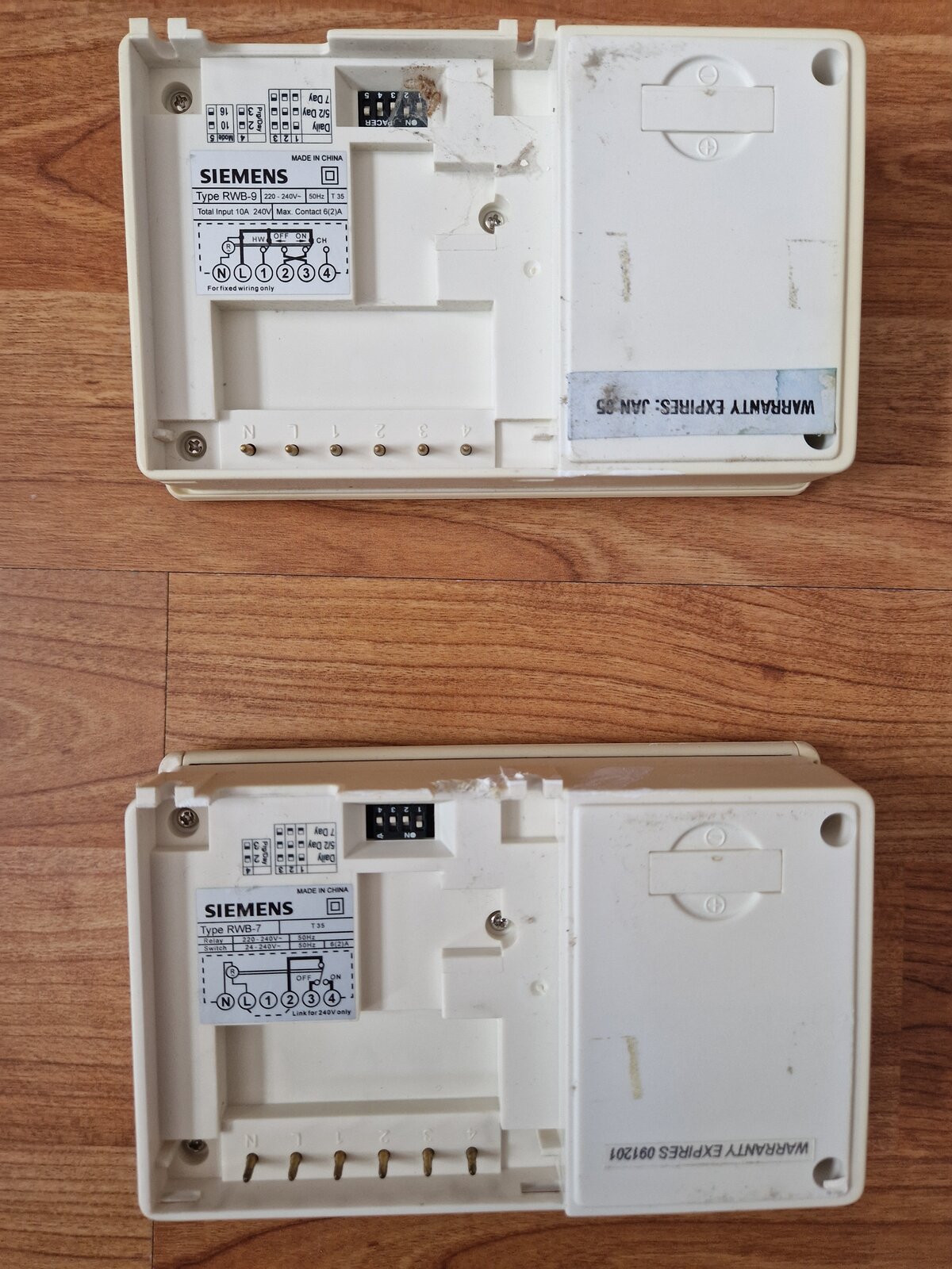

I think the upstairs loop not working was due to a faulty 2 port valve. It’s a Siemens DVA2/5. It was making a clicking sound when on but wasn’t opening. The manual override was also not doing anything. When I took it off and turned it on, I could still hear a clicking sound but nothing was moving. I couldn’t see the gear from the side.
I’ve opened the valve manually and now the upstairs loop is working, but it also turns on when the hot water is on.

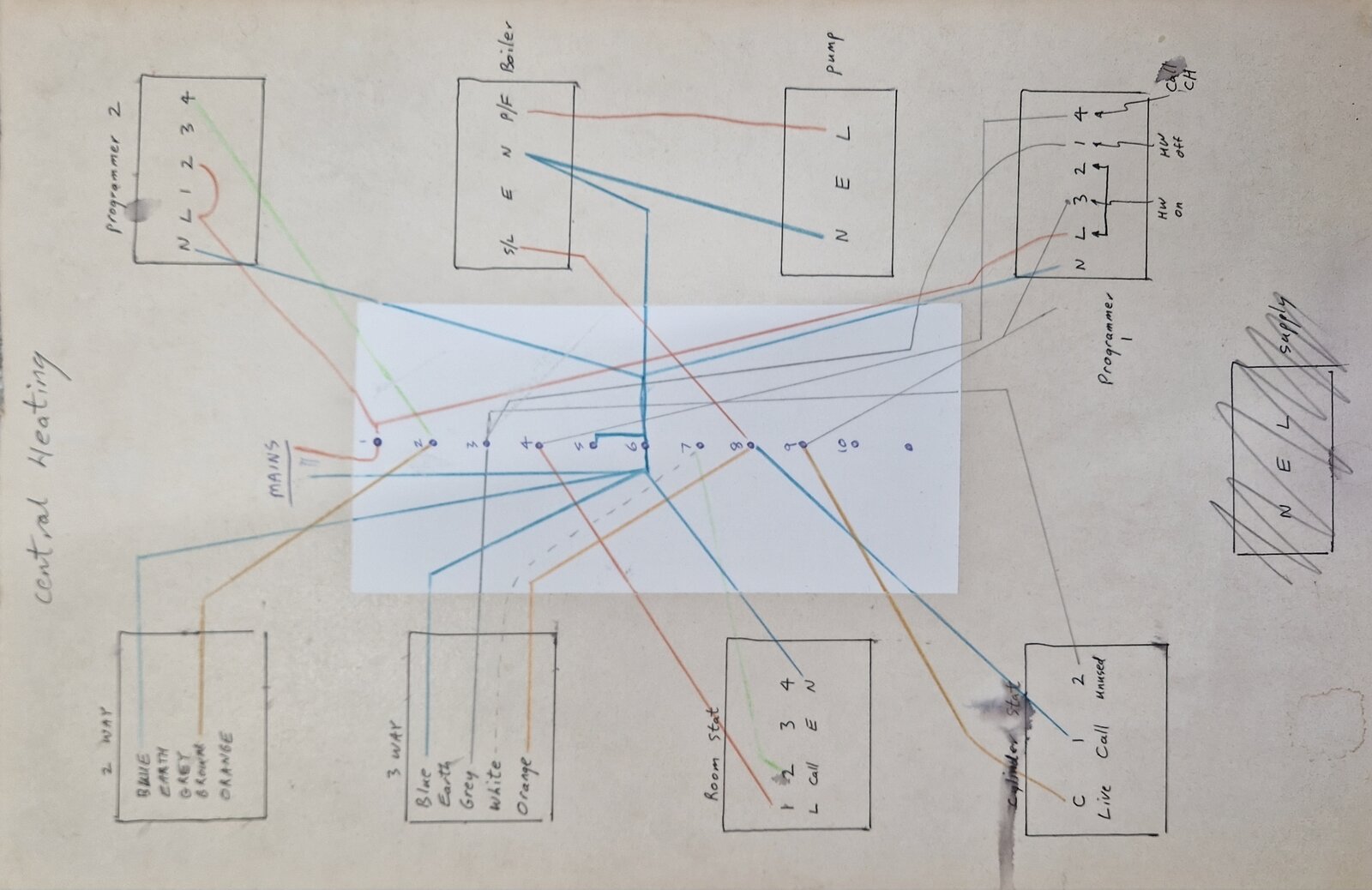

Conventional Y plan but with an upstairs zone controlled by a separate 2 port valve that’s dependent on the downstairs heating being on.

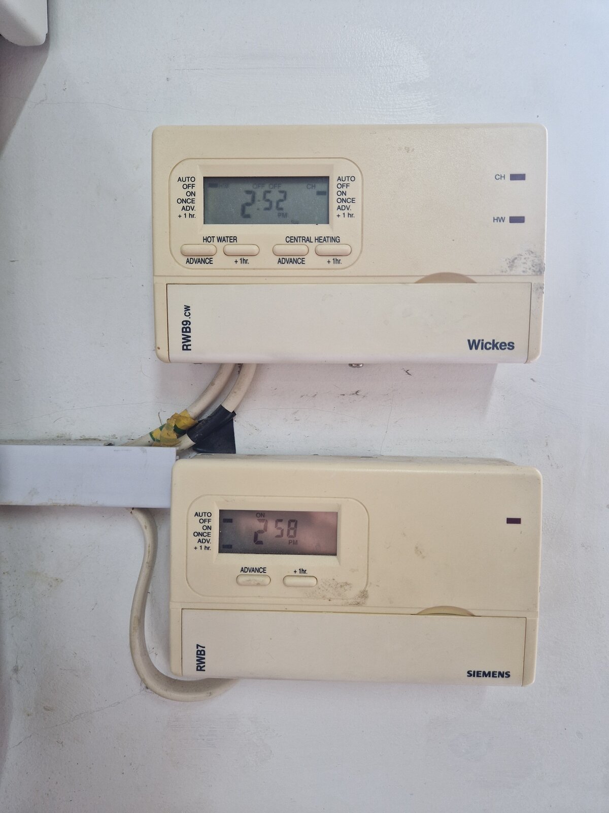

2 Timers

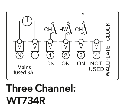

I’m looking at getting a Drayton Wiser 2 channel kit (but I’m open to other suggestions).
I was hoping to keep the 2 port valve manually open and replace the timers with a drayton wiser 2 channel kit with smart TRVs on each radiator. But I don’t think it’s as simple as that especially if the upstairs radiators heat up when the hot water is on. Could I just replace the actuator with a working one, get the kit I wanted but wire the 2 port and 3 port valves in parallel to control the radiators?
Or should I be doing something else?

2 Timers

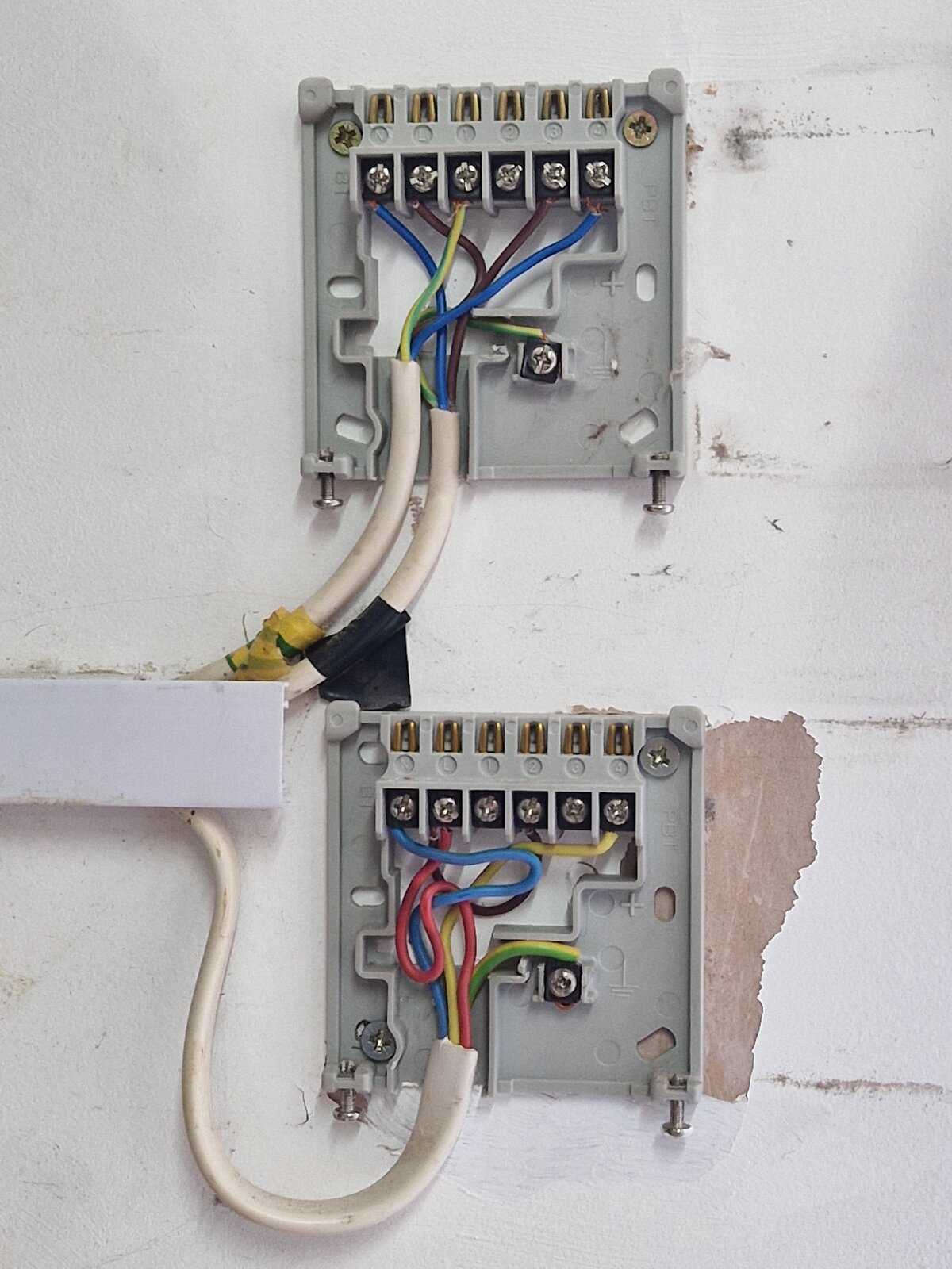

- Wickes RWB9 controlling hot water and downstairs radiators (presumably connected to 3 port valve)
- Siemens RWB7 controlling upstairs radiators (connected to 2 port valve)
