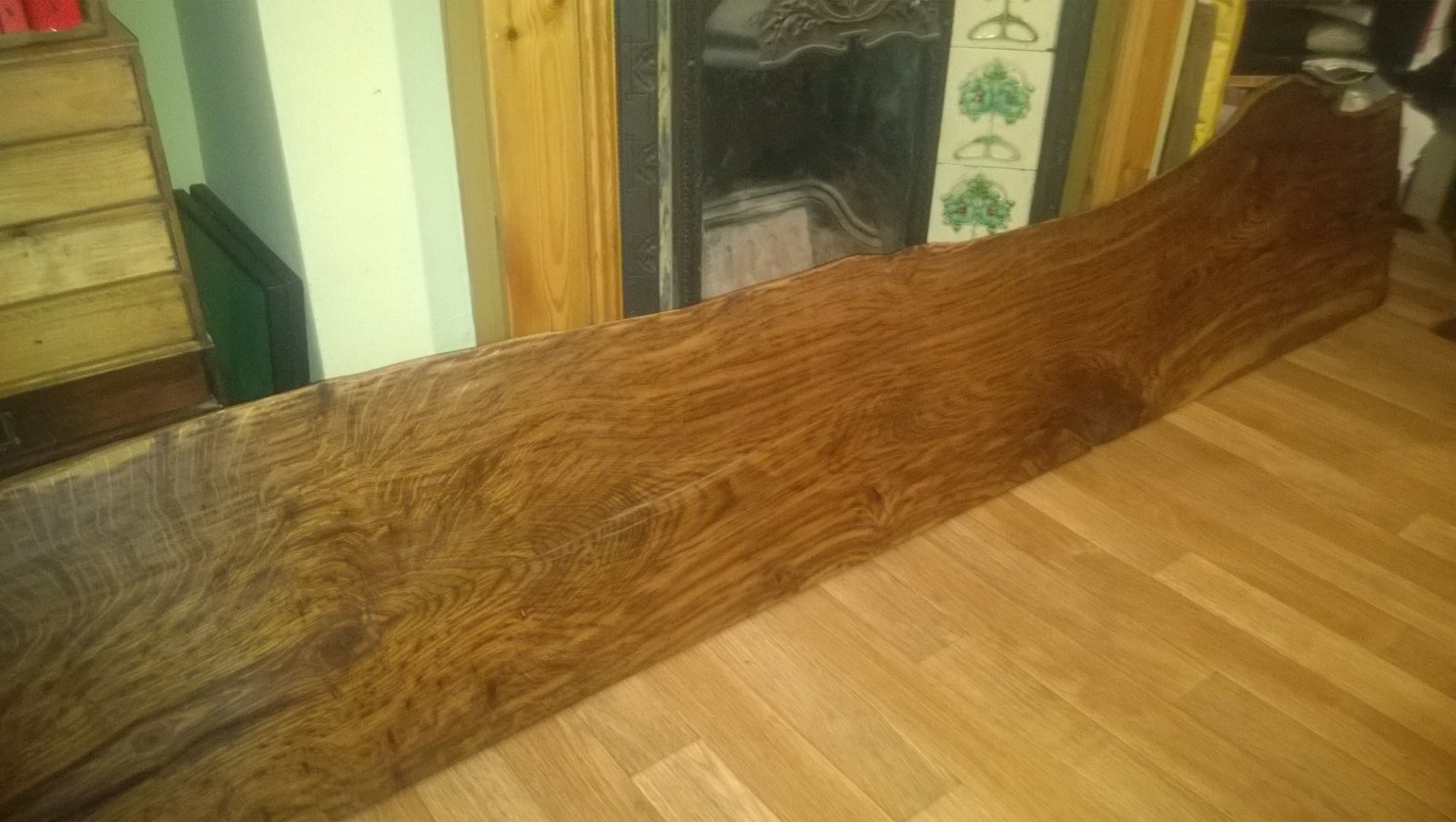

I have a 2.5 metre x .5 m x 19 mm plank of oak I want to fix to an old lathe and plaster wall. It is a total of 11.5 kg in weight. I can drill in 4cm until I hit something solid. I would think Molly Bolts but I prefer not to have the white screw fitting showing on the surface as I guess I would have to use at least 10 bolts.
I would prefer a brass screw or even a hexagonal head I could tighted with a spanner if that is possible with any alternatives. It is a great lump of wood.
I would also be grateful for advice from professionals on which fitting to use. Are Molly Bolts the best, considering the wall and the weight ? The wall could be up to 100 years old and I would think tend to crumble easily.

the laths are pretty certain to be nailed to vertical studs. You can screw through the plaster into the studs. You may be able to locate them by tapping or looking across the face of the wall while holding a torch.

Its not a shelf I just want to screw it to the wall to match a wood and steel staircase I made (not the steel bit) so I would think the same method would work. Not sure the screws into wood after the 4cm of plaster and a gap would old the 11k though
Umbrella fixings (Molly fixings) are designed for smooth plasterboard, not lath and plaster, which is very uneven at the back because if the "snots", so they tend not to give a reliable fix. They can also damage the snots causing minor cavitation of the plaster as well as the "claws" at the front of the fixings not biting firmly into the softer and more durable lime plaster. As John says, fix to the existing studs. A couple of 5.0mm steel wood screws are capable of supporting a man's weight. That's a bit more than 12kg. If you'd ever ripped out lime plaster lath you'd appreciate just how heavy that is, too.

the studs will be at something like 600mm centres, so you can screw into quite a few of them to spread the load. If you countersink the screw holes a little the heads will be below the surface and not obtrusive. You can use brass-plated ones, but not solid brass as they are weaker than steel. If you wanted an invisible fixing you could screw a French Cleat to the wall, and another to the back of the board.

Could be 16in (406mm) centres, John. As to strength, if you can hang a 100kg door on 12 no. 4.0 x 38mm screws, in sure that 6 no. 5.0 x 75mm brass or (better,) stainless steel screws will carry the weight. Stainless or brass are preferable to steel when fixing oak

Regardless of where the masonry wall behind is, if it is laths and plaster there will be studs supporting the laths (due to the massive number of tacks required to fix the laths in place onto any surface and the fact that you can't nail into solid masonry, lath needs to be fixed onto studs) - and it is the studs you need to find and fix through into NOT the masonry wall behind it. Good grief, if we had to fix to the masonry behind this type of infill every time it would be impossible to ever get any work done in listed buildings (and it's difficult enough as it is)! A minimum of THREE 5.0mm (or #10) x 100mm (or 4in) screws into brick stud will easily cope with the relatively small weight you are trying to hold up.
"it is the studs you need to find and fix through into NOT the masonry wall behind it." So about three/four 5mm x 100mm steel screws into the wooden studs will hold it OK . Great
