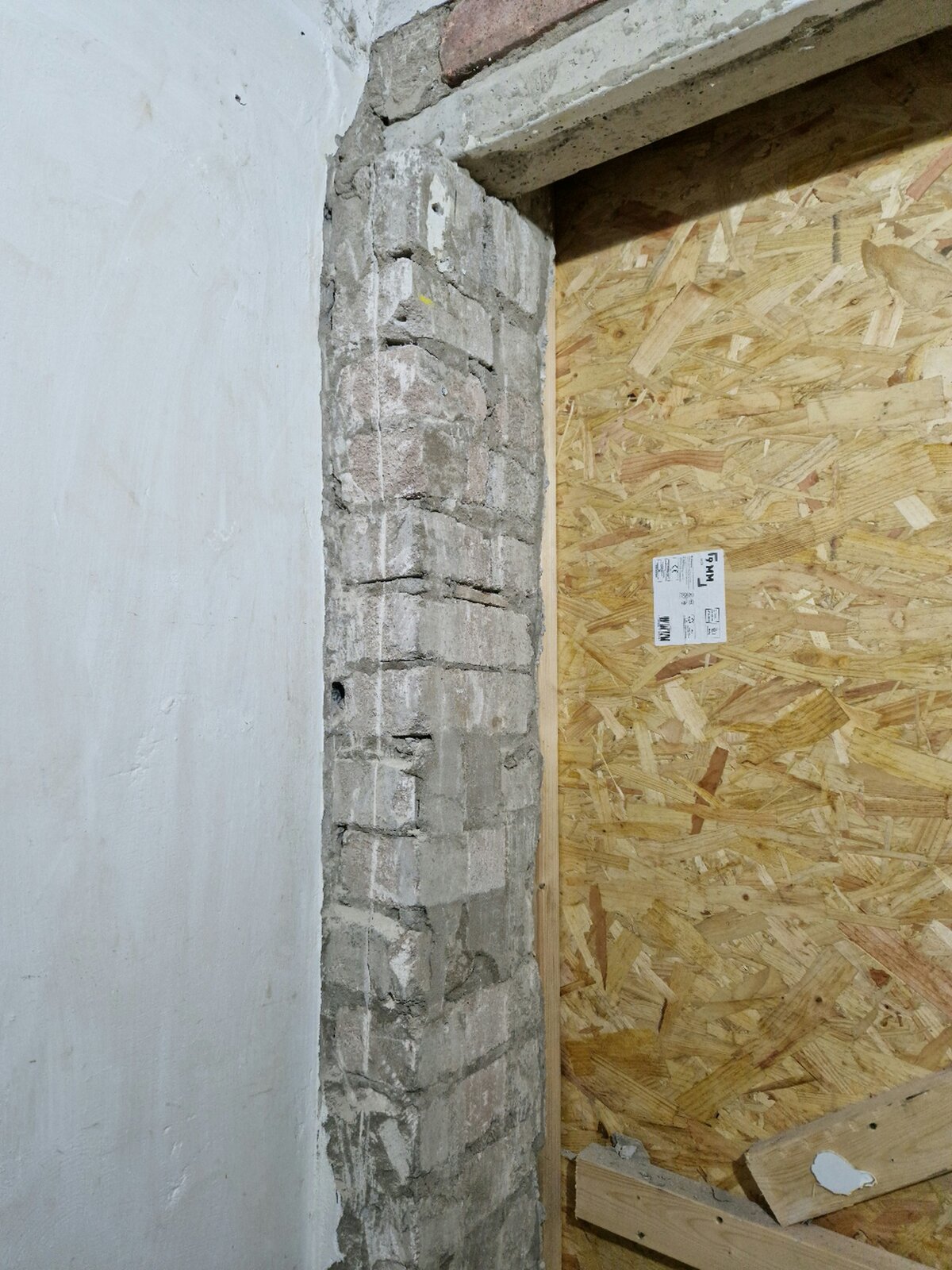

Hello,
I am installing an roller garage door on the inside face.
I am having to build a frame out because the existing lintel is set back and the sides for the runners are not plumb.
So I am using a fence post 100mm x 100mm 2.5 m
My question is what fixing is best used to fix into the existing concrete lintel and brick.
I have attached an image

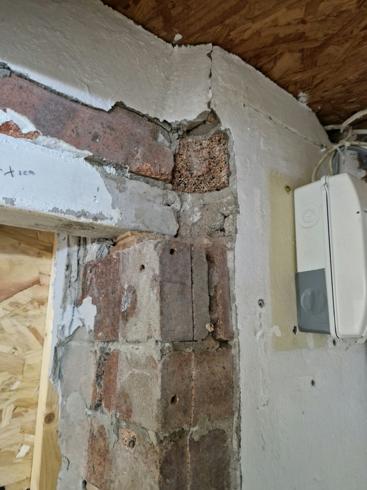

Resin anchors or concrete bolts to fix into masonry/concrete.
That lintel looks like a right bodge job - why is it supported on a piece of timber at one end?
Thanks I've never used Resin anchors before.
So not sure how easy they are ti install.
Concrete bolts would be easier, what size would you use?
Yes the lintel has been thrown in before we owned the property.
And yes wood at one end supporting

I'd be a bit concerned fitting a roller shutter to that lintel, especially when it's spaced off with a chunk of timber and with that constant turning force every time the shutter goes up or down, not like there's much masonry above pushing it down.

To me that all looks a bit unstable and could do with a bit of attention. If the new beam is sitting inside on the piers I would use an 8x2 (fence posts aren't structural timber), coach bolted through the mortar joint between lintel and brickwork above. Trying to drill a precast lintel could crack it or you could hit rebar. With the money you save on not buying resin you could empty a few tubes of no nails onto the timber before you bolt it up against the masonry, this will bond it all together.
