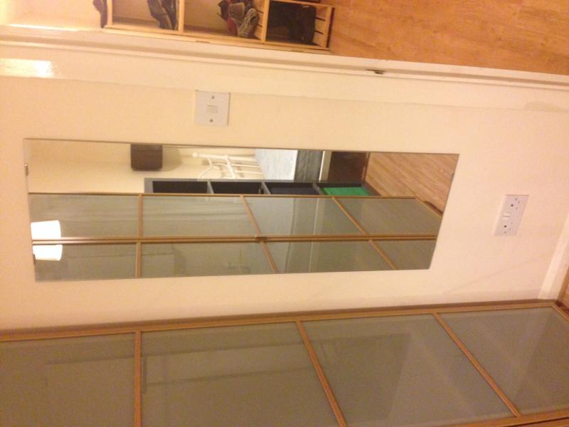

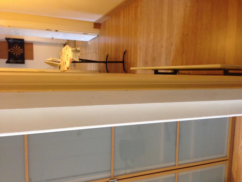

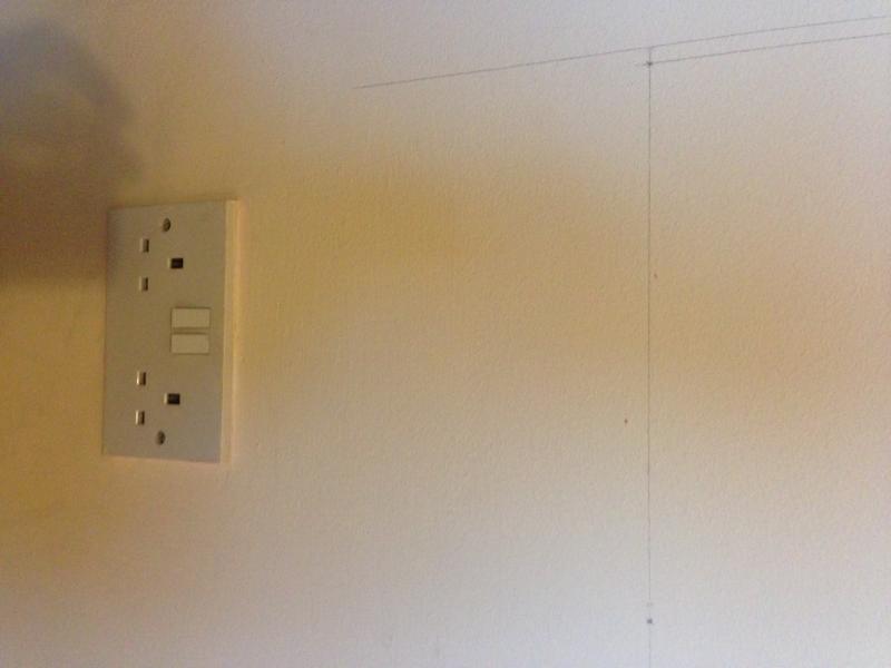

Hi, this is probably a simple solution but as a novice I just wanted to make sure. I'm hoping to fit a mirror to the wall in the pictures below, it is a dividing wall between a bedroom and my hallway. Photo 1 is where I want to fix the mirror, photo 2 is the middle between the 2 sides and photo 3 is the other side of the wall where you'll see there is a radiator which is my concern, as well as a mains socket on the side underneath where I want the mirror to go. The mirror is 48" high.
I have a joist detector and have used it on the wall in the areas where I want the screws to go into the wall and it is coming back with some beeps but I really don't know what to think of it. I assume that the pipes from the radiator go under the floor boards and the same with the electricity.
I'm looking for some advice, is it safe to go ahead and screw into the wall or not?

The unintuitively named 'safe zone' means its where cables can be run. Directly up, down, or sideways from a socket generally. Pipes you can see going down to the floor void.
Okay, so how far above the socket do you think I need to fix the mirror to be safe.
Picture an imaginary line running from the socket to the ceiling, the line being the width of the socket. That is where the cable might be, so do not drill or screw into that area.

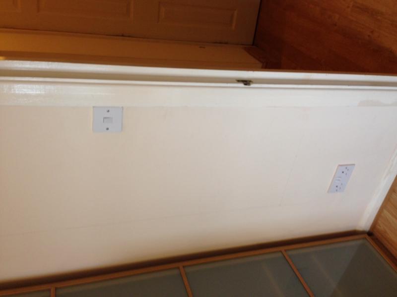

Okay of you look at the image below you'll see the small x's where I intend to drill the holes, do you think this is safe?
As long as they are ethier side of the socket (and the cables have been correctly installed) you will,be fine.
