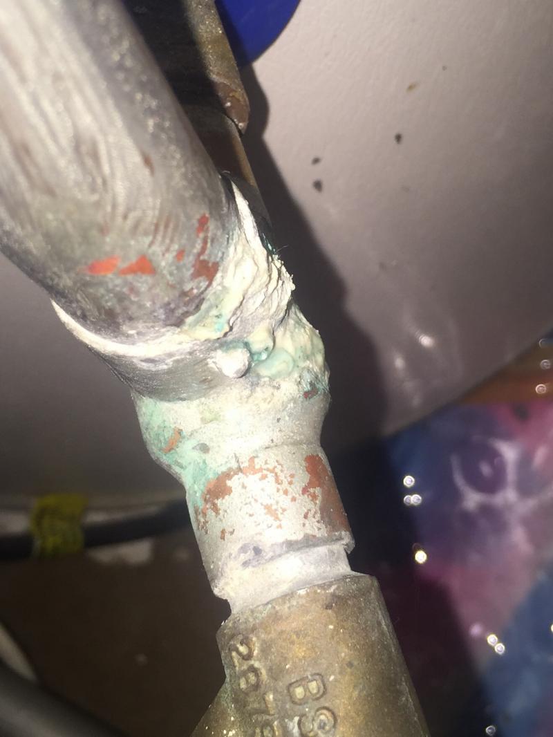

Would epoxy putty be suitable for this tiny leak?
I only get a few beads of water but I was thinking of cleaning up the pipe and applying some of this putty.
Sound ok? It's a mains feed to dhw cyclinder.
You could try but would need to depressurise for enough time to allow it to set.
However I would never recommend using anything like that on mains water pipes!
