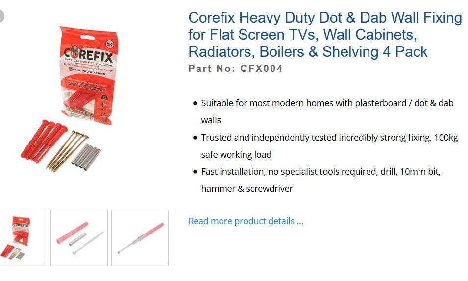

yes and if you can fit to a dab area all the better, if not squirt something behind the plasterboard to keep the strength.
Another option is cut out an area of plasterboard and screw some timber directly to the wall, then fix to that. I did that for kitchen cabinets where accuracy was more important, but for a radiator noone is going to notice a bit of out of line.
https://heatingpartswarehouse.co.uk...WBdF8rykmBDENZBOaq-BnFk6_8Y4EOjgaArQPEALw_wcB
