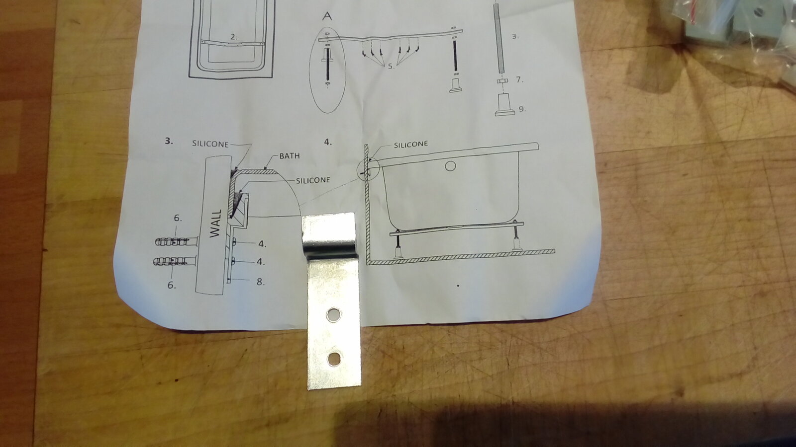

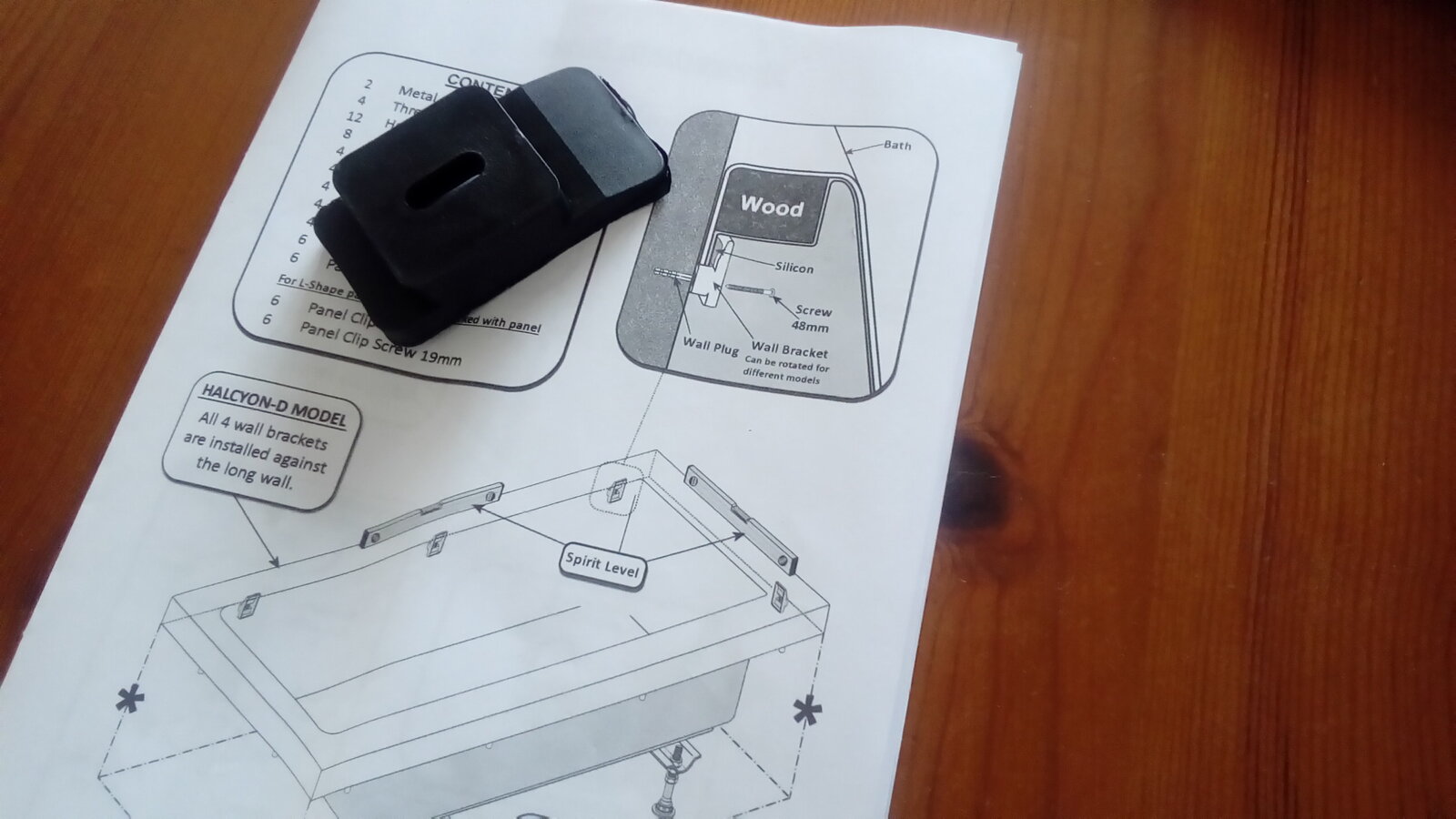

The 4 supplied fixing brackets are quite minimal; fixed to the wall, with silicon bonding bath to bracket.
There are 3 strengthening blocks moulded in to the underside of the rim (plus 1 in each corner) connecting the downstanding rim to the top of the bath sides. Are they just for strengthening, or fixing a support frame to? There is no tubular cradle supplied, just 2 light galvanised channels with feet on threaded bar, to fix underneath.
Is the pair of channels on feet now considered largey sufficient to support the bath, with no runners or batten frame required under the rims of each long side?

Depends on the quallity of bath but if channels came with it and you follow directions it should be ok. My bath has channel , fully encapsulated baseboard and brackets but I still CT1 bonded it to battons fixed to the walls

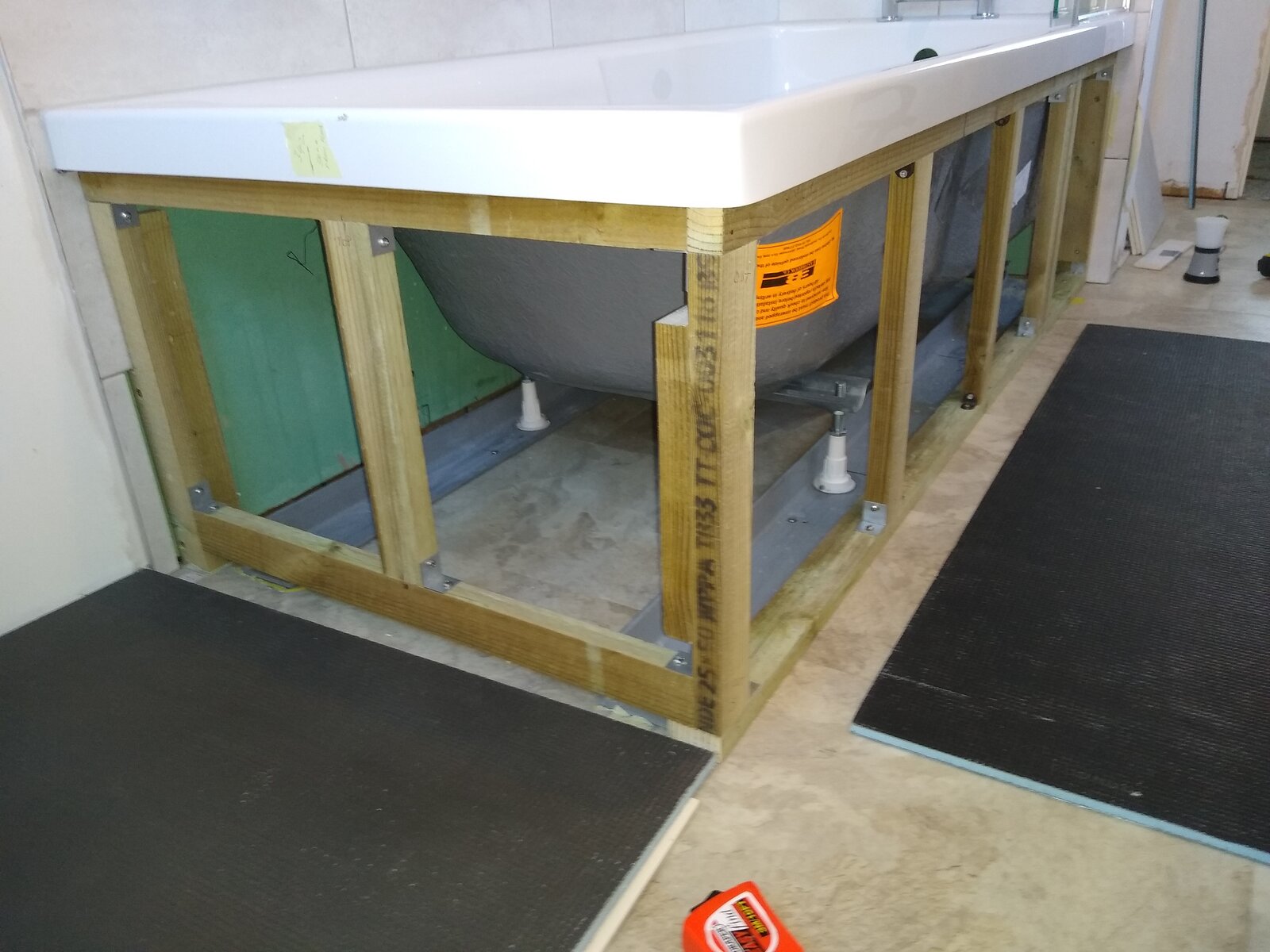

To make the bath as sturdy as possible and to ensure the edge seals properly and lasts, you want to support it along any full lengths of the edges of the bath that touches a wall and ideally a frame at the front/open ends or at least the corners.
I always use batons on the wall and add batons to the inside edges of the bath if it doesn't have them.
Something like:
Something like:
That'll do nicely, it means that no matter where weight is put on it it (say getting in and out the bath) isn't going to flex and break things like the seal against the wall. Not so important on a metal bath of course as they don't tend to flex as much as acrylic do.

Is that full length rail up under the rim supporting the rim underside continuously? Or supporting moulded in blocks like mine has?

Is the wall long side of the bath rim similarly supported, with the custom timber frame also up under the rim?
Asking because the supplied wall brackets are slotted...vertically! FFS.

I don't use those plastic supports, I throw them away all the time.
The primary support for an acrylic bath is always anywhere it touches a wall. Batons secured to the wall are placed under the rims so the bath edge 'just about' sits on it when levelled. Then run a good bead of silicone along the baton where the bath edge will sit and another bead along the 'clean and dust free' wall where the side of the bath will touch it, paying more attention to the long and the short edges where the shower will run if there's to be one. Lift and push the bath onto the silicon, push and press down, there should be enough silicone applied to squeeze out all along contact edges, clean and smooth the silicon along the top edge to give and that's the first seal, 1 along the bottom and 1 along the wall. Check levels again. Fill the bath up to the overflow with water, and leave at least 12hrs.
The framing in the pic is extra to provide full support for the open 2 sides of the bath and the best you can provide. If the bath has 2 open edges, as if you place weight on the front or open corner, it will pull that area down and the unsupported edge(s) at right angles to it putting force upon the seal. If the bath has only the front long edge open then it's not needed so much as both bath short edges are support so there little or no corner flexing.
So an "open side" is one where a panel will be fitted and therefore support framing needs to be recessed up under the rim, allowing space along the outside for panels.
