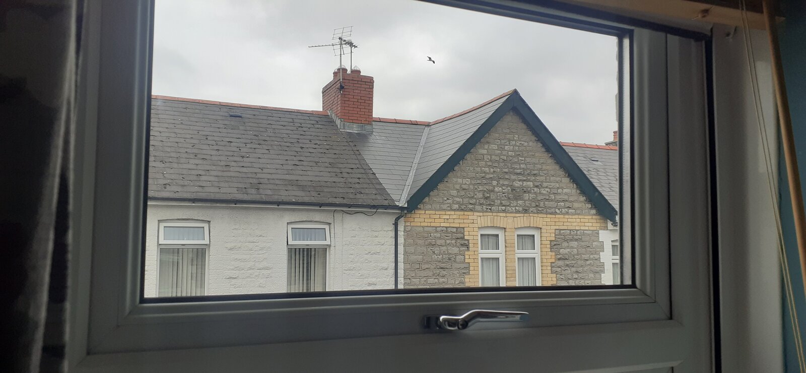

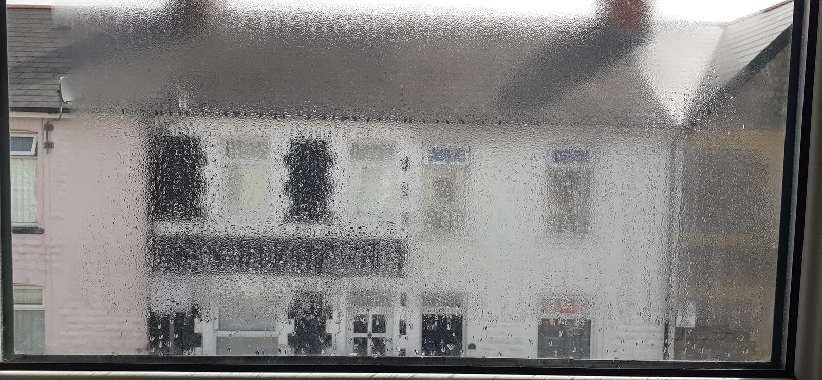

I've been meaning to attempt this for a while, but spurred on by @creamola's 'pioneering' attitude, here goes...
I have a small unit that's blown, it wouldn't be expensive to replace, but I thought it would be worth an experimental fix.
It's about 19 years old and has no coatings.

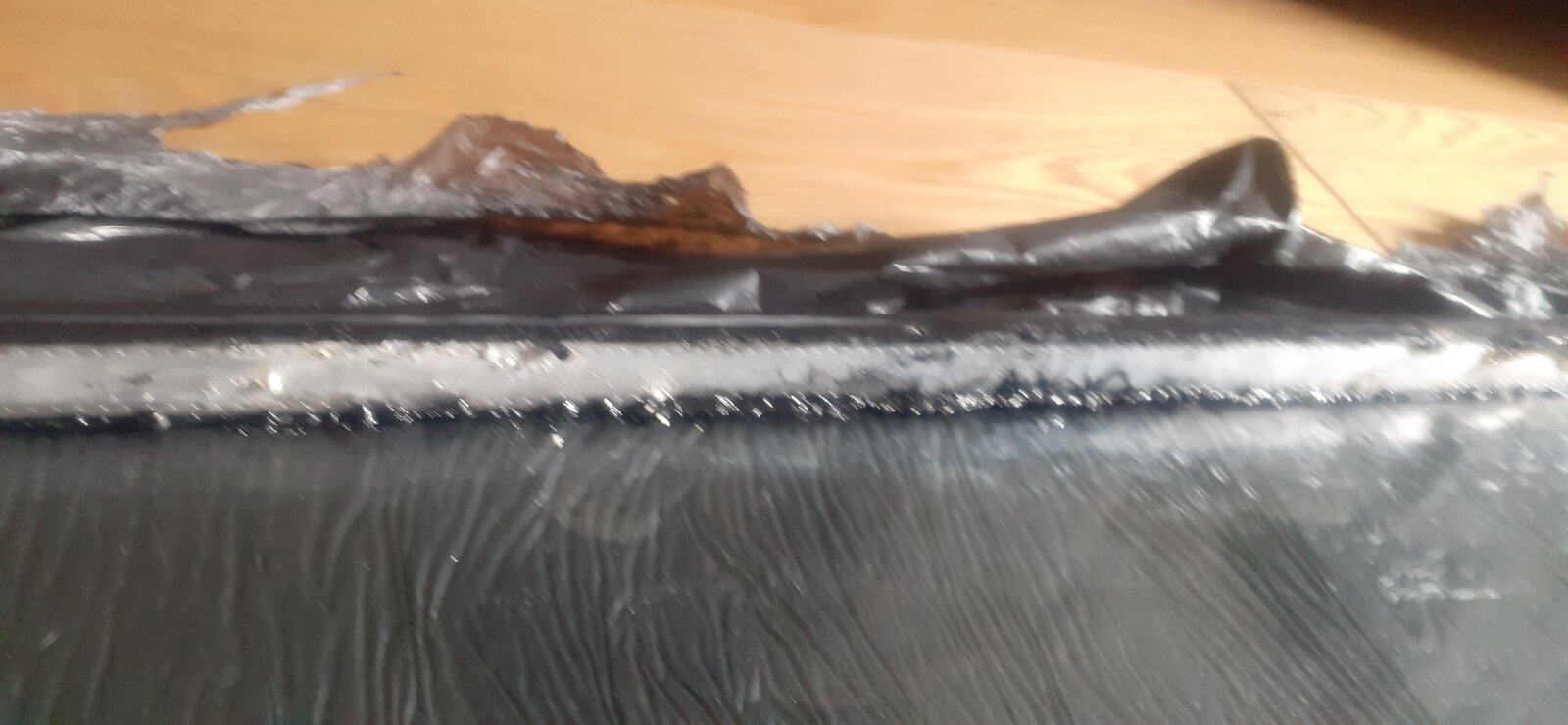

Then separated the spacer bars with a paint scraper - the lower seal was the damaged one and came apart surprisingly easily.
Not a good photo, but the lower spacer bar was a mess...

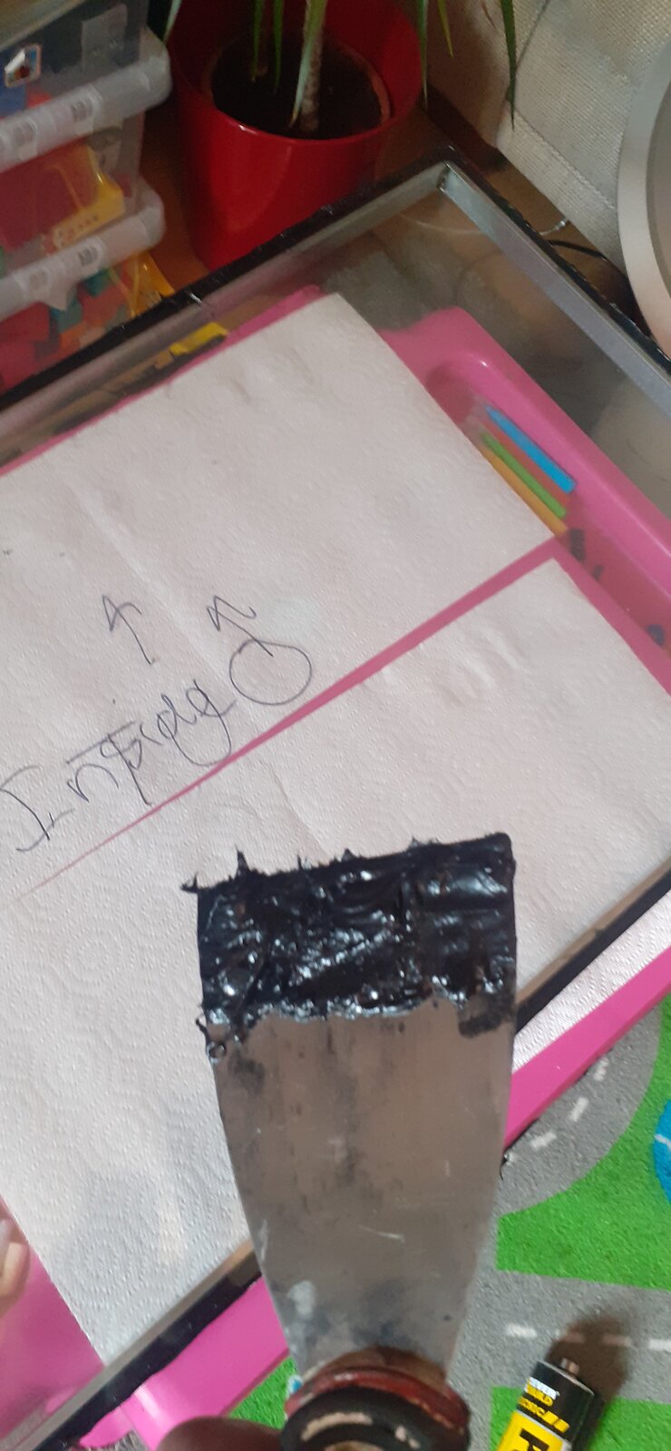

Once separated, the sealant was sliced away from the rear of the spacer bar.

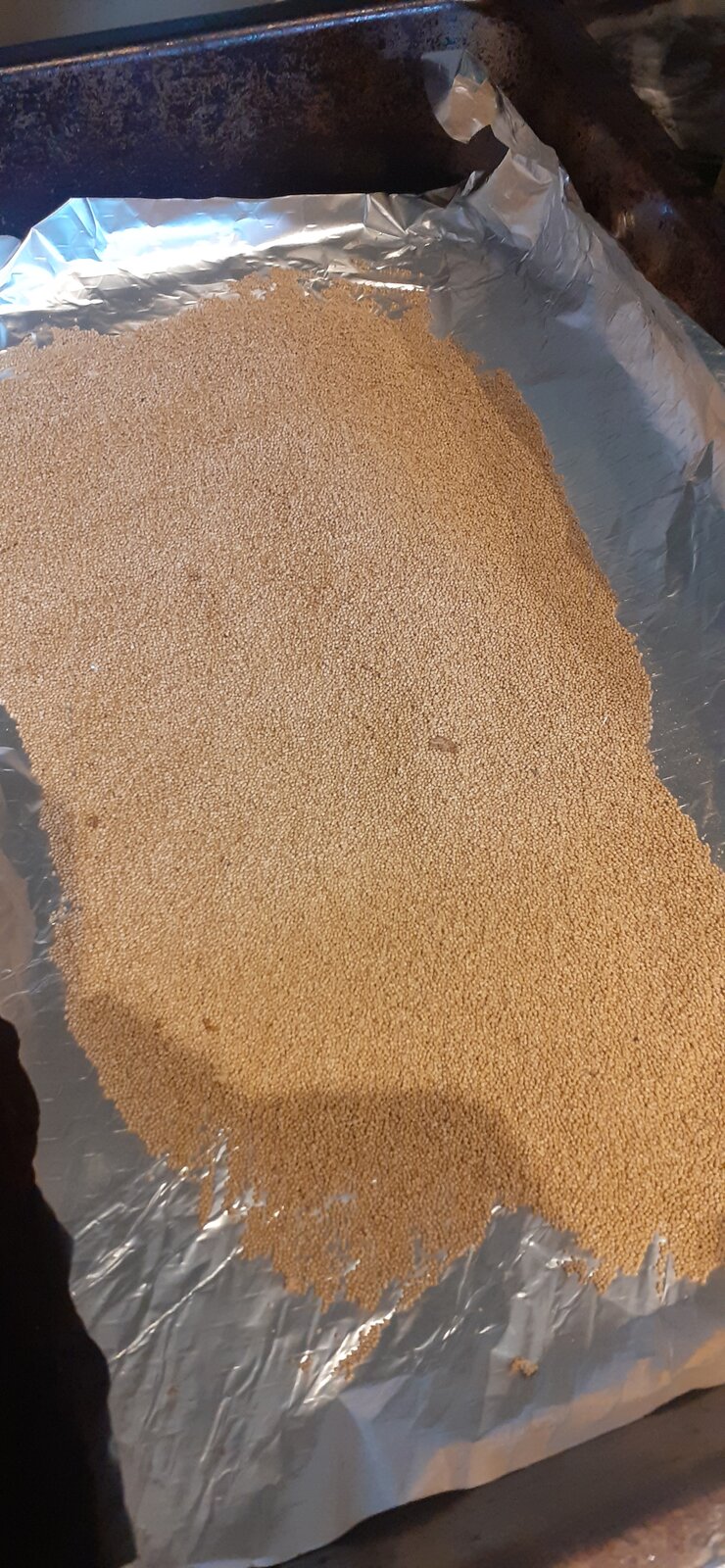

The bar was pulled apart and the saturated desiccant was knocked out - 100 degrees for an hour and all dry...

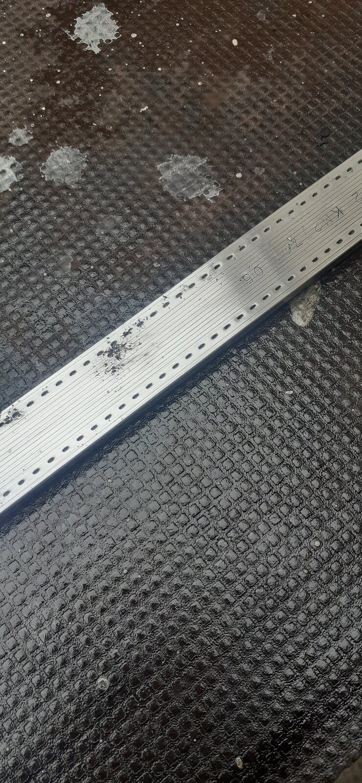

In the meantime, all the old sealant was scraped off with a Stanley blade scraper and WD40, a spray of IPA afterwards cleaned up the WD40.
This was a long and very messy job.
The spacer bar was polished up, but it was pockmarked with aluminium corrosion - the new seal may not be perfect.

Well done for attempting it ... needs to be pointed out that the sealant in an old unit like that will be different to modern sealants and they can be very tricky to get apart and the unit can easily be broken with too much force and you can easily slip with a stanley blade and cut yourself.
Did you reuse the dessicant? If so did you heat it in the oven gently to dry it out?
Yes, the unit was treated tentatively - I used a scraper to "saw" away at the sealant, with the blade facing away from me at all times.
The failed bottom edge almost split away by itself, but the top and sides required more effort to separate.
Yes, it was gently dried out in the oven for an hour. The colour and consistency was decent afterwards, although not quite as much desiccant went back in, as came out!
