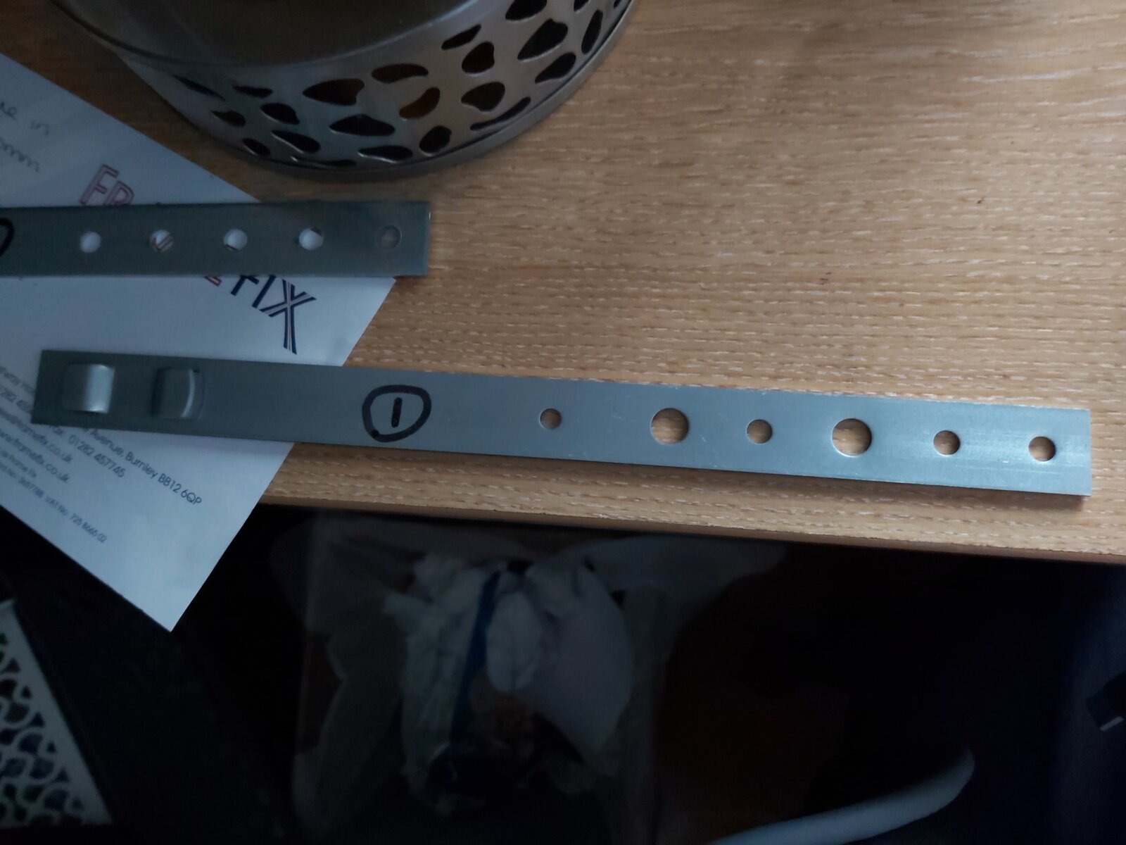

I have had a bunch of PVC windows delivered today, their frames have grooves and from what I know window fitters have those fixing brackets (cleats?) which you twist and lock on the frame and the cleats then stick out the back and you screw them into the wall. I have attached a photo of the windows and those fixing brackets.
I need to buy plenty of these brackets, does anyone know what they look like and where from? The window manufacturer rather unhelpfully told me it is not their job to make them, or even tell me where to buy them from.

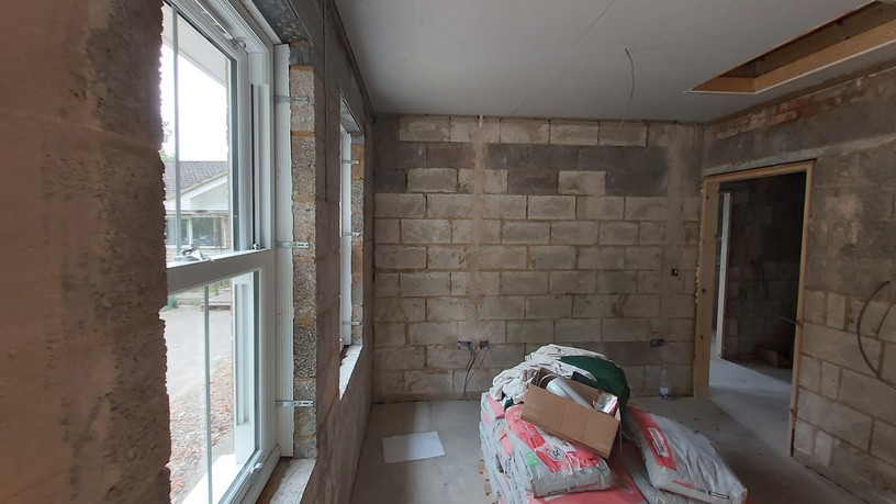

My walls are 7.2Nt blocks. The manufacturer only suggests chemical fixings. What screws/plugs/system should I use on the cleats?
Further advice needed please:
I have got the fixing plates (a sample) which have a pre-drilled hole at 7.5mm (maybe 8mm), and the frame fixing screws are 10mm. I cannot drill with a 10mm bit, or push the screw plug into the blockwork through the pre-drilled holes.
My options are:
1. Use smaller diameter screws and plugs that will pass through the pre-drilled holes or even use self-tapping screws directly into the block
2. Mark the exact spots, remove the fixing cleat (somehow move out of the way), drill hole, insert plug
3. Widen the pre-drilled holes (which is laborious)
How do others do this?
I bought the 10mm Fischers with plugs. If I use self-tapping screws they will eventually work themselves loose.
These are the best anchors I can use, short of chemically bonded bolts (which we have used for timber plates into blocks).
There not the best anchors available if they don't fit,
Self drill screws and expanding foam are used all the time and no one has problems with windows coming loose and falling out.
As said I'd use concrete screws unless it's going into thermal it's then an anchor like you have is better, concrete breeze blocks then plug less concrete screws all day long
OK thanks for all suggestions. I still have not found the right strap that will fit my window frame profile though...
If using ' concrete ' fixers you don't need the straps. Drill through the frame ( and possible reinforcing) then drill into wall for concrete fixings. That's how majority of replacement windows are fixed
