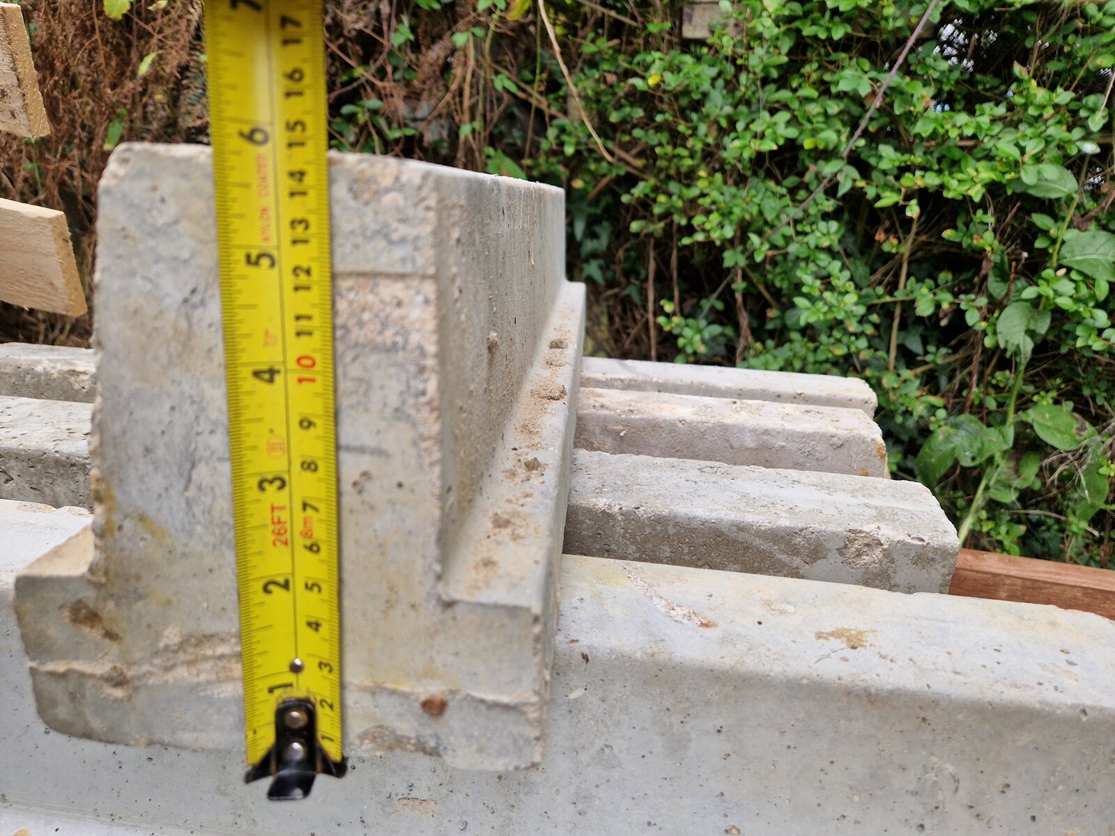

Morning all - bit of a random question here but I've got a greenhouse that is sat on a base of scavenged offcuts of pre-stressed concrete beams. Lengths are ~650mm- 900mmIts on an allotment so the obvious poured concrete base/foundation is a no-go.
I've got them all set and levelled, the greenhouse frame is now on top and the glass going in. I have put in a couple of fixings to stop it literally blowing away (live near the coast!) but on using brown rawlplugs (7mm hole) it has caused the side of the beam to blow out a bit (although the anchor still seems to be holding. I had to drill off centre to avoid the reinforcing bar in the beam.
What's peoples views on an alternative fixing - I'm thinking either:
1) Concrete screws - am i right in thinking they don't put as much expansive force on the material as the threads cut into the concrete?
2) Chemical fixing - obviously this would work but is probably overkill and ££
Resin is the way to go. All you need is some 5mm studding cut to length (I'd go stainless) and some nuts and bolts. Make sure the resin you get will fit a standard mastic gun. I would also use a nylon washer to separate steel from ally.

Fix in the beam centre with say 50mm concrete screws. Job done. The screw heads may benefit from a washer.
As above, j-bolts, road pins hammered in, or what about these sheet roofing bolts?
Putting more holes in them will weaken their longevity.
It's a support for a greenhouse, lol. Putting a few holes in them won't amount to jack.
A few concrete screws with Form A washers will be fine. Quick and easy.

I'd be more worried about the things just falling apart when drilled into, they can be pretty brittle.
Those j-bolts linked above look good.

Be aware that using fixings that are not aluminium, and winding them in such that they contact the alu will promote galvanic corrosion. Use some electrically insulating spacer (eg a plastic washer) between the alu frame and the non alu fixing if you go this route
