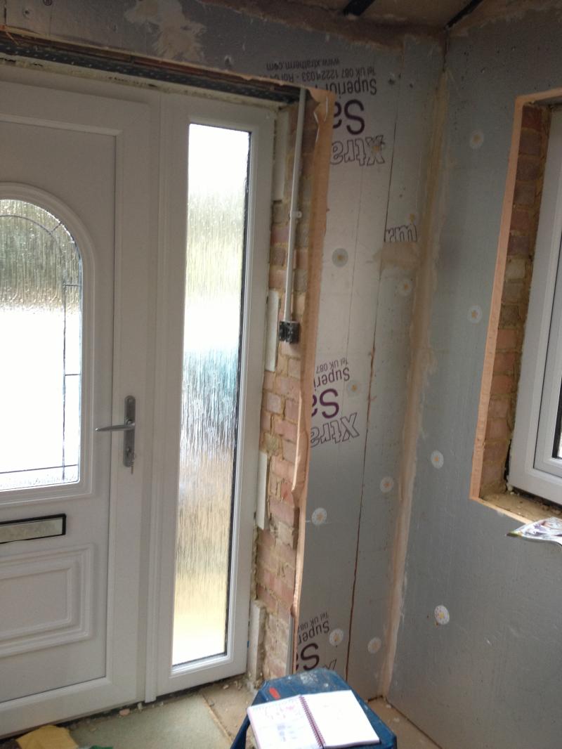

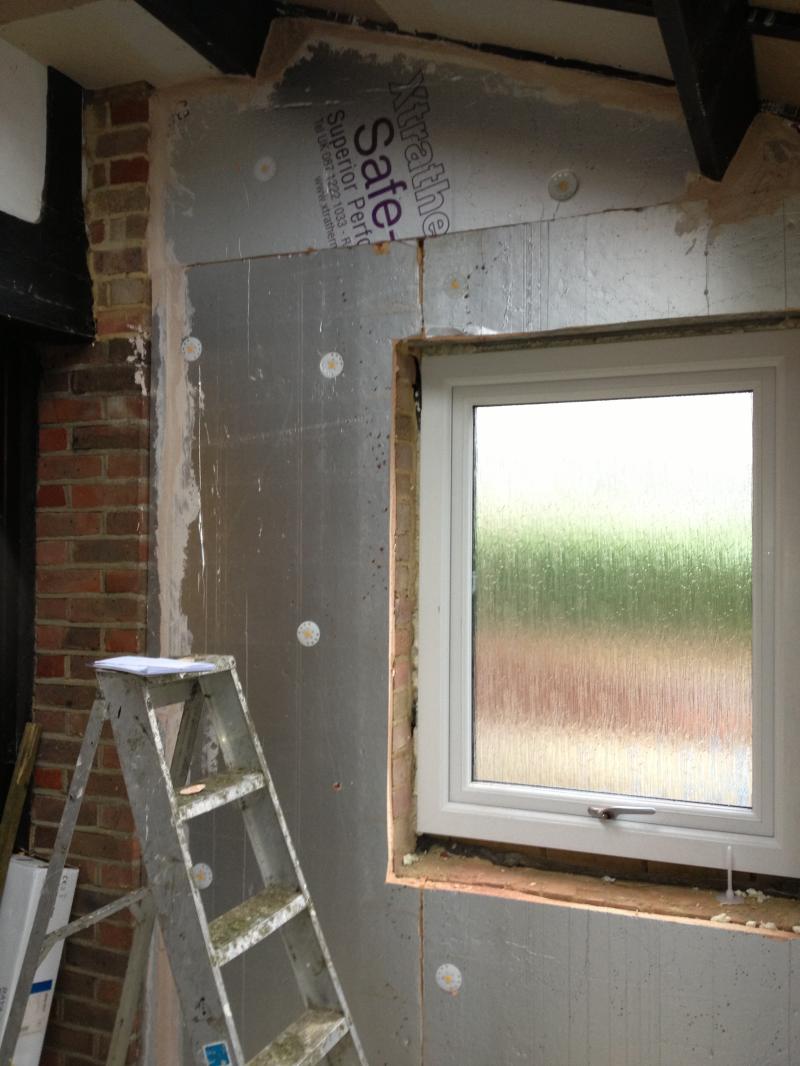

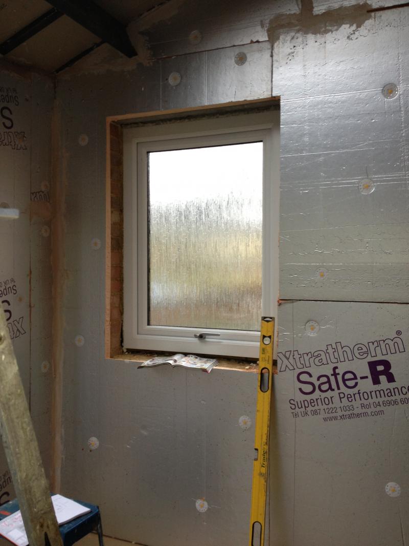

Guys can you help, i have been asked to give a quote to finish off work on a small lobby entrance to a house. The owner of the house is a bricklayer and he has fixed the celotex/kingspan to the brickwork with mushroom fixings and has foamed it in other places. Now he is asking me to Bluclad or plasterboard his lobby area.
Now in my view there is no solid grounds for which to fix blue clad board or plasterboard to? The guy says it would be fine to fix the blue clad with longer fixings right through the celotex into the wall. This i feel is the total incorrect way of doing so... so i am thinking of ways around it? can i battern over the top of celotex with fixings through batten, celotex then wall? or do i just tell him to that i must remove the celotex fix some grounds and insulate between?
I know why the guy has tryed to do this, because he has tried to get maxium u-value but the way he wants to go about it, cant be guaranteed....can it?
Thanks for your help in advance..
I will try and add a photo...
You can stick it on with expanding foam as long as his insulation is well fixed on , idealy you will need those expanding poles to hold it in place for 20 mins or so till it goes off, you can also put 100mm plaster board screws in if you know were the batons underneath are located.
So sticking plasterboard with foam to foil is secure enough??? The is no battens underneath.
The plasterboard will bond to the insulation very well, but obviously that will not be much good if the insulation falls of the wall.

Why dont you get some timber the same thickness as the insulation and cut out the insulation and fix the timber to the block wall at equal spaces to fix your P/board to.You could then staple some building paper over it or just put DPC over your timber before boarding it so that nothing "tracks " back from blockwork to plaster board...
