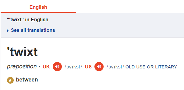

Use a flexible twixt pipe and cistern. Add a check valve if there is not one.
Can I join the cc forum now? :ROFLMAO::ROFLMAO::ROFLMAO::ROFLMAO::ROFLMAO:
Whats a twixt pipe and why would you fit a check valve?
