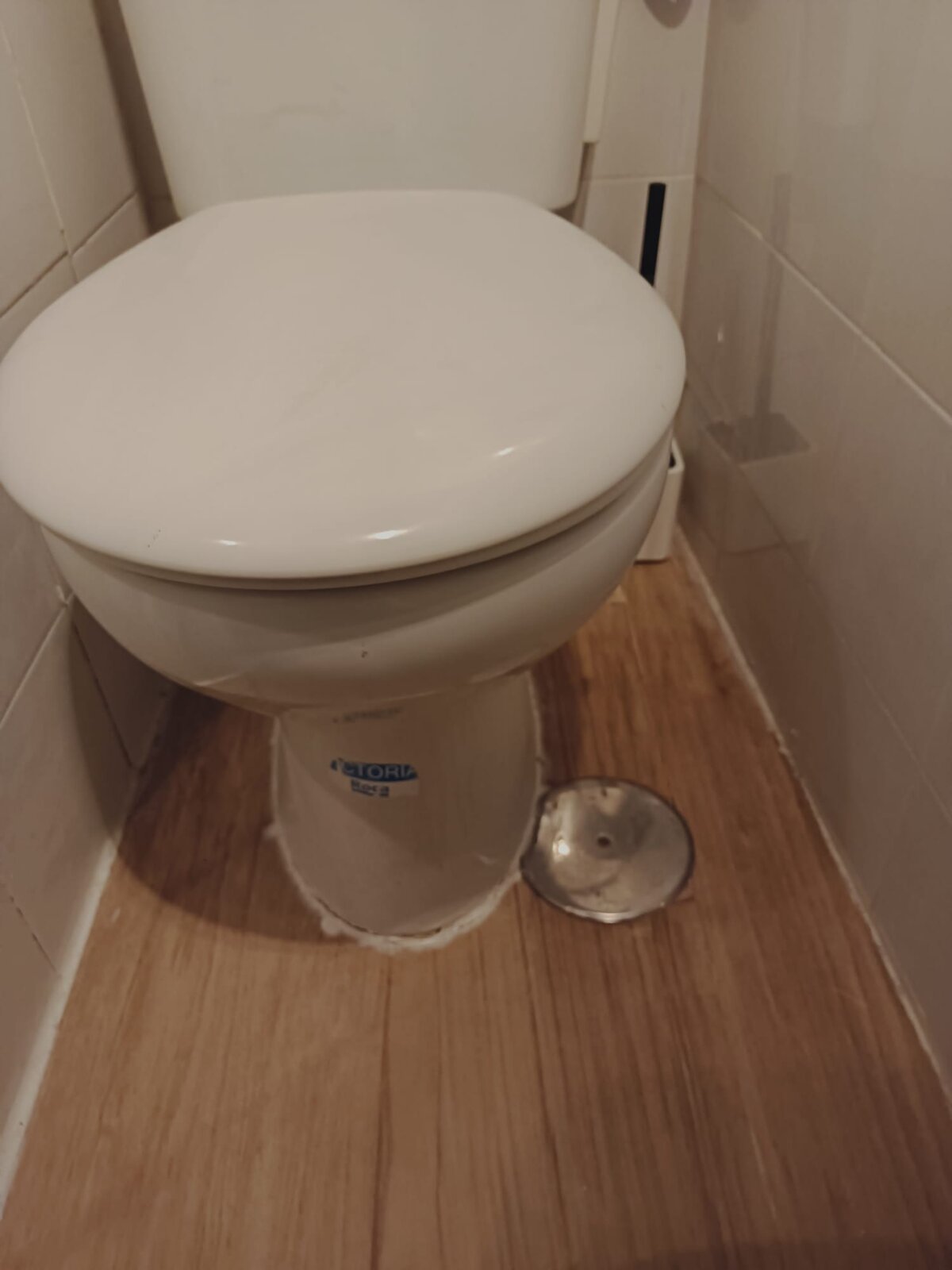

Christmas week, we had a man in to put down a wood effect tiled floor in our WC. It was the 22nd when he started but it was a small room so I figured he could get it done in a day. He agreed, and said a few hours would be enough.
As always happens, he didn’t finish it on the 22nd and he said he’d be back on the 23rd to finish the job.
I explained to him that we had guests coming for Christmas and that our other WC is one of the old ones and the flush isn’t as powerful and that we REALLY need this room finished for Christmas. He guaranteed us that he’d finish on the 23rd.
Needless to say he didn’t turn up on the 23rd and we had an argument on the phone.
To cut a long story short, he came back on the 27th and finished the job and we paid him and the job looks ok.

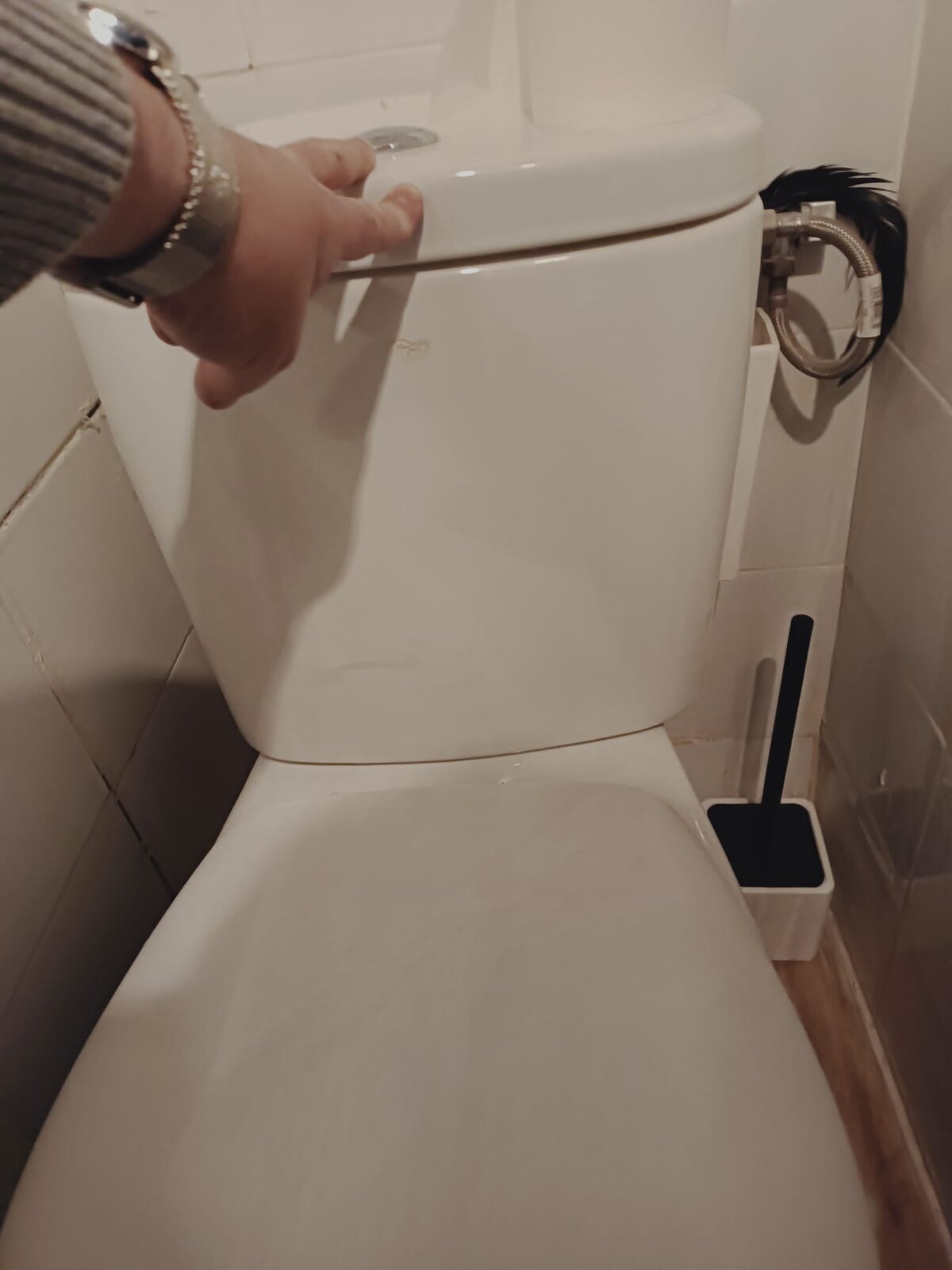

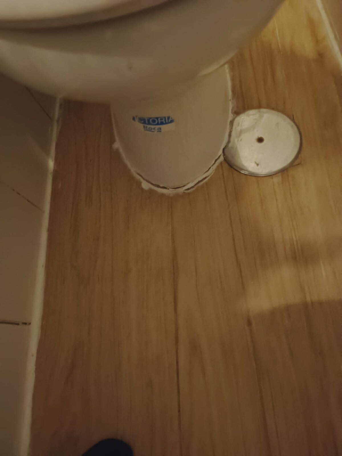

The problem is that the WC itself is not fitted tightly to the floor. It is screwed down to the floor at the back where it is supposed to be but it can be pushed back and when that happens it lifts the front of the WC off the ground. This surely isn’t correct and needs to be fixed. It never moved before. I have no intention of calling this guy up again after the arguments we had over this.
He did put some silicone down underneath the pan as far as I can tell.
Is it a handy fix? Could I do it myself?
Strangely there is a bad smell coming from that room ever since. Would that be caused by the ‘loosely’ sitting WC? Or is there something else he messed up on? I have attached a couple of pictures in case it helps.

1. Tim you should of started a new thread.
2. Was the toilet removed and refitted by the floor layer?
Andy
Thanks guys. I'm not sure if he used a new connector/seal. I suppose I trusted him enough at the time not to observe. Not that I'd know much about that either. And yeah, the toilet was removed and refitted by the tiler. He insisted on fitting the tiles under the toilet rather than cutting around it.
Pan connector looks new. I just had a close look. However, the boxed tiling around the waste tube is broken. Perhaps that is causing the septic tank type smell. Another possibility is the shore/drain cover on the floor in the bathroom. I opened it and because it was tiling on top of tiling, it doesn't sit as tightly to the floor the way it used to. I really think that is where the smell is coming from because it gets stronger when I open the drain. I'm going to silicon any gaps in there and see if that solves the smell issue and if it does, I will also try to silicon the toilet pan to the floor again and hopefully that will be the end of the problem. If I need to open the drain at a later date, I can remove the silicon and then do it again when I'm closing it up. It's the easiest solution I can think of. Does this sound like a good enough plan? Thanks
Have this sorted more or less, apart from the fact that even with the 2 back screws in place the toilet bowl moves. I can clean off the old silicon and go again, but will silicon around the edge of the bowl be enough? Are these toilet bowls flat underneath? If so, I'd also add some silicon in under the bowl, but I don't think they are flat underneath. I don't want to disconnect it all again given that the smell is now gone, and the positioning all seems right. :)
Don't use silicon - use a proper grab adhesive like Geocel "Theworks" or CT1
