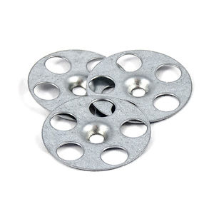

For tiles of a certain size and weight, you have to use a tile backer board such as Aqua panel or wedi, as it has a keyed matrix surface to grip the adhesive and tiles.
To fix this to the dot and dab I would use screws and plugs and the "film reel" type washers you can get from the arch forming section at Wickes (much cheaper than wedi washers) through the plasterboard, into the areas where the dabs are (shouldn't be hard to find with a drill bit) and blobs of gripfill every 350mm centres.

So do you think its okay to put 8mm wedi tile backer board on top of the plasterboard, if we use those washers?

As long as you fix it well, with the washers (they will prevent screws pulling through wedi board) and gripfill it will be fine.
I have bought these from Wickes before, but can't find them on their website. They are usually near the expanded metal mesh and archforming kits!
