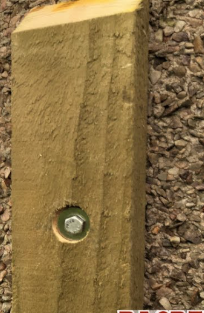

Fix a timber to the garage wall and fix the gate to that. Concrete screws would work but rawl bolts, through bolts or resin anchored threaded bar would be better

Forgot to say, if you're bolting, it looks better and is safer (no sharp edges to catch a shoulder on) if you use a spade bit to partially recess the wood so the nut/bolt is below the surface of the post. Use a washer too
