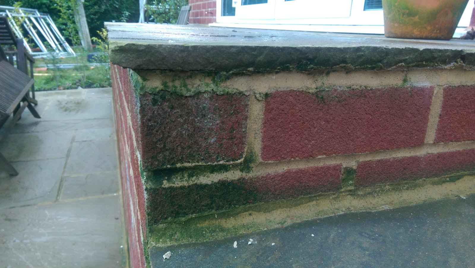

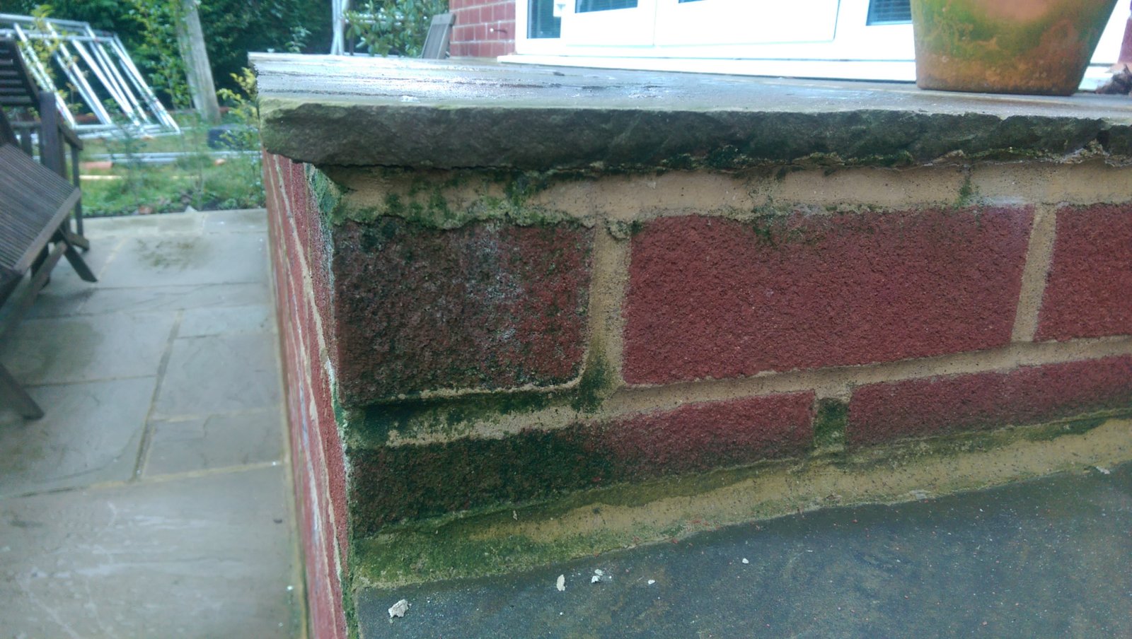

I have attached a photo. There is only a 2cm overhang of the slab over the brick and balustrade will run along the edge on the left hand side of the photo, fixed into the brick through the slab.
Hi
I have attached a photo. There is only a 2cm overhang of the slab over the brick and balustrade will run along the edge on the left hand side of the photo, fixed into the brick through the slab. View attachment 133070
You need to fix into the masonry. I imagine that slab being deeper than that. I'd still consider using chemical fixings or rawl bolts. Rawl bold anchors can cause masonry to crack if over tightened or if the bricks such as those, have been effected by damp.

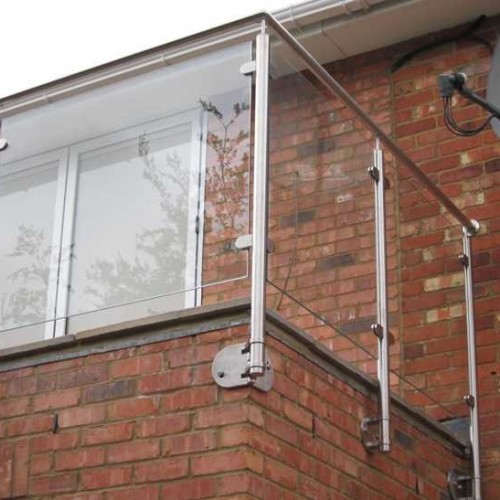

Just to let you know, after further looking around, I'm going to side mount the posts as per photo and fix them using a threaded bar and resin. I think it will be stronger than going vertically down through the brick.
Neither will be ideal in your case. The reason I suggest you stick with the resin fix is because of the type of trick. Those aren't engineering brick so will benefit from the tolerance offered during expansion and contraction from resin, during summer and winter. Not to mention a rawl bolt will struggle to work all that well in a hollow core facing brick, even if it doesn't split it when doing it up.
Under those slabs, is there a lot of concrete? If there's a good bed of concrete under those and behind the brick I'd be tempted to fix them on the flat surface. The corner mount will help alleviate the outward levering force applied to the balustrade when people lean on it. This in turn would be a benefit as it would be much more difficult to pull that rod out of solid concrete than it would out of a facing brick thats acting as a retaining wall for soil or aggregate.
