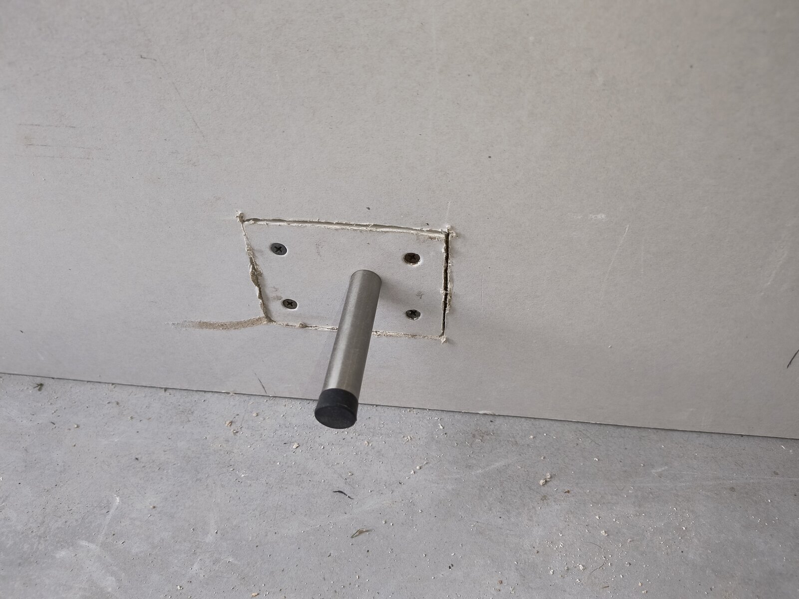

I've got a load to fix, on turbo blocks which are even worse.
I've practiced on a door stop. Cut out a bit of plasterboard, glue (stixall) and screw (4 brown plugs - very carefully tightened, you normally get one go where it will grip) a piece of 18mm plywood, replace plasterboard. Seems pretty secure.
I had to chase a bit of the block out to fit the plywood but easier enough with multi tool.
