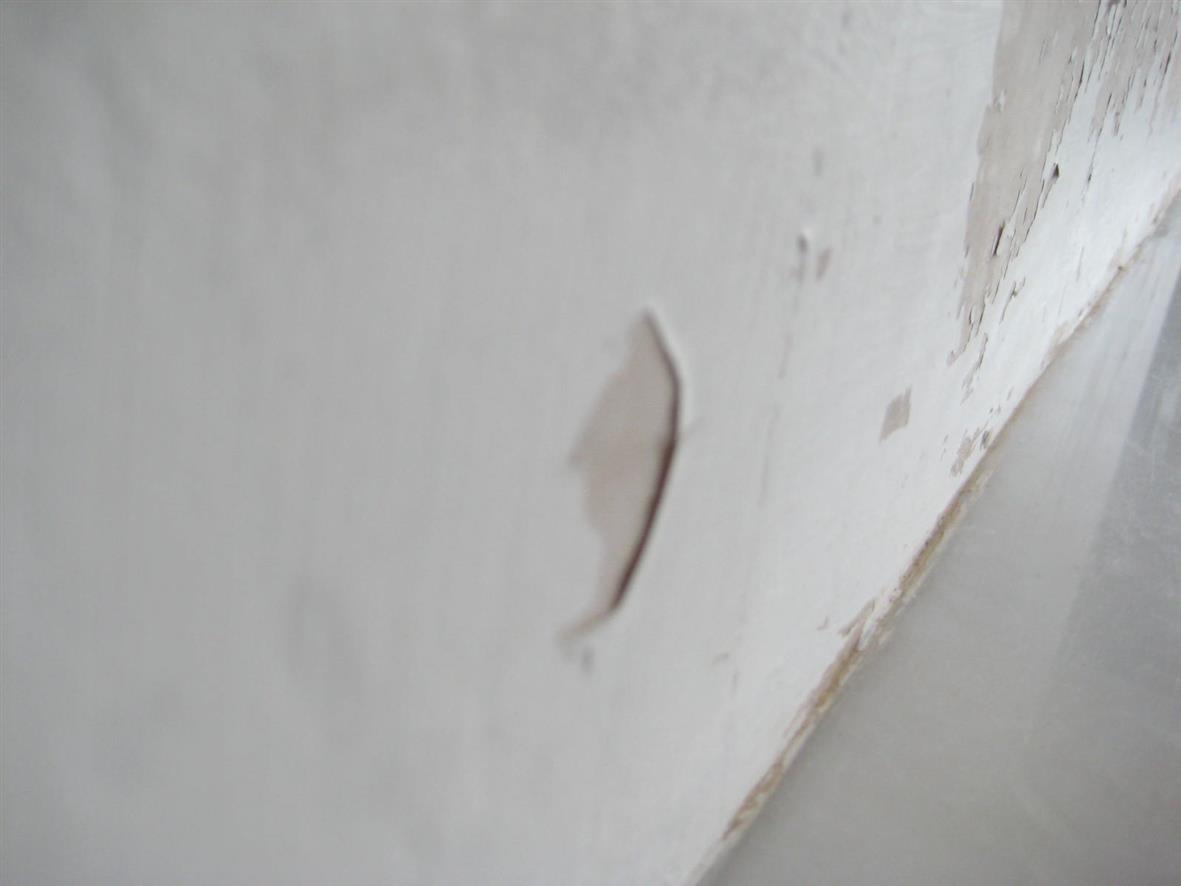

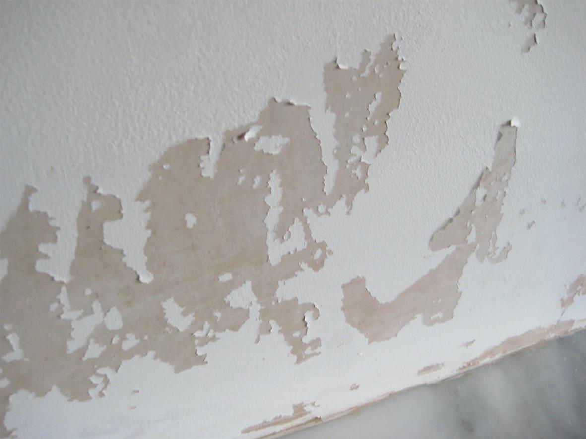

Hi looks like someone has painted thick paint on new plaster (Photo) I've stripped paper off and it's left this mess.
It's in a prominent place above fireplace and dotted around the room.
However the plaster is a good finish and I would prefer to paint rather than paper.
How can I blend / fill this in so I can paint without it being visible?

Sanding, sanding and more sanding.
Or, as I saw it done once, a thick coat of textured masonry paint followed by 2 coats of emulsion.
I've used toupret fine surface filler to hide this. Cannot tell now.
However, your paint looks dimpled/textured, so, unsure how it'll end up, as some bits will be flat, others textured.
Thanks for the help, true about the paint it's not been well applied really.
Think I'll paper.
You will still need to rub it down even if papering, or the paper will have voids in where the flakes are.
