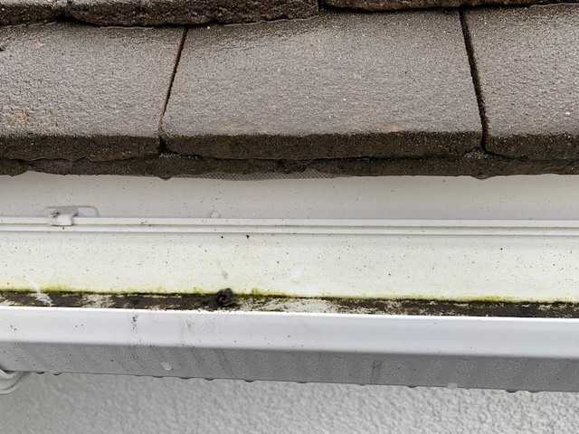

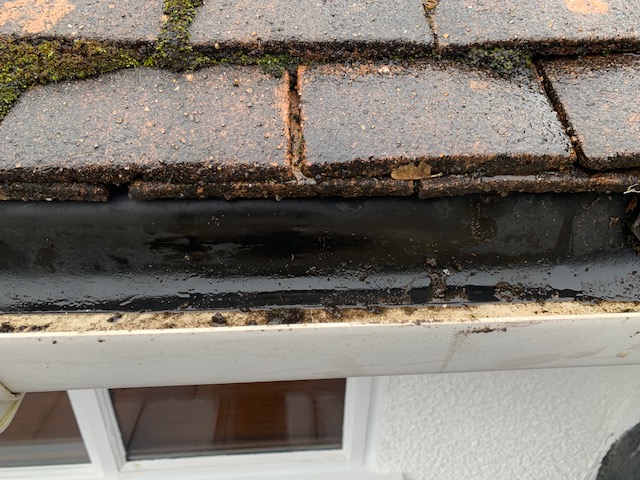

Thanks for reply, just been up on roof as gutter was full of moss and taken some pictures of old roof that been in place 30+ years and the new roof which is about a year old, the old roof has some black material under last tiles and into gutter which I am guessing is like the 5U felt recommended and the new roof just has the gap, I am guessing if I can actually manage to get the roofers back then they will still just want to cut the felt white away so it doesn't flap in wind - in peoples opinion is this an acceptable fix or should I be getting the black felt in there ?
Old roof:
New roof:
I still owe the builder that employed the roofers £800 which not paying until this resolved - any rough stabs at what getting felt in there would cost, would be on three sides each approx 4.5m long so 13.5m in total, would the tiles have to come off or can they poke it up underneath ?
