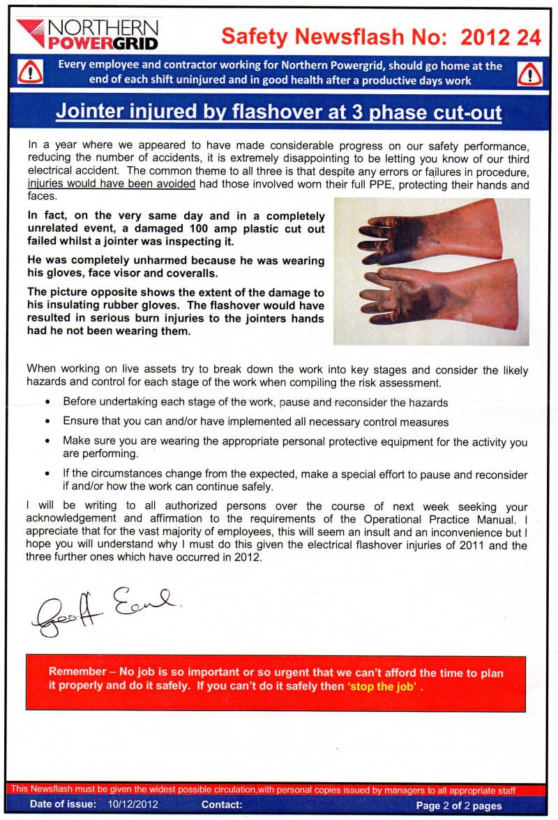

The last photo is the most telling, showing the state of some insulated gloves following the failure of a 100A domestic cut-out

and there has always been little, if any, PPE used (usually none)
And their lies the problem, on the metering side, i could list many factors for not wearing PPE but the most common one is time. More and more companys pay by fit and their seems to be a "throw it on the wall" atitude.
On the DNO side, i must say, almost all wear the PPE.
And their lies the problem, on the metering side, i could list many factors for not wearing PPE but the most common one is time. More and more companys pay by fit and their seems to be a "throw it on the wall" atitude. On the DNO side, i must say, almost all wear the PPE.

I had a DNO bloke out to a failed TN-S a few months back. It was an iron clad cutout, and he pulled the fuse with no PPE at all.
Unfortunately in a lot of employment situations staff fail to follow H&S instructions from their employer (in itself an offence under the act)
That does not mean that the risks involved do not exist or that their individual failures can be used as an excuse to "do it yourself"
