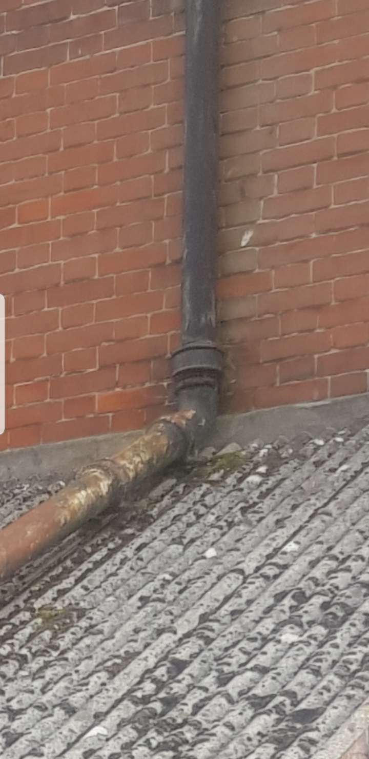

I have an existing soil stack which I can't get lead flashing behind.
Any suggestions? See pic, the corrugated asbestos has now been replaced with slates.

If you can get some flashband behind it, bodge it for just that few inches. Use primer and a heat gun to get it to stick to the wall.

thats gonna be fun to reach
