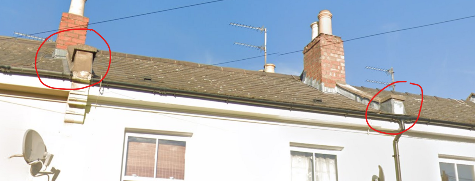

Is flashing still required on this section of the roof? I've noticed a lot of homes don't seem to have flashing covering the face of these ledge. Left side has no flashing, right side does...
Different methods used to weather it, the left one has a lead apron, bead and render.

To answer your question: The flashed parapet on the RH is the way to go - sheet lead flashing is far better than render.
Plus the roofers have used best practice individual soakers for the roof covering abutment on the RH side.

Poster #2 says there's a bead - no there's not, there's no "bead" present - the render on the left hand parapet has a Bell Cast.
We dont know if any cover flashing is present under the Bell Cast render?
Anyway, its bad practice to render over lead flashings.
He also says that: "the one on the left has a lead apron" - no it doesn't.

claims that "Lead sheet covering the slates, up the wall and under the render" - its called a parapet not a "wall" - the "slates" should have individual soakers not lengths of flashing.
********deleted "The flashing will run under the render" at the front face of the parapet corbelled projection - No it wont, why would you render over a lead flashing? All that can be seen is failing render.
