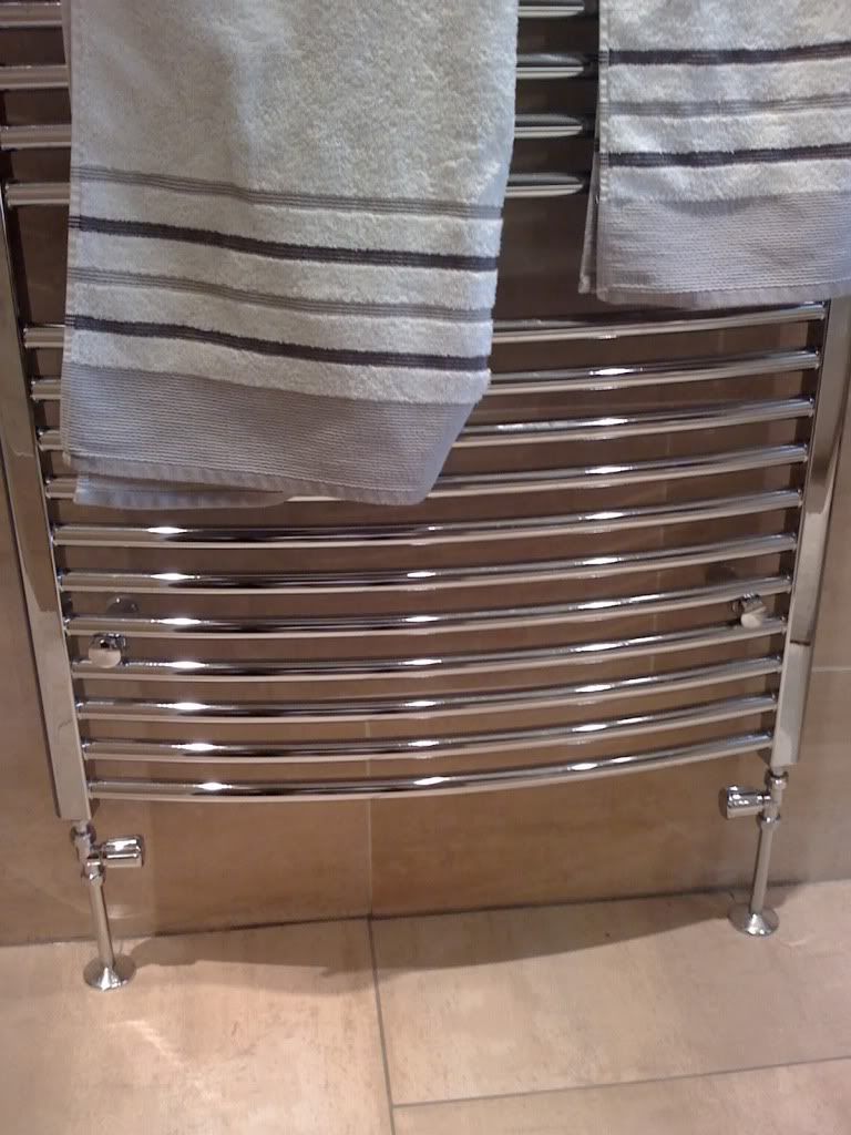

l have a bathroom radiator which l would like to replace with a flat ladder radiator, the flat ladder radiator is smaller in width and am l right in saying will need in-line valves.
The radiator l have on at the moment has angled valves and as the towel radiator is smaller how can l get any valves to fit it without having to move the pipes.
Is there anything l can attach to the angled valve that will connect to the ladder radiator.
If done properly then inline rad valves.
Not my choice but if you used angle rad valves to do what you want
you'll still need to alter the pipes at the top to fit the angled valve.
Do it once do it proper.
