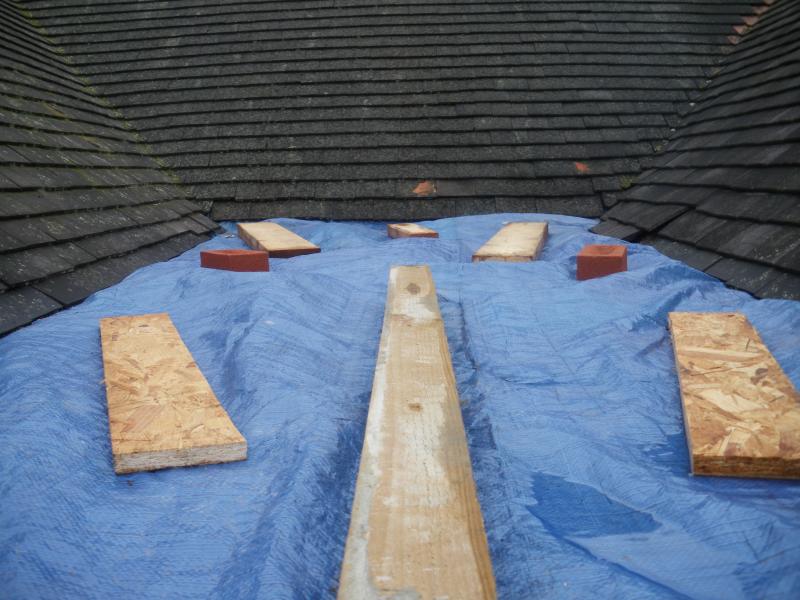

Hi all
Firstly thanks for any replies.
I am part way through extending my porch , all done via local B.C.O as part of a larger extension to our property.
I am moving my porch forward by some two metres between two hip bay roofs on a bungalow, by constructing a flat roof between the bays.
I have joisted across between two walls on the bays, and have firrings with the deck boarding on.
Now the next stage, weather allowing, is to remove the bay roof tiles around the area, as i believe i have to provide some additional boarding up the hip bay rafters to accomodate the felting across the flat roof.
Can someone enlighten me as to how far up the rafters i need to go from the flat roof decking, and what is a sensible thickness marine ply to use for this purpose ( or am i barking up the wrong tree even).
The ply on the decking is 20mm, but this would be too thick to go up the rafters, so i was thinking about 9mm?
Any guidance appreciated, many thanks
Tufty
9mm sounds a bit floppy to me, 12mm might be better.
As far as taking up under the tiles is concerned, you need to take it the equivalent of 150mm vertically, as an example if the pitch of the tiled slopes is 35 degrees you need to take it a minimum of 260mm up the slope

First strip off enough tiles so that you can work without interference form overhanging tiles.
You will need to cut the ply layboard (use 18mm) so that you end up with the board tucking up to the last available roofing batten. This will mean shaping the ply cut so that it gets wider as the firings fall towards the low end of the slope.
This will mean showing a bit more flat roof at the low end than the high end.
Obviously across the slope at the back it will be a straight piece.
You will also need to shape the the layboard as it meets the valley.
You will also need to fix a piece of cocking fillet along the layboard so that the eaves tile has something to sit on. It is important that this cocking fillet is covered with the flat roofing material to stop it rotting.
You will need to extend the roofing membrane so that it lips over the cocking fillet as you would a fascia eaves detail.
Also, if your roof previously relied upon fascia vents at the eaves detail you will need to insert roof tile vents as the flat roof layboard detailing has removed this option.

Sorry guys, i know i keep asking but after fitting the ply up the rafters do i need to re batten across for the tiles to hang too, only its in my mind that should any water get behind the tiles onto the sarking any battens across the ply will stop any water running down the roof pitch.
Thanks for being patient with me !
You don't fit any tiles or battens to the ply lay board. The ply lay board finishes at the last available tile batten. You then position the cocking fillet so that it acts as a kicker for the last course of tiles.
The sarking membrane then drapes over the cocking fillet as will the bottom course of tiles so that any water finding itself on the membrane is discharged onto the flat roof.
The flat roof material is fitted up and over the cocking fillet so that the tiles, sarking membrane and flat roof material all have adequate lap.
think about it.......you can only fix the lay board up to the bottom roofing batten (tile lathe) wherever you decide it will be.
