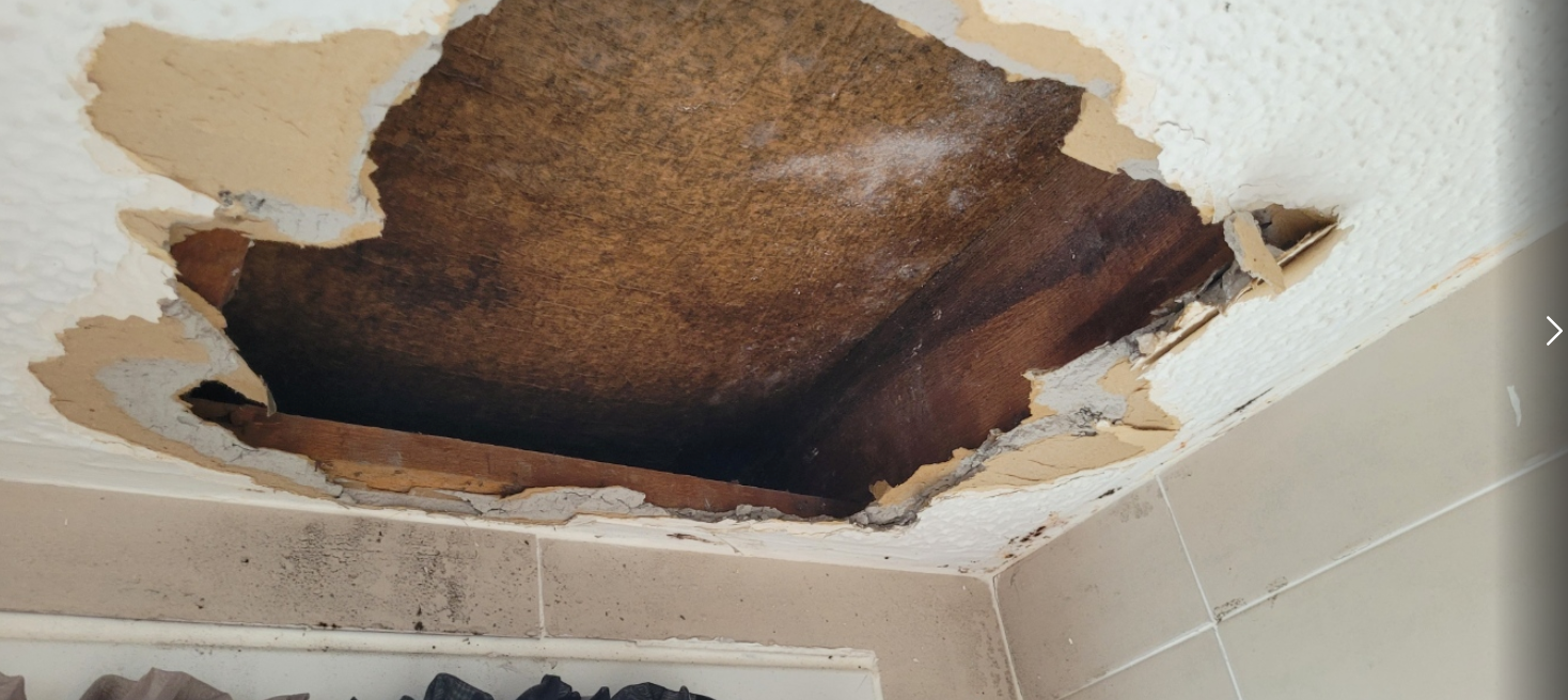

We had a leak coming in our bathroom that sits inside the rear dormer under a flat roof the roof, felt has been replaced & leak was sorted.
I now need to replace the bathroom ceiling, it's a small room 2x2.5 m, if it was a bigger room I would get a contractor in. I would like to improve the insulation.

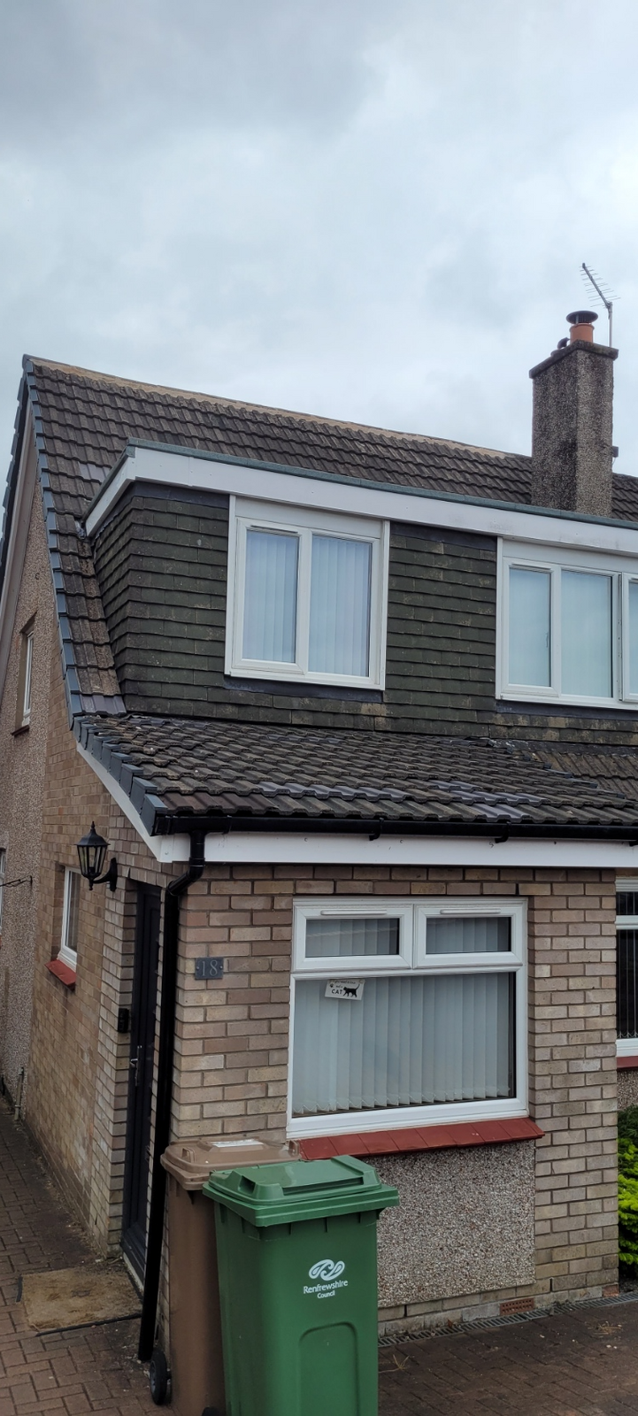

The house is late 60s to early 70s, Chalet style semi-detached with full length from and rear dormers. About half of the ceiling of the upstairs rooms 3 x bedrooms and a bathroom is under the flat roof, the rest is under the loft space.

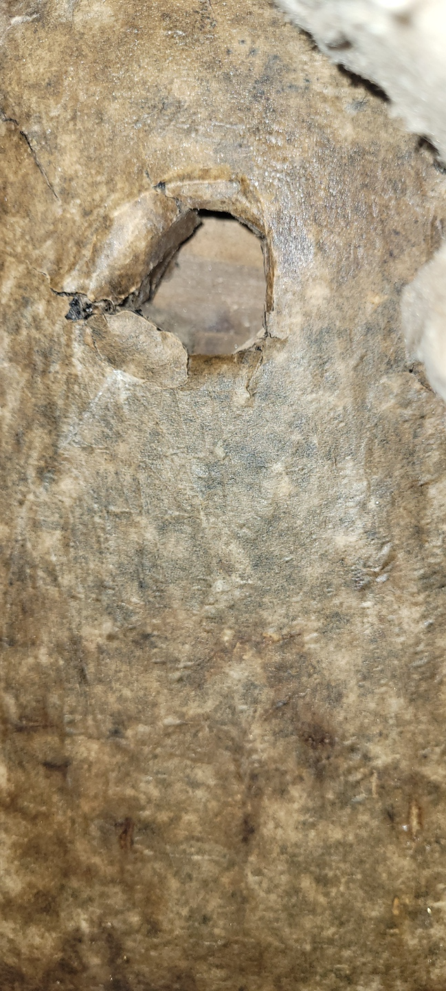

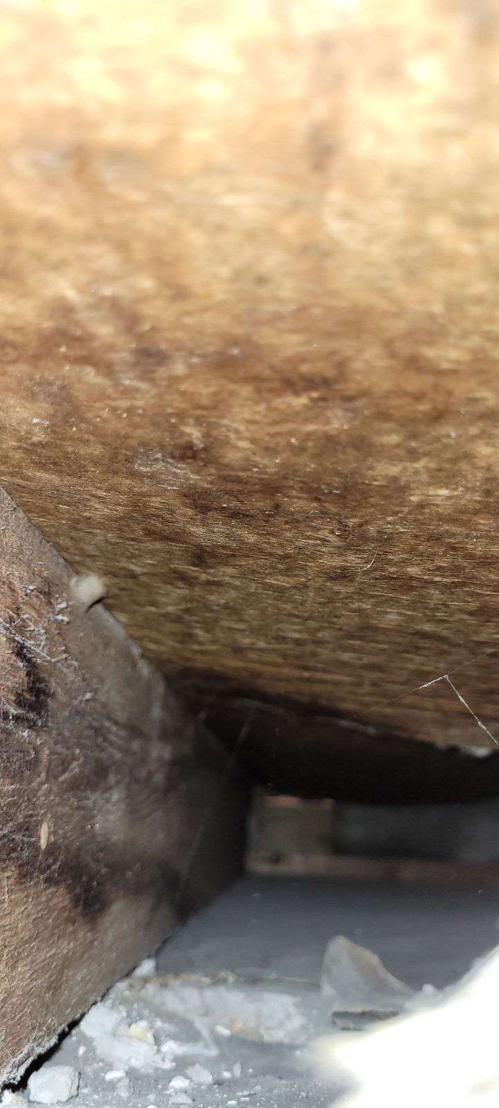

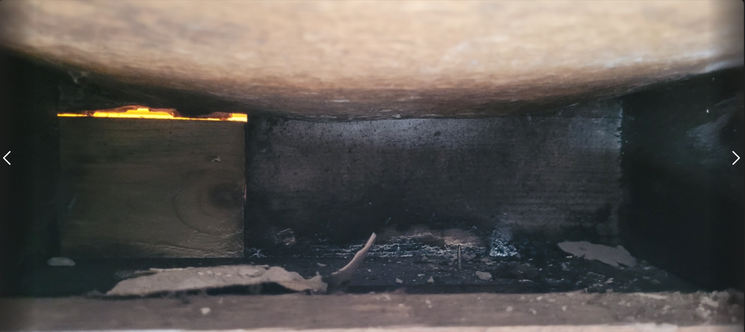

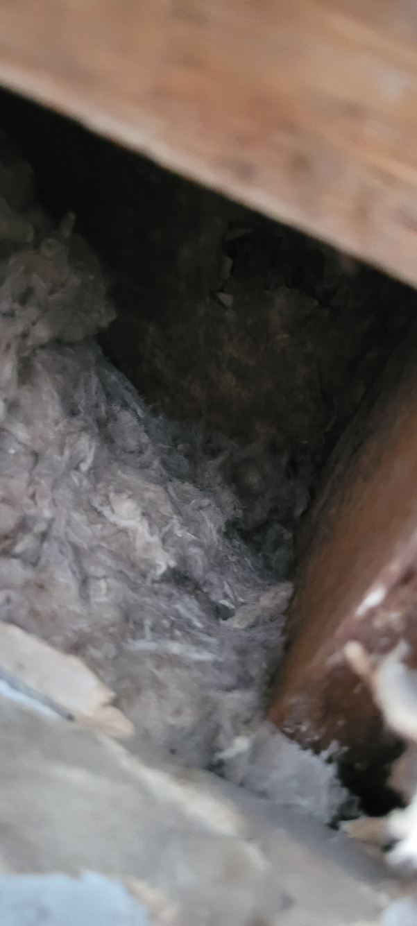

Above the bathroom ceiling, there is an empty 120mm void between the joists/rafters. Above the joists, there is a layer of fibre insulation (1-2 cm thick) encased in weed-control-type material or maybe its vapour barrier. Directly above this is the flat roof deck. There are no obvious vents.
Can I fill this 120mm void ( leaving now empty space) between the ceiling and the 1-2 cm thick insulation under the deck with insulation boards then fit the new plasterboard?
Should I fit external vents and use 70mm of insulation board, leaving a 50mm void that can vent into loft space, then replace the plasterboard?

Thanks for the replies. An insulation supply company has advised that this is a cold roof due to the insulation being under the flat roof. The current insulation that is at the top of the void, under the deck is 1-2cm thick, its a hemp roll, not a board. The advice I got was to remove the current insulation then fit foil-backed PIR above the ceiling leaving a 50mm gap/void to the deck and to add ventilation to the external.
If I remove the old insulation that would leave a void of 130mm. So 80 mm PIR board would leave the required 50mm. Then I could fit a PIR-backed plasterboard to replace the ceiling.
The above is kinda in line with what Bonni advised. or could I do what Alastairreid suggested (this was what I was originally thinking) and fill the new void with 130mm foil-backed PIR board?
Just not convinced that insulating from below makes this a warm-roof design as most of what I read says that warm roof insulation needs to be above the deck, not below.
