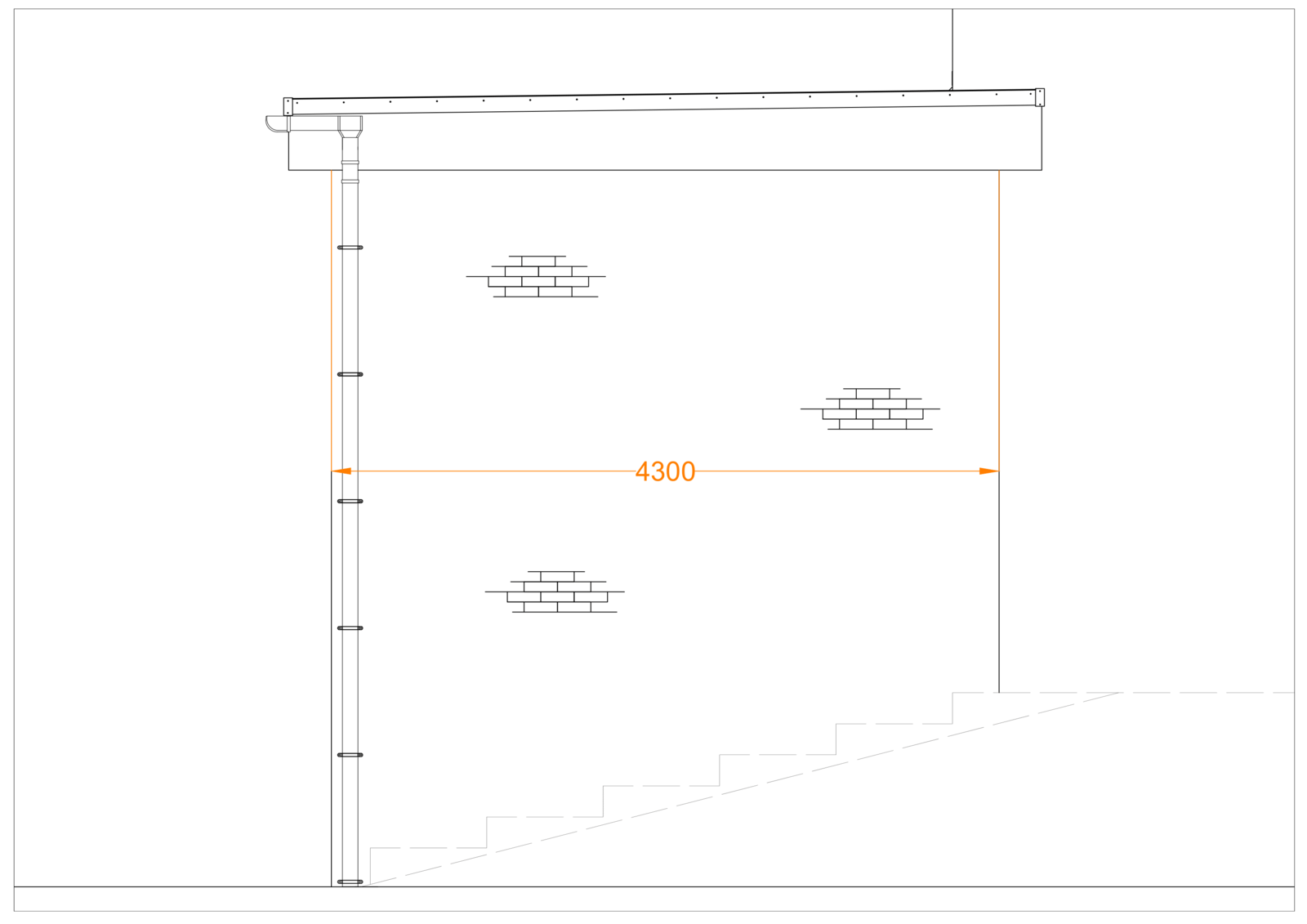

Hi, all
Side elevation
Rear elevation
I have drawn the Fascia board on the Flat Roof level all around. Is this correct?
Also most Flat roofs I see don't have an overhang.
I have a 250mm overhang, is this ok? Are there restrictions to having one?
Does my kerb edge trim and guttering plan seem feasible?

Various things wrong , get somebody to draw some proper architectural working drawings.
I don't think the drawings are that bad.
A few things.
Be aware that that monster fascia depth is going to look even worse in real life. It could be designed out and look more pleasing
The section is wrong. You have sectioned the roof and the main house, and that's wrong and confusing - you are showing the roof over-hanging into the kitchen.
The insulated soffit has been discussed previously
The window head needs to align with the existing door head. Also, it's actually at a different height on the elevation and section
Overhanging soffits are good as they protect the walls below. It's a design choice, but yours are OK
Something about the proportions do not seem correct. It does not look 4.3m and 5m wide and then 4.6m high

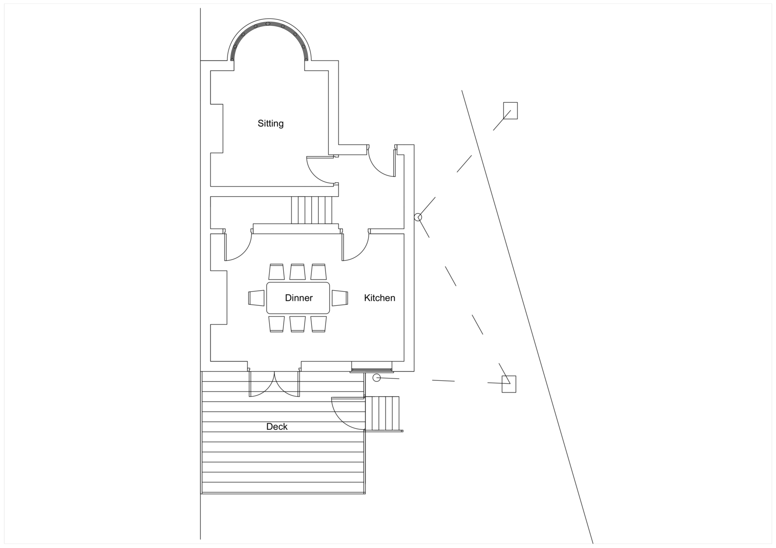

Existing Ground Floor Plan

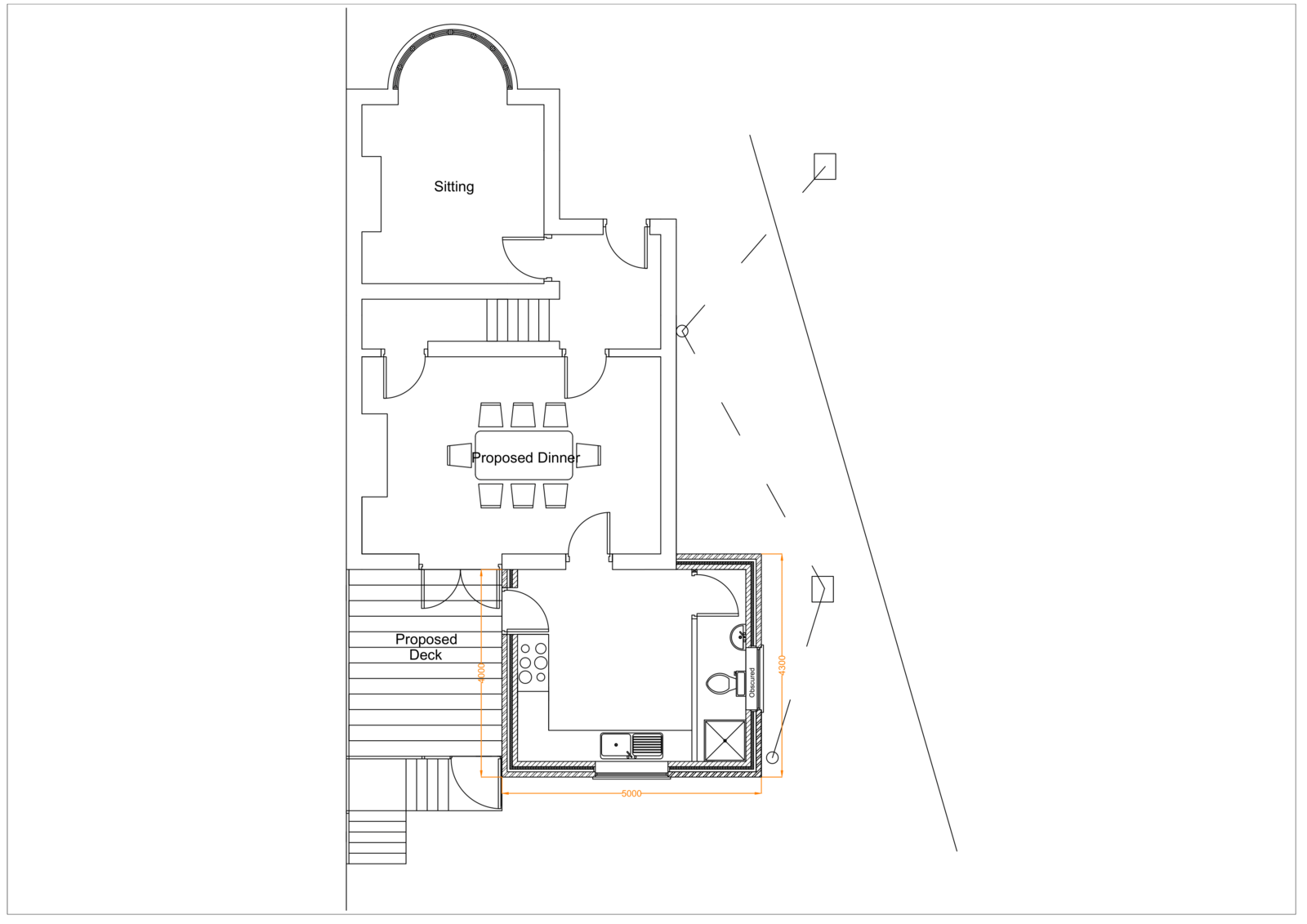

Proposed Ground Floor Plan
If i'm under standing you comment correctly, the reason I have sectioned the roof is to make the inside of the Proposed Kitchen flush from the existing outer leaf to the new inner leaf blocks.
Do you mean align the window to to this red line?
Not sure, everything is drawn in model space 1:1 scale.
No the drawing is wrong. A section cut would never cut the roof like that and the main house wall. It's one or the other. Draw the section cut line on the plan and see .

incorrect building construction details such as no insulated cavity closers, door and window frame positions wrong in relation to vertical dpc, rwp with right angle bend,too many rwp and gutter clips ,2m high void ?,heights on section don't appear to correspond with heights on elevations,scale should correspond with figured dimensions,no guarding to stairs,guarding to deck appears too low.
-- on plan -hob next to door ,should be some workspace both sides of hob,door swing into shower room wrong- traps you in corner,how do you walk past wc - no space in front of wc ,pitch of stairs appears too steep ,tread and riser proportions !
door swing out on to landing space unacceptable, is it a rwp or svp on plan? one pipe connects to 2 inspection chambers or drain runs from manhole to pipe and out again to another inspection chamber ! new extension will require a rwp and svp , both can't connect to same drain unless it is a combined drainage system, double doors from ding opening out over new external door to kitchen not ideal, window position in wall on plan doesn't correspond with section and both wrong in relation to vertical dpc , new stairs elevation doesn't correspond with plan .Other things as mentioned by others already.

ps 'Not sure, everything is drawn in model space 1:1 scale' - that is why proportions should be correct if information entered properly.
'If i'm under standing you comment correctly, the reason I have sectioned the roof is to make the inside of the Proposed Kitchen flush from the existing outer leaf to the new inner leaf blocks' - the drawing requires one section of the new extension through the existing rear wall of the existing house and one section through the rear wall of the new extension.
