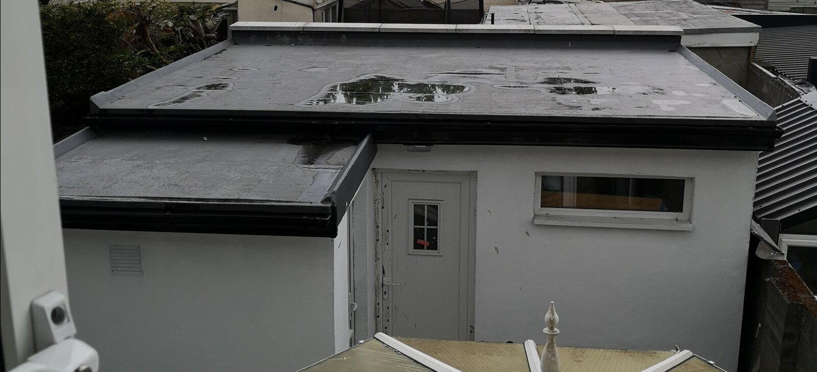

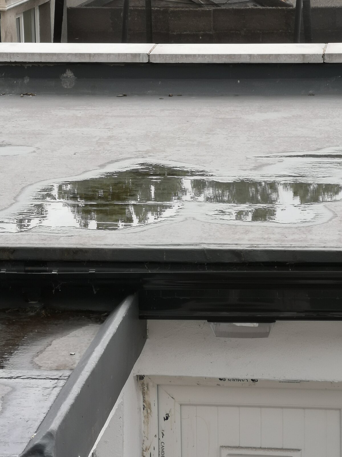

Hi All,
This out building is 2 years old.
As far as I know it's fiber glass, gets very soft in the sun.. But main question is, should I be concerned about the puddles.
The builder was requested to have an angle for run off, but I think it's 100% flat.
Thanks in advance.

Strange why he didn't have a fall on that although puddling on flt roofs is common and normal. As long as your roof coverings isn't compromised then you won't have any issues.

it looks like the fibreglass mat and or resin has got a bit thicker near the gutter and causing a bit of rain to pond -theres nothing to worry about, the puddle looks only to be a few mms deep
